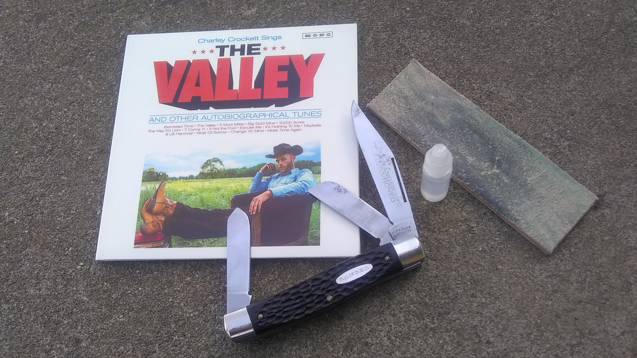

I meant the sheep foot on the same end as the clip blade and Spey by itself.
The springs act as a spacer as well as a spring. Putting the sheepsfoot in the middle and pivoting at the same end as the clip blade would put two spacer ends adjacent to each other, and that won't work.
Bert
Flipping the position of the secondary blades is not really viable with a three spring design. The sheepsfoot is wider than the spey and must be the middle blade, otherwise the spey blade is not accessible. Take a look at a knife that was incorrectly assemble with the spey blade in the middle.
Bert
Put the nick on the other side of one of the blades and the clip could go in the middle.
Do you have a three spring with the main blade and the sheepsfoot blade that pivot from the same end? With a three spring construction each spring has a pivot end and a spacer end, and two spacer ends can't be next to each other.
I have one and just got another today.
And my other ranger stockman, great working knives more solid than the shell construction colonial is known for.
