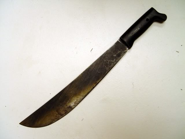

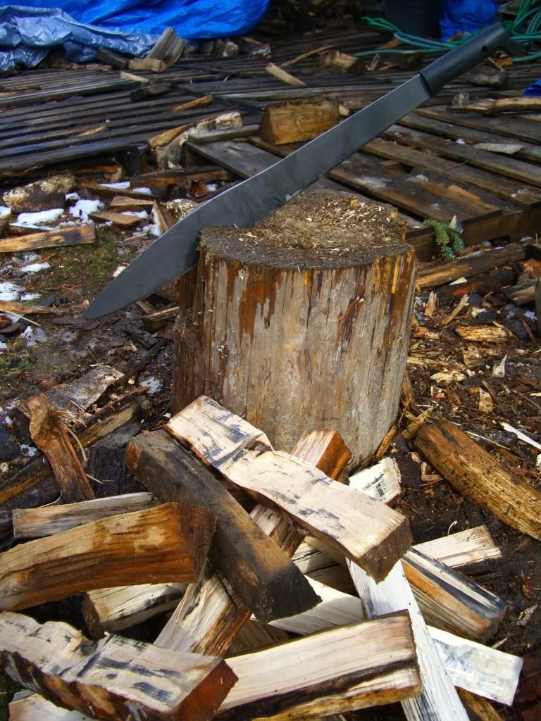

Here's a photograph of the Imacasa colima machete that I reviewed a while back--but with a new friction reducing coating applied.
As we all know well, if the blade encounters less friction as it passes through a material, less energy is lost and the blade is free to penetrate deeper--and with less exertion--during a cut.
Test slices on cardboard have so far revealed VERY positive results, and left the area of the blade that passed through the material with more of a silvery-gray look rather than the matte black that you see here. I buffed it firmly with a paper towel and it developed a look nearly like a shiny patina, though closer examination reveals that you're looking at the coating and not the metal underneath.
Depending on the results of further testing I may apply this coating to a chopper project I'm working on that's destined for the exchange forum. It could be a nice finishing touch to something already unique! :cool::thumbup:

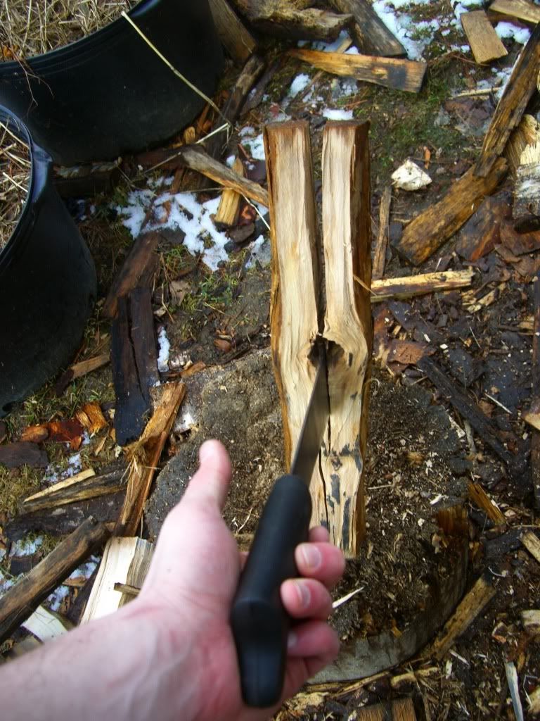

Took it outside to test out today and it held up great, as well as providing a noticeable degree of improvement penetrating during the cut. It was also easier to withdraw the blade after sinking it into the wood.

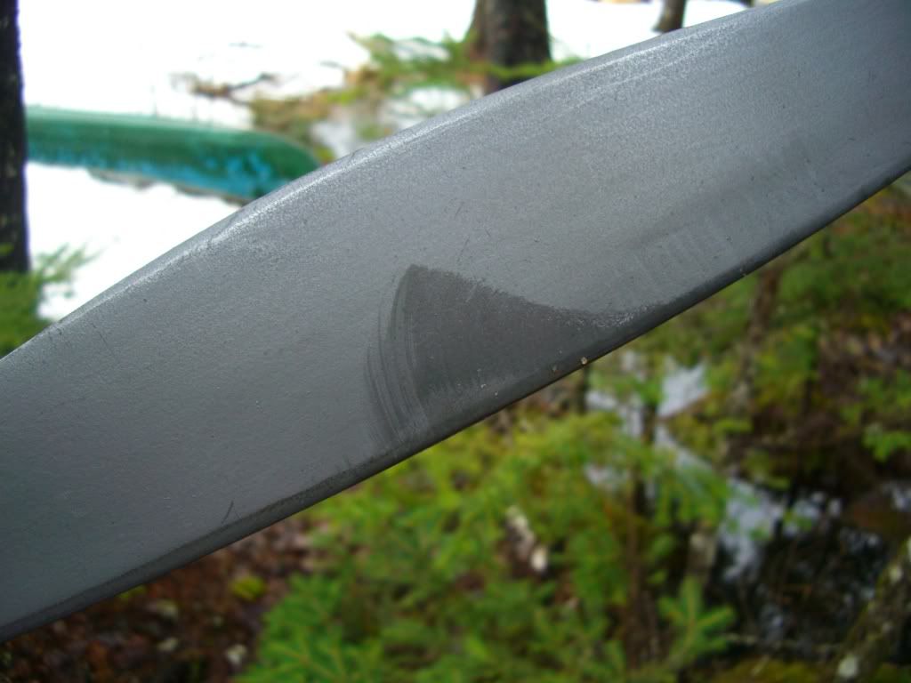

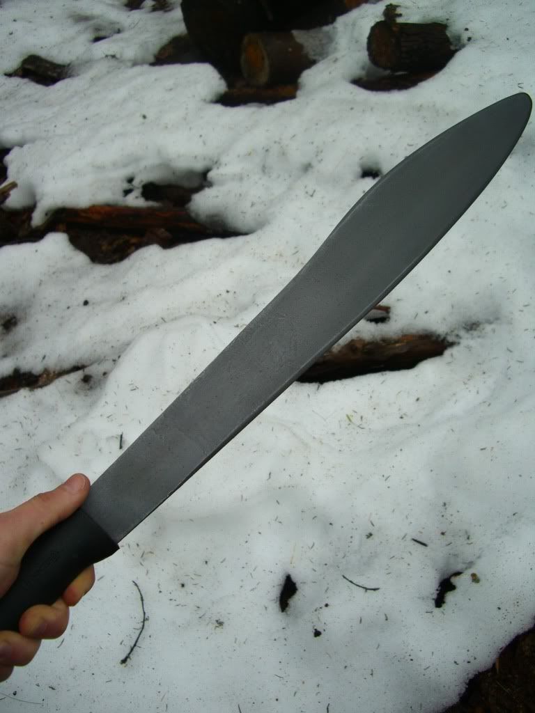

A close up shot of the coating. It's not a great photo, though--it's a bit more silvery in person.
In hand--you can see the silver-gray color better here.

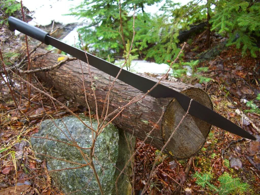

BLAM! :D
The blade after withdrawing it. The log was a little damp from the rain, so it got the blade wet where the strike occurred.
Here's the impact zone with the water wiped away. The coating held up as well, even on the very edge.
And again--but this time not into the end-grain of a dead log. This one was dead and dry. Excellent depth to the cut and it was quite effortless. ;)
The cut with the machete removed. For some reason this picture makes the trunk look a bit smaller than it actually was, but it was the best one I got--it started raining pretty hard and I had to run inside!

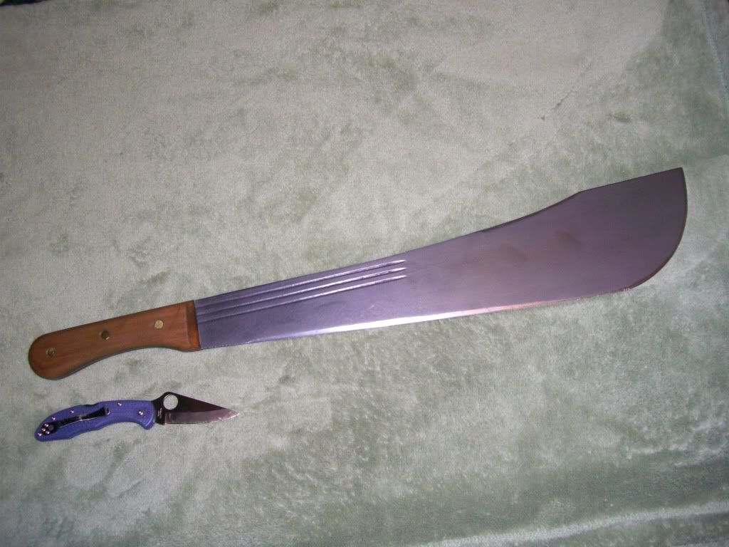

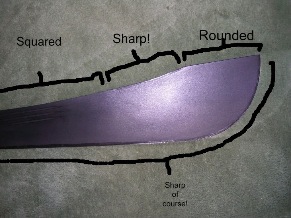

FYI I just posted this bad boy up in the exchange forum. It's a heavily modified Imacasa Rozador, and I think you'll like what I did to it.
Original:
yhst-29358752693524_2094_845010
Now:
I have more pics up in the exchange thread, and will add more (better) ones as soon as I can.

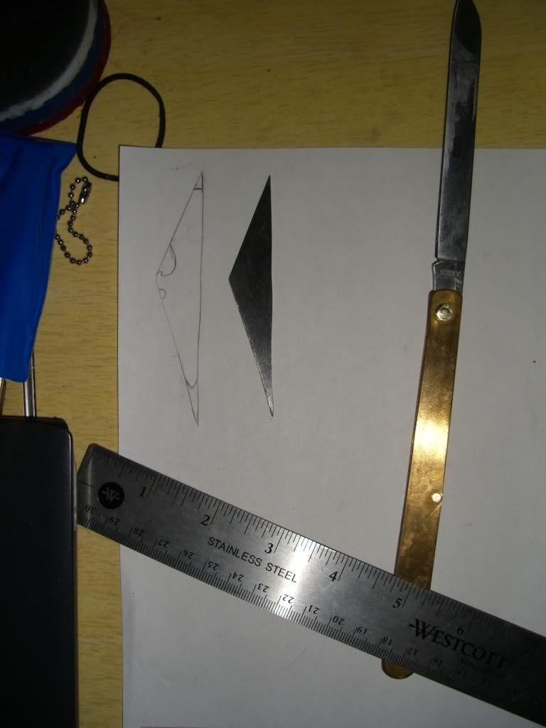

Oh, and here's the piece I chopped off the tip. It's good steel so I'm thinking of making a little key chain tool out of it! Here's one potential idea--bottle opener with wire stripper (based on the Victorinox style of course) flat head screwdriver on one end and a half-phillips on the other. The spine will be squared for use as a scraper. Thoughts? :)
instead of the round notch wire stripper, I'd go with a sharpened V.

That seems a bit thin. Mine is 2.75 thick. Do you have any problem with it feeling "flappy" when swung or impacting the target? Looks like a great design for actual jungle use, with the back swing being able to cut as well.
Bear in mind that I modified the blade shape a little, so if you wanted to do one yourself just be prepared to do the same. :) No problem at ALL with flexion. It's actually quite a stiff machete (though it will flex as it should under impact).There's a nice taper to the blade, too, which makes it feel very "alive" in the hand.

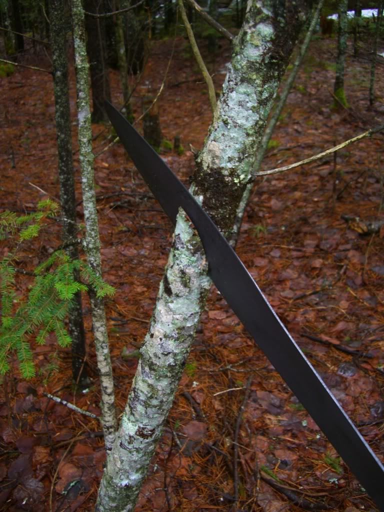

And as promised here are a bunch of pics of me beating the snot out of my Colima. :D

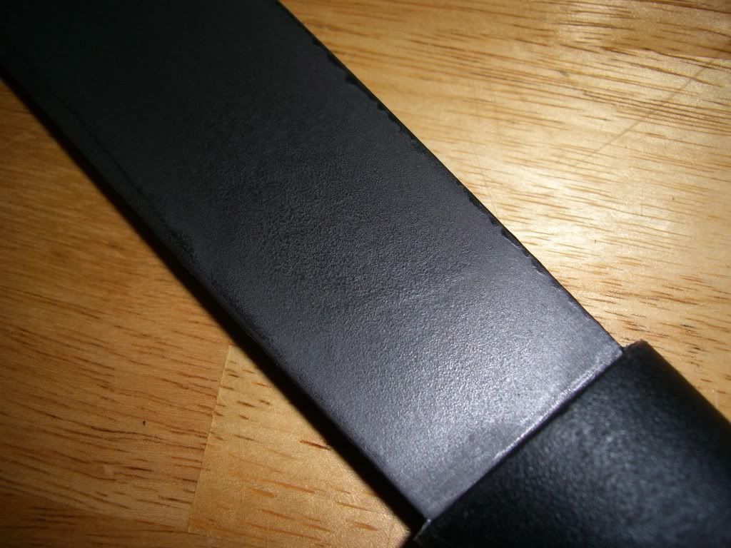

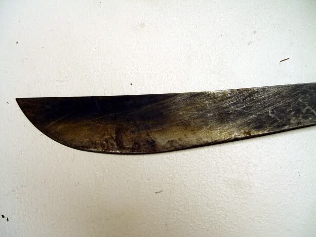

This is what is left of a machete that I completely stripped and then coated with truckbed liner in ultra fine coats to make sure that the texture was smooth. I used a belt sander and aircraft stripper to take the coat down to shiny metal, then used rubbing alcohol to treat it and clean it.
Its held for about a year, and has done some rust prevention, but thats about it. As far as cutting better than a mirror polish...I'll have to see it to believe it. What else do they use the paint for?
The Slip-Plate functions as a friction reducer by virtue of the graphite in it, not as a result of the surface finish it leaves. I can understand why truck bed liner wouldn't do a whole bunch besides corrosion resistance. From my tests so far it definitely works better than a mirror finish, though a mirror finish is of course more durable over time. :)
