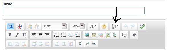

Here's the button to add an attachment when making a post.

Registered users can't use the attachment features. His best bet is a service like photobucket or simply take OldPhysics up on his offer.
