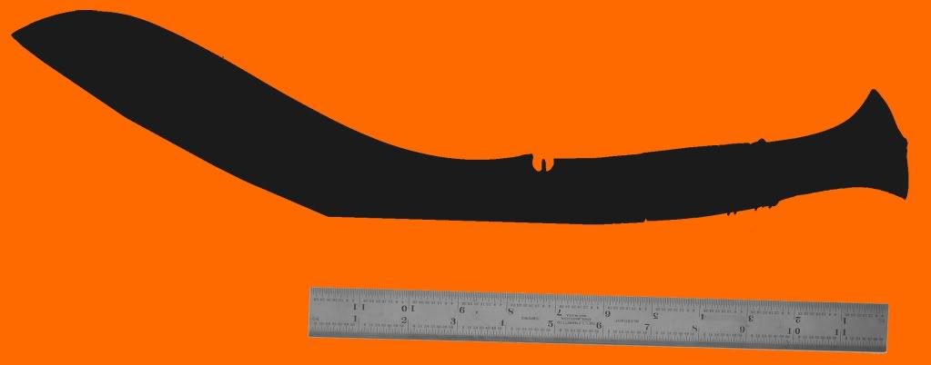

Nice Hepkat, thanks for posting. Can you import shapes into your program? If so here's a picture optimized to define the shape of the Khukuri. I wonder if the angle of the blade affects the stress pattern. Also, maybe I don't understand exactly you did to simulate impact, but 0.1in deflection seems more than the blade would deflect - but maybe you just added the deflection to simulate the force of impact...also isn't 340 lbf fairly low. I could be way off but I think the force of the blade hitting wood would be in the tens of thousands lbf.

Measurements of this particular khuk:
Spine thickness = 7/16in
OAL = 18in
Handle (Tang) = 6in
Blade width ranges from 1 5/16 to 1 15/16

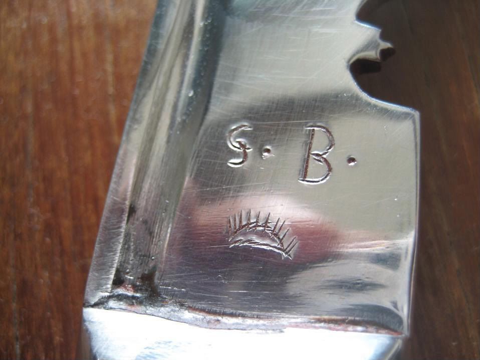

Can you get photos of this?
Hi Howard,
Notice the tiny cracks developed along both sides, before merging into the cho?
I was thinking of rounding it off but will leave as it is for now.
the 'cho', 'kaura' or 'kaudi' is usually thought of as a cow's hoof-print partially across the blade, cows being sacred in hindu. the 'vee is thus actually the space between the cows toes. some have this shape as more of a pagoda, or other shapes like a fleur-delee. they are either cut or punched, but if done improperly can have a very acute (sharp) inside angle which is indeed a crack inducing stress raiser. if you have one like that a small jeweler's round file can be used to radius & round off that sharp corner. the closed cho of course doesn't have that problem, so should be the best stress reducer. sharp OUTSIDE corners like the point of the Vee are NOT a stress raiser and are not a problem.
if the punching or cutting of the cho causes stress cracks, as above, they also can be filed back to good metal. in the above photo, the rounded corners of that 'pagoda' shaped on would have been perfect, except for those tiny cracks.
