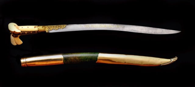

It may related to a type of sword Yatagan
Because some sources mention that it sometimes called Yatagan clip.The Yatagan features a recurve Blade.But it is weird to call it Turkish clip blade because 1. It is not a knife 2. It does not even clip point 3. "Yatagan has a Yatagan clip point" sounds weird[emoji23]
