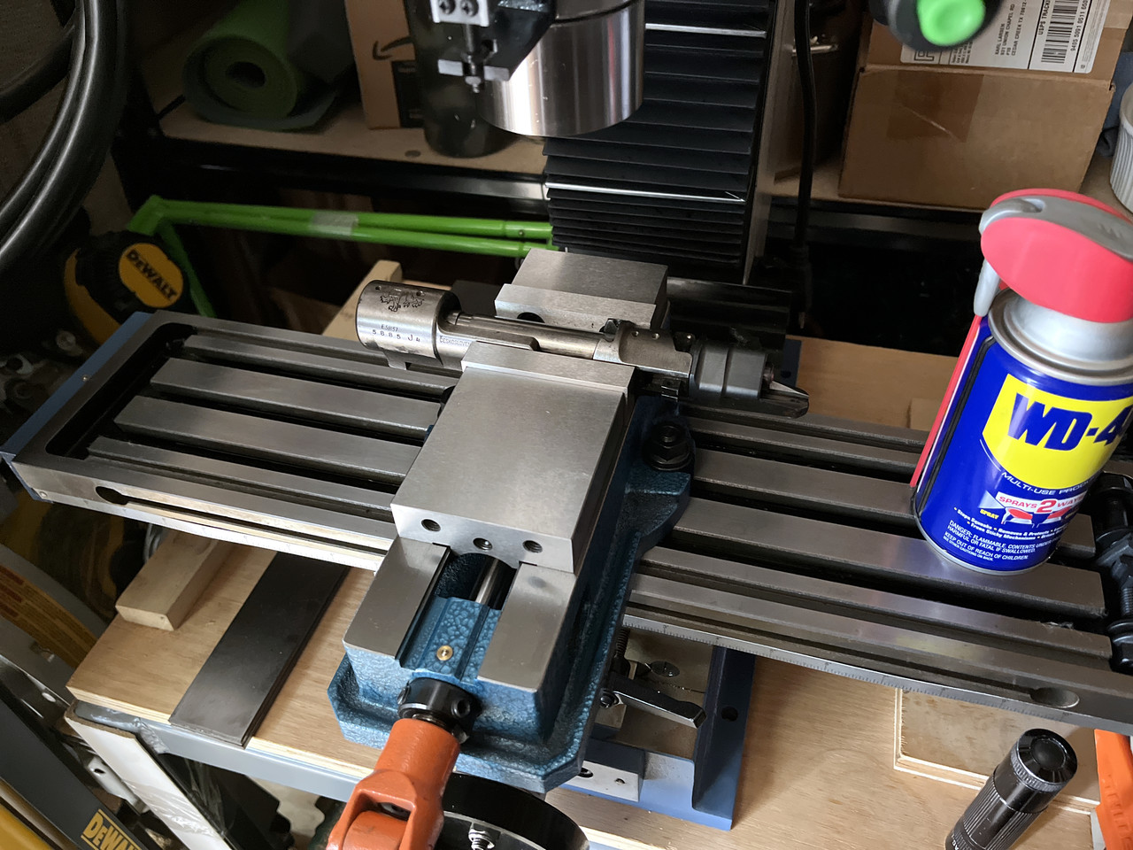

had a productive weekend in the shop, and was able to get the pallet out from under my machine, and place the unit near its final resting place. It wasn't pretty, but it was pretty stupid. Got the job done tho 🤷‍♂️
I have two of these steel plates. They are made for Park Tool bicycle workstands and weigh 70lbs each. One will be at either end of the stand I'm designing for the machine, and I'll be using some kind of dimensional lumber for in between. I'ma make sure I have a storage space in the stand for collets, cutting fluid and whatnot. Might drop by the local mill and see what the have for fir
