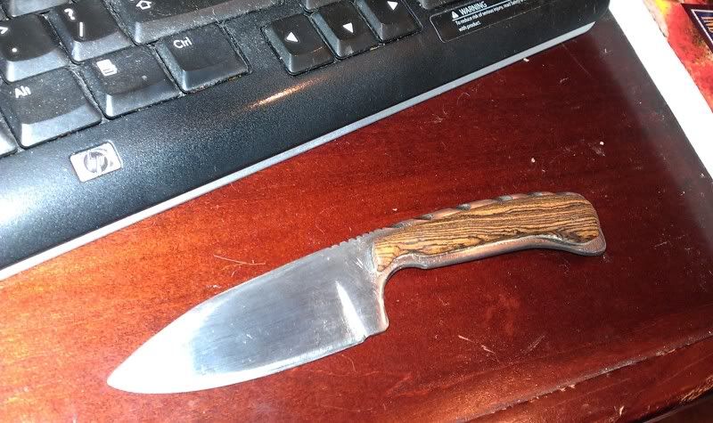

I haven't made my first ground blade out of good known steel yet. I have made about 8 knives from premade blanks. I did make 2 profiled and ground knives out in the Auto Shop at Sears last fall/winter during our down time. Just to see what I could do and to get some basics down for the process.
Both of these knives were made from unknown steel. The first, from a piece of stock that had been wedged into the wall for probably the last 10 years. I drew out a design, cut it with an angle grinder and profiled on our bench grinder. I finished it out with a couple of files we had on hand and sandpaper. It has a swedge filed in and some quick filework to the spine. Once again, just practice and killing time :). Being that it was unknown steel, I had no idea how to do any heat treating so I heated it with a torch to non-magnetic and quenched it in a tub of used motor oil. I noticed it got quite a bit harder, and since it was just for fun and practice (mainly a time killer lol) I didn't do any tempering. I handled it with a piece of scrap Bocote that I had which was too small to do anything else with....and barely big enough for this knife. It's made a pretty neat letter opener thus far!

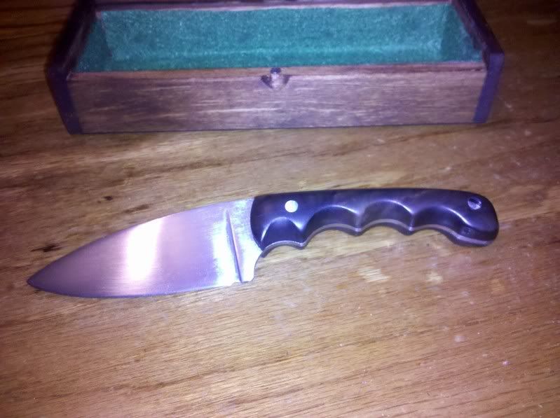

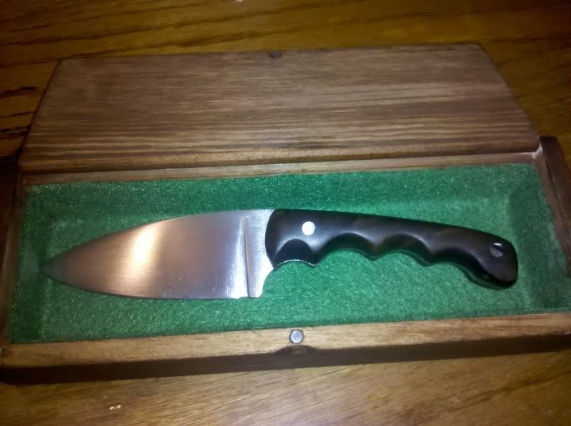

This other one was made at the same time. I needed a gift for my brother who is EXTREMELY hard to buy for...I had a couple ideas and then time ran out trying to order them in time for Christmas. So, I finished up this other blade I was playing with as a letter opener as well. It is handled with walnut burl from a tree cut from our granny's yard. It's not perfect, but it's the better of the 2 and wound up being a nice hand made gift along with the box it's in.
So, those are my first actual hand made knives. Would like to make my first out of GOOD steel soon, but I'm having fun doing the premade blades for now :).

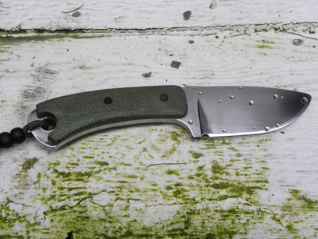

First knife on a belt grinder Craftsman 2 x42 , 1095 , 8" OAL I heat treated it myself too . It was made 3 months ago.

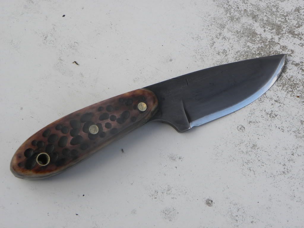

This was my first ever knife. It was done with a cordless drill, hacksaw and files. I cut the scales from one of my dogs bones and did the jigging and dying myself. They're installed over brass liners with brass pins. Didn't turn out very good but it did give me my the motivation to continue with it.
This is my second attempt. Again it was done with a cordless drill, hacksaw and files. Lot of errors, squared micarta scales with no contour, bad plunge.

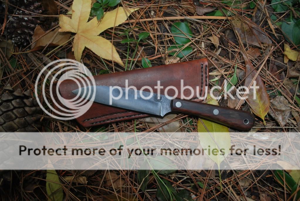

This was my first knife, I started it when I was 14, I softened a file, and filed it to shape, then when I was in college I heat treated it and finished it
Material: Nicholson file, brass hex stock, desert ironwood

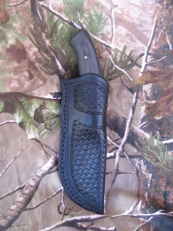

Rick, your leatherwork has improved substantially.

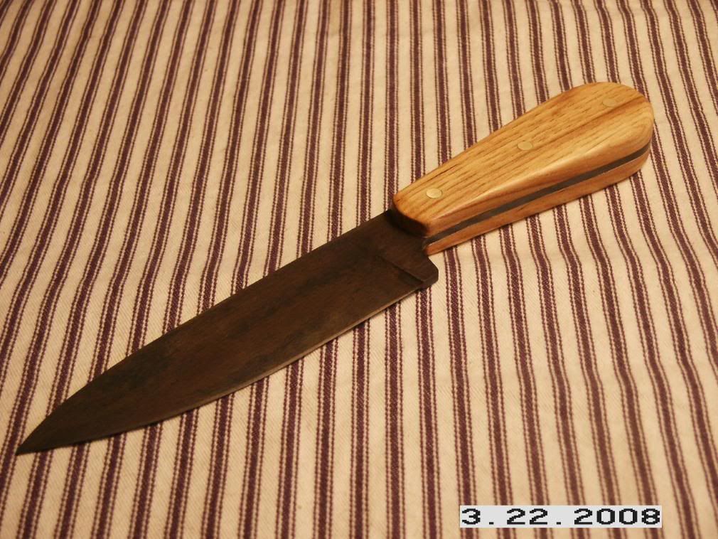

This is my first one. O1 and hickory. I made this one on my dining room table in our apartment when we were between houses back in 2008. My wife never said a word because she new I was going crazy in that apartment. I think I made my first 3, or 4 knives on that table. Man is it nice to have a shop to work in now! I left the heat treat scale on it cause I wanted and old look to it, plus I didn't know what the heck I was doing either. I do know the heat treat is correct because I did that at work and am very familiar with O1 heat treatment. What a fun ride it has been so far!

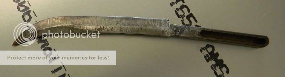

Oh... I'm going to regret posting this:
This was my first attempt, done about 18 years ago. Forged with an oxyacetylene out of "tool steel" and ground with an angle grinder. I never finished it.
