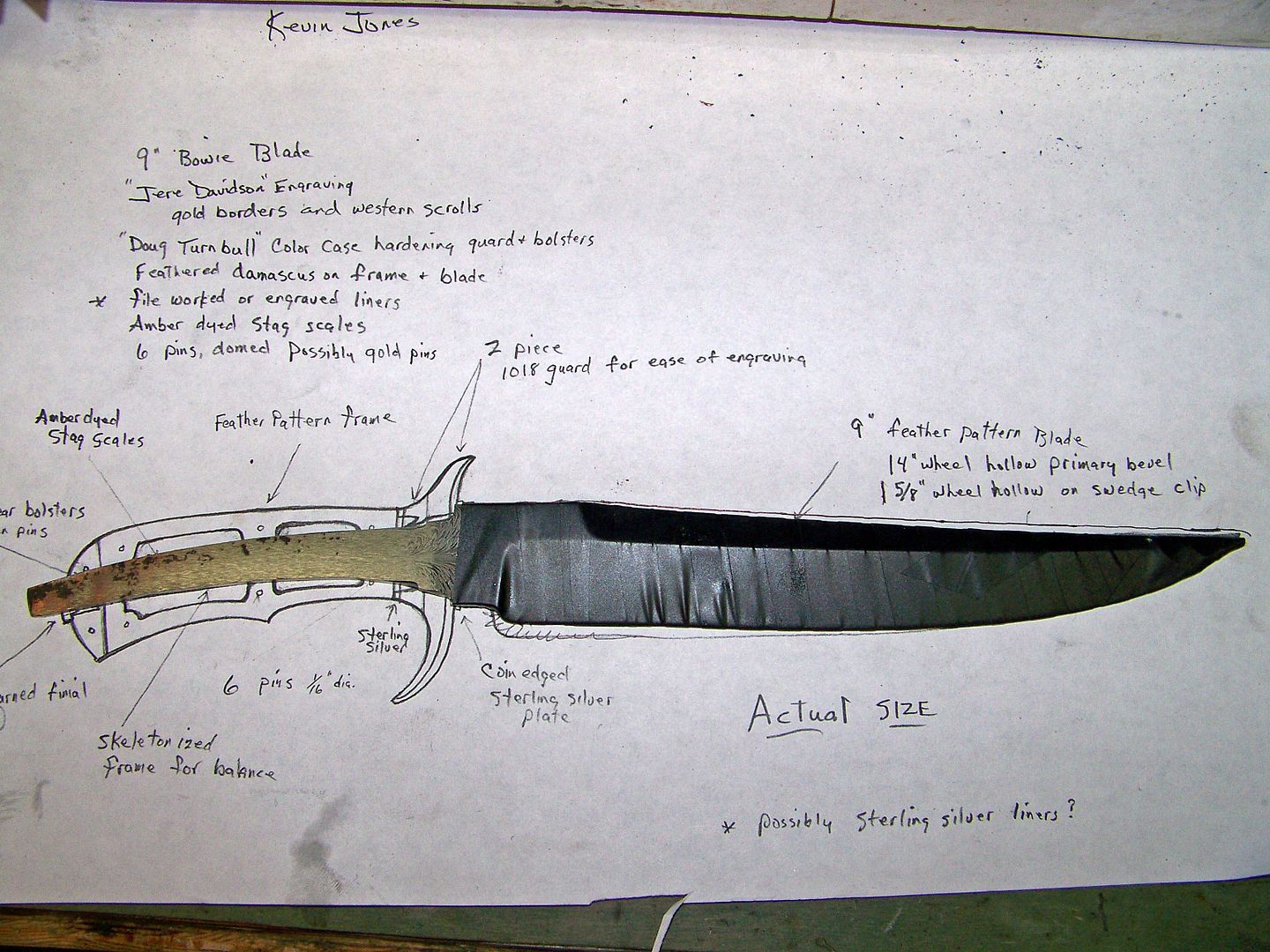

Here's a peak at what the finished Bowie will look like though we've made some subtle adjustments along the way.(these drawings have been reduced so not actual size)

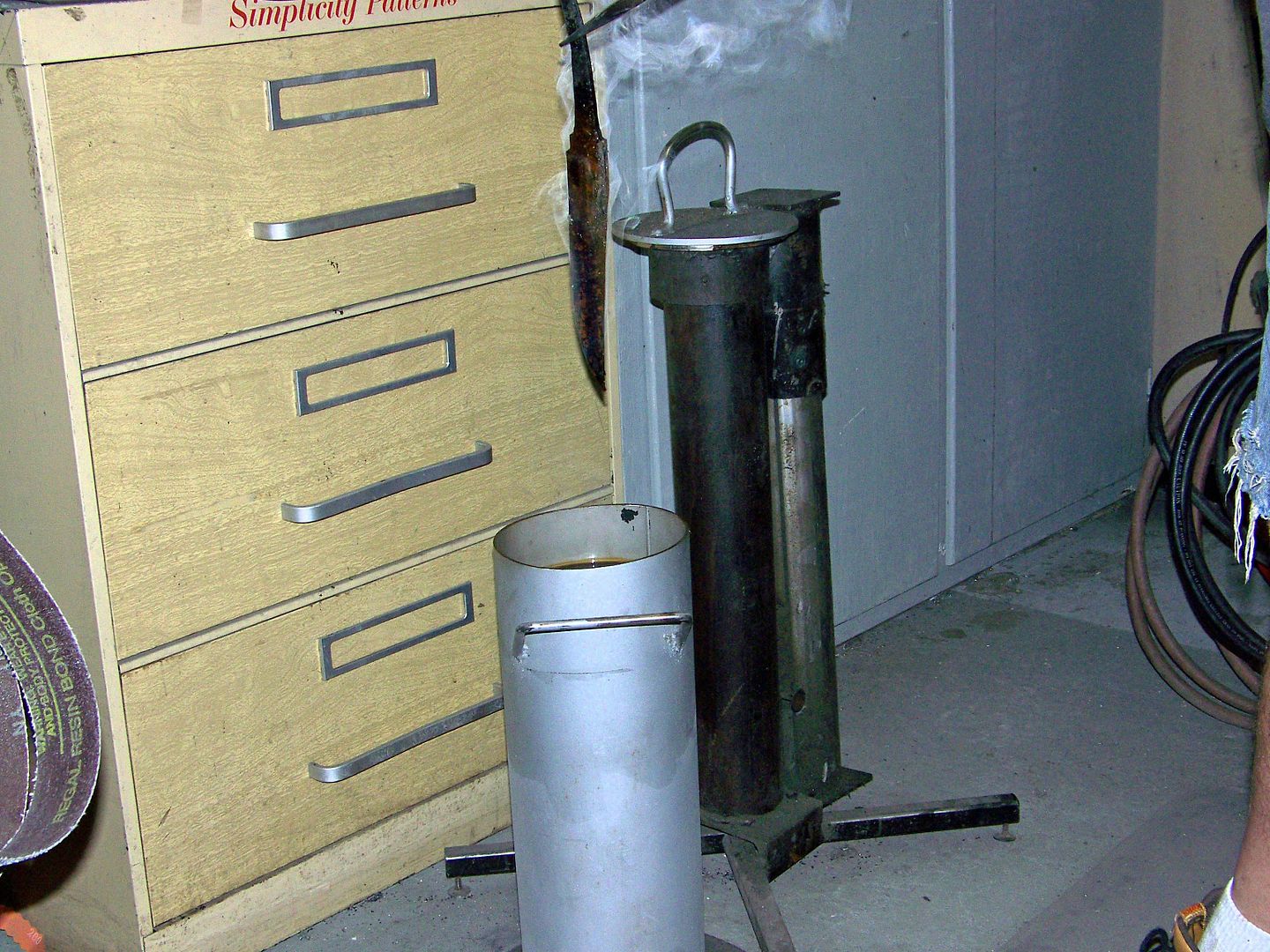

I heated the blade in my Even Heat electric digital oven to 700 degrees, removed them and sprinkled both with PBC anti-scale compound and put them back in, ramped up to 1500 deg. and let them soak for about 5 minutes. I took the bowie out first and quenched it point down into "Tough Quench" from Brownells. It gives consistant results and I've used it for years. Also quenched the dagger.
As usual the camera went off too late to see the austinizing color going into the quench. In a dark room its a thing of beauty. Anyway here it is still smoking from the quench.

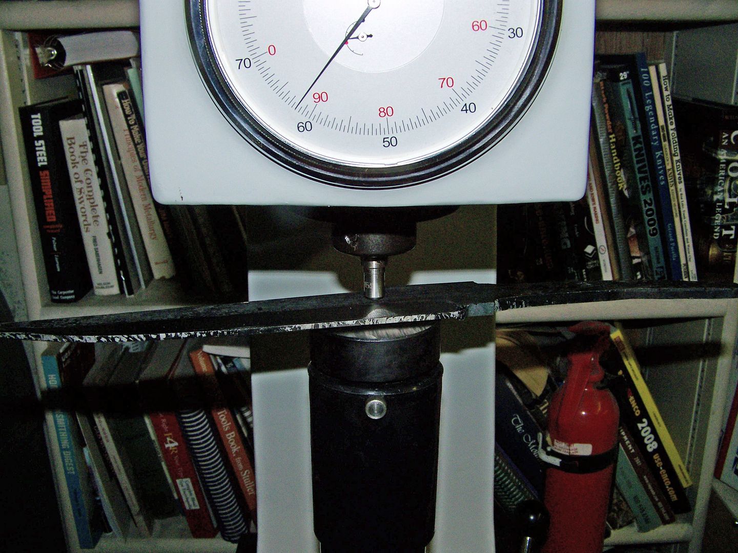

And here is the blade in my rockwell tester. It will tell me if the hardening process went right. Heat treating is a mysterious thing to me and I've never claimed to be an expert. In fact I bought this tester so I can be sure each blade is hardened and tempered to a given hardness. I tested it within 5 minutes after quenching it and the hardness was only 49 so I tested it again and again and each time it read about 5 points harder. As you can see its at 62 right now. That tells me it is good. Steel hardens for several minutes after the quench. Maybe I'm just easily entertained but that is amazing to me. This should tell you that you can straighten a blade from the quench if you are fast. If its still smoking you can put some really heavy gloves on and straighten one out by hand in a vice. This one didnt need it though because I normalized it, stress relieved, and annealed it. I also left it fat and will grind after the heat treating is done. If there is any amount of warp or bend I can grind it out. More on that later.

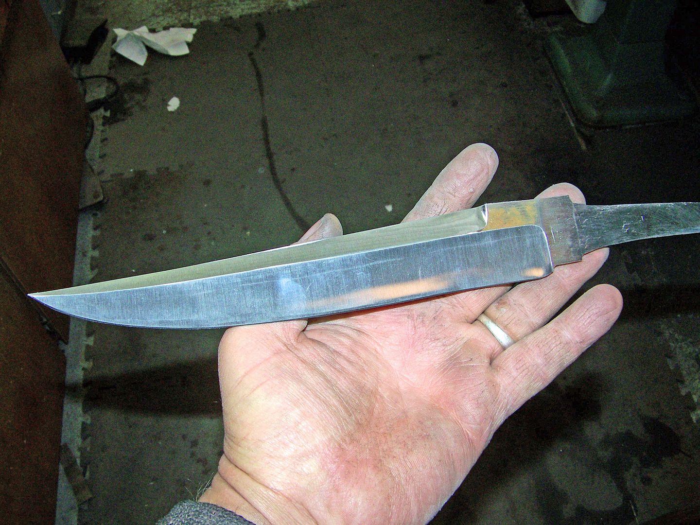

I tempered the blade at 395 degrees for one hour twice and checked the hardness. It read 57-58 rockwell hardness. Thats good.

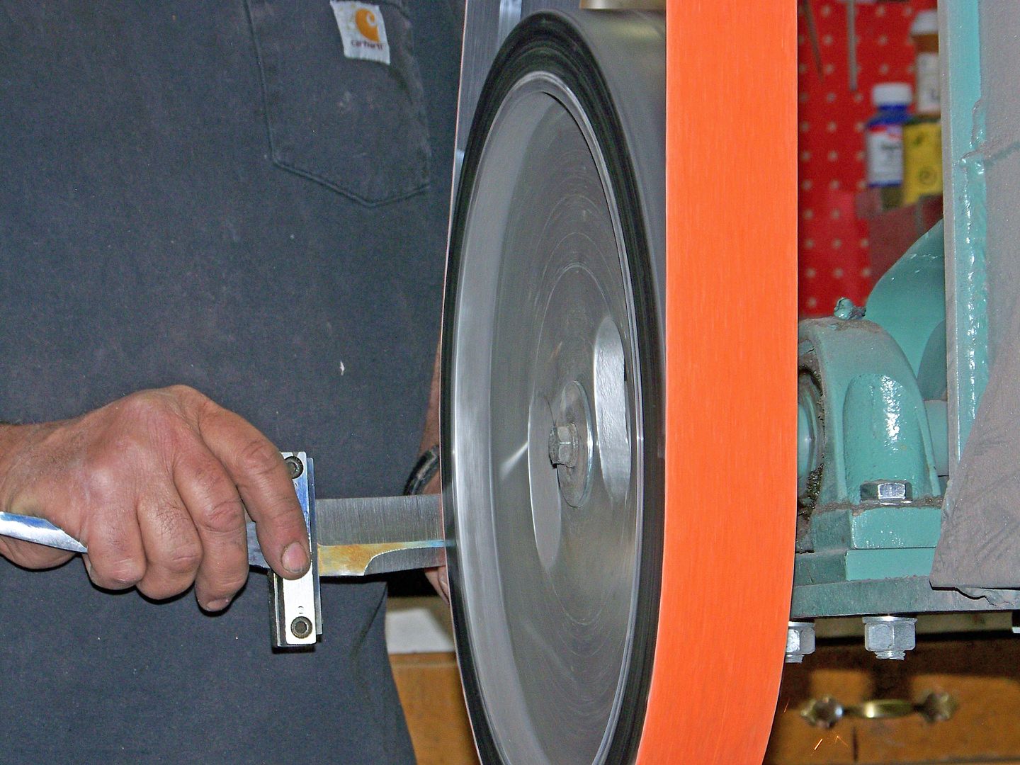

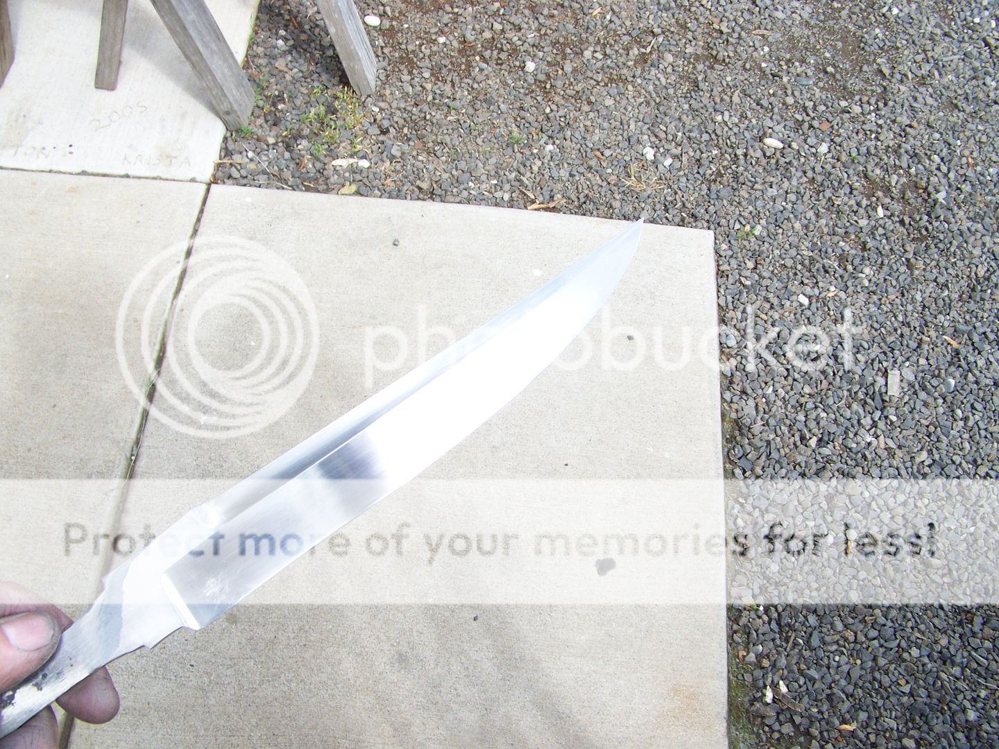

I hollow ground the primary bevels on the 14" wheel and the top clip on a 1.5" wheel. I have a 400 grit belt finish right now and will hand rub it out to 2000 grit before etching. This is a good blade after looking it over real well there are no cracks, voids, inclusions or any thing wrong. Whoo Hooo. :)
I wonder what the pattern looks like. I'm going to etch it tomorrow and we'll see.

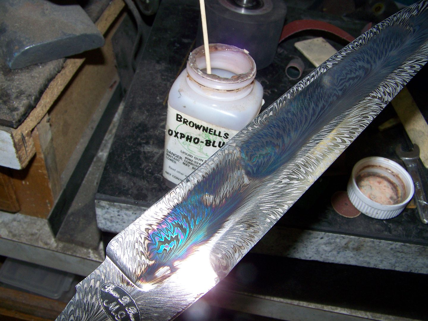

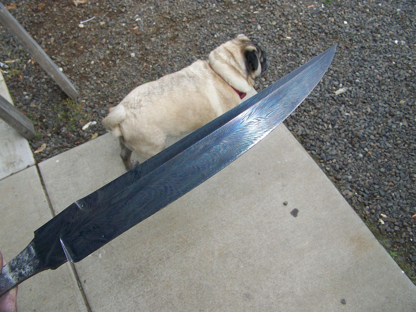

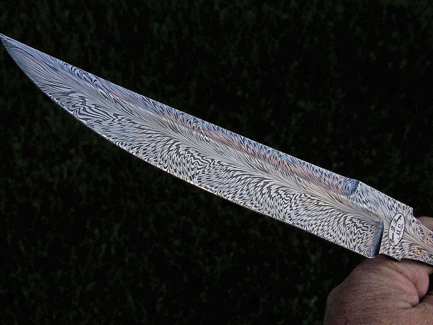

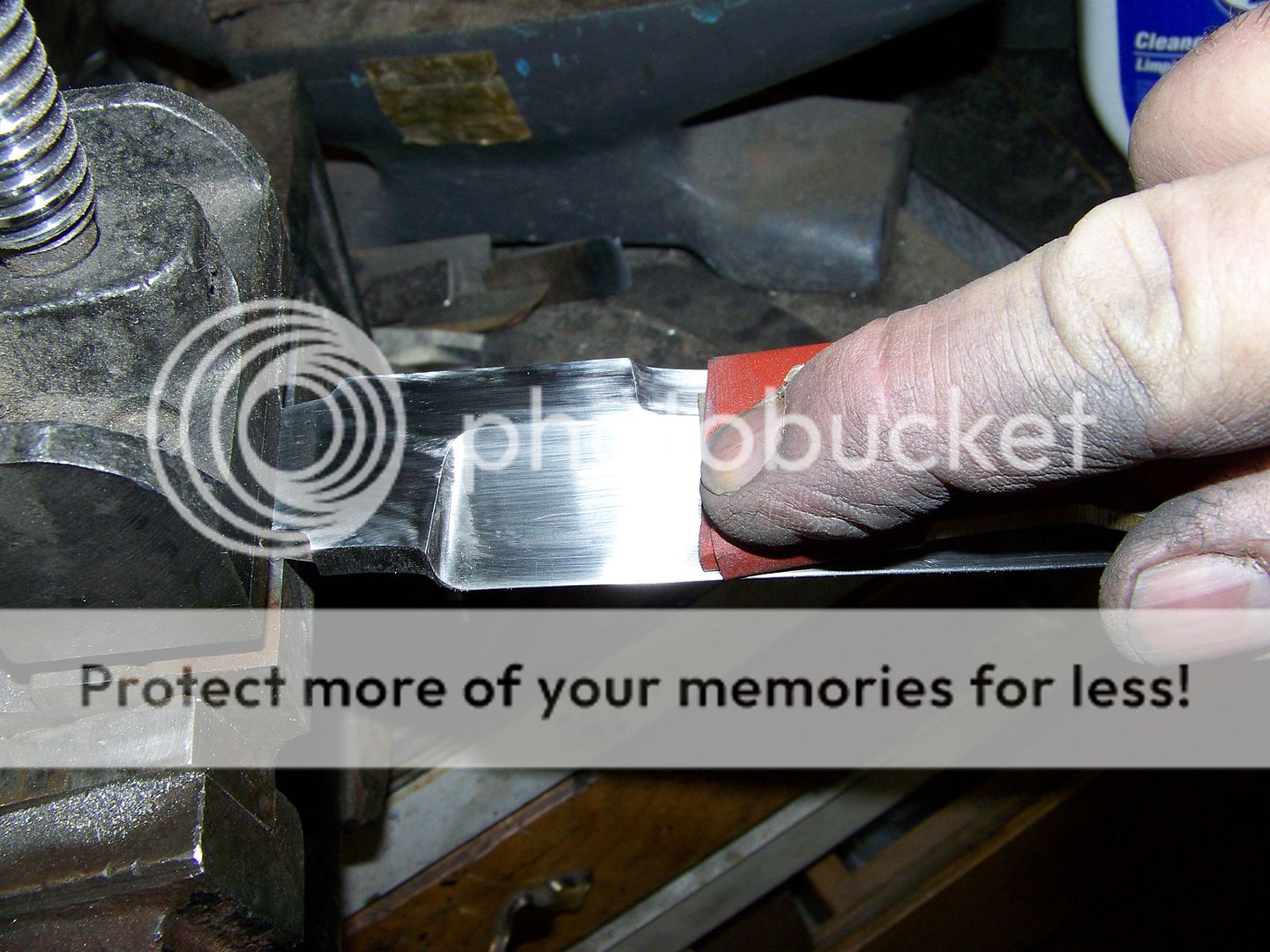

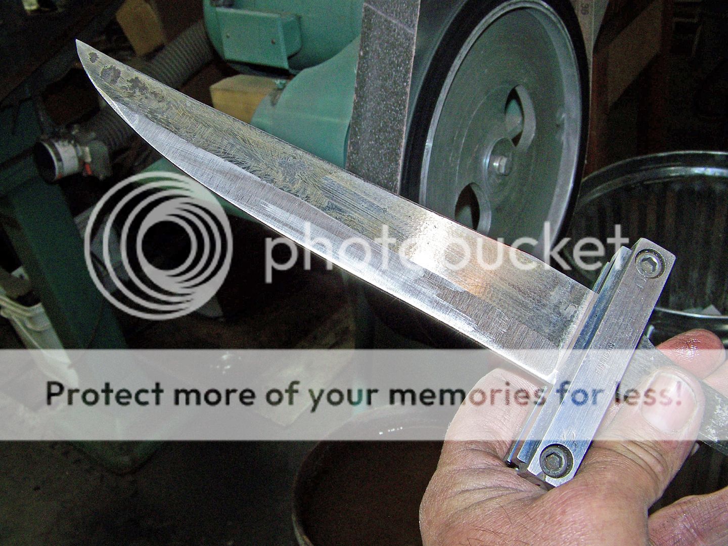

I had company today but still finished hand sanding and polishing the blade. I took it to 2000 grit and quickly hit it on the buffer, degreased and etched it in a weak ferric cloride for about 90 minutes for an even deep etch. It needs to be deep enough to polish the proud 15n20 without rubbing touching the lower 1080 for the best contrast. I used two coats of cold blue to darken the 1080 and let it dry for an hour or so and hit the tops with new 2000 grit paper dry.
I like this pattern as its much the same but much different. It looks like ruffled feathers to me. Its a uniform pattern and goes one way and then the other way. The bigger billet and stacking it higher than before gave it a unique dramatic look. Its a good blade and I'm using it. :cool:

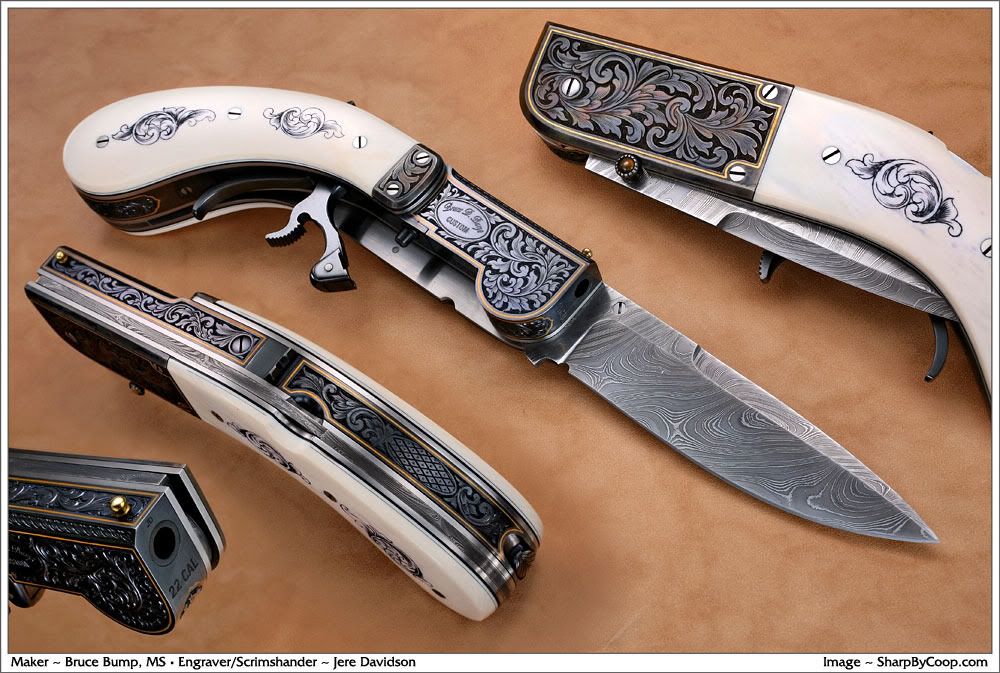

Here's an example of Jere Davidson's engraving/inlay and Doug Turnbull's "Color Case Hardening" process on Bruce's "Deadwood" pistol knife. Kind of gives the piece a nice antique look in my opinion.

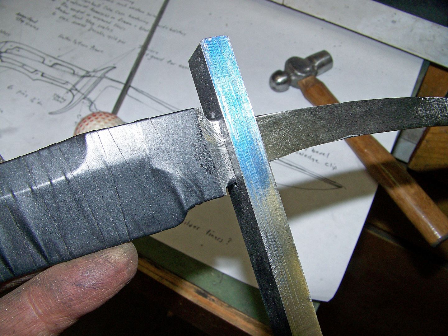

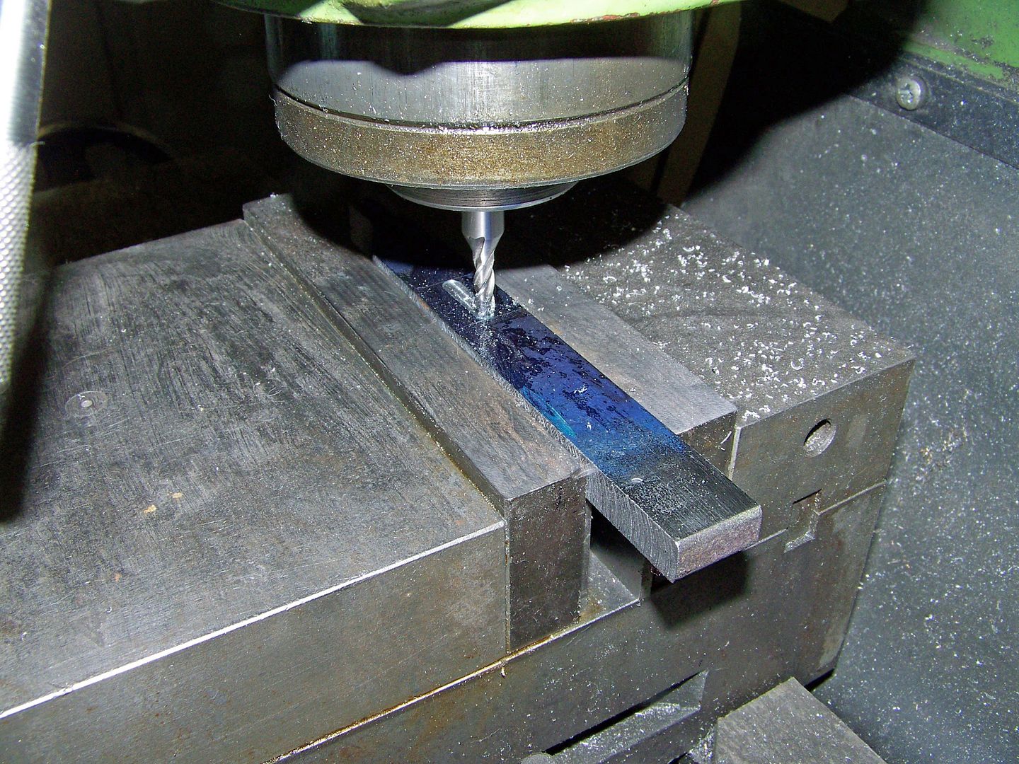

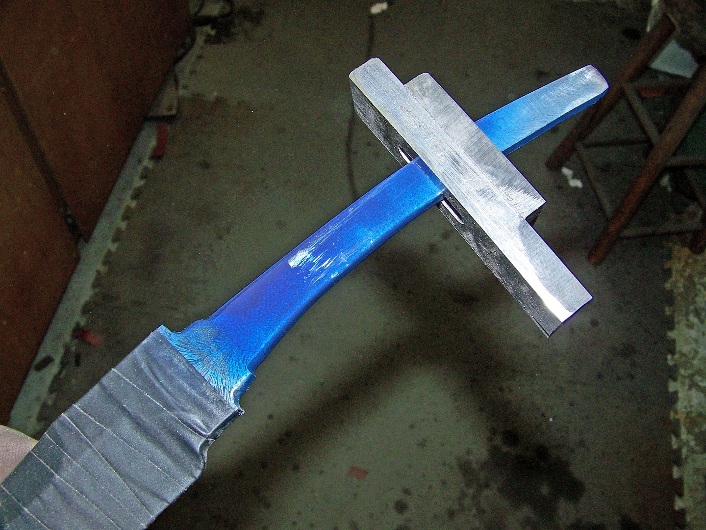

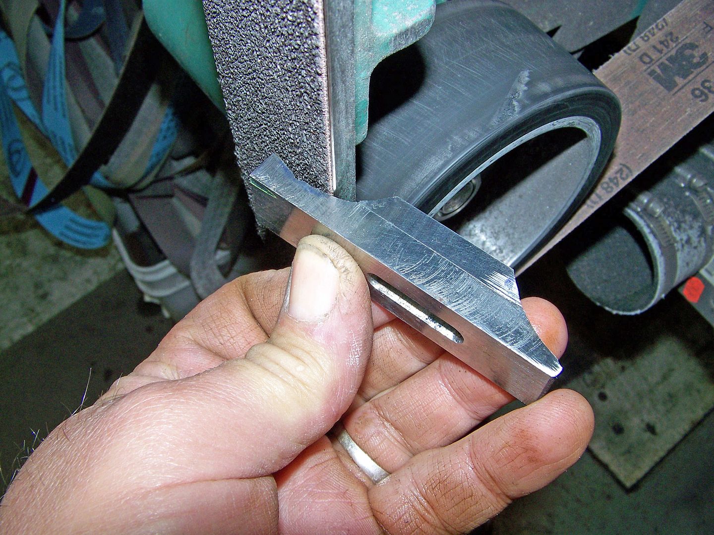

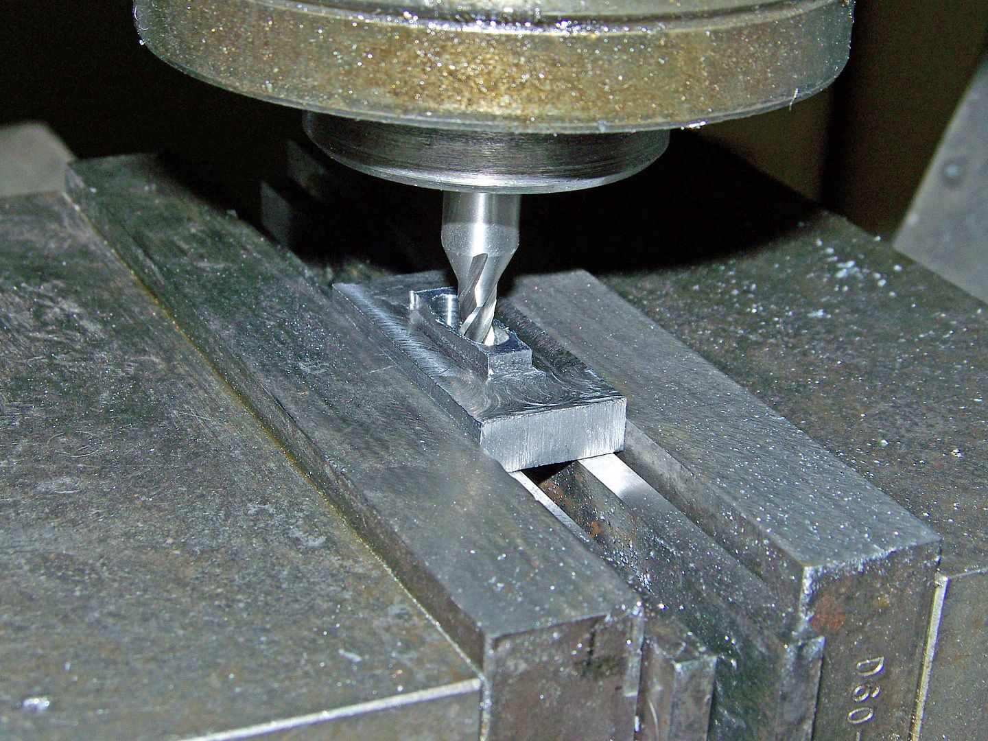

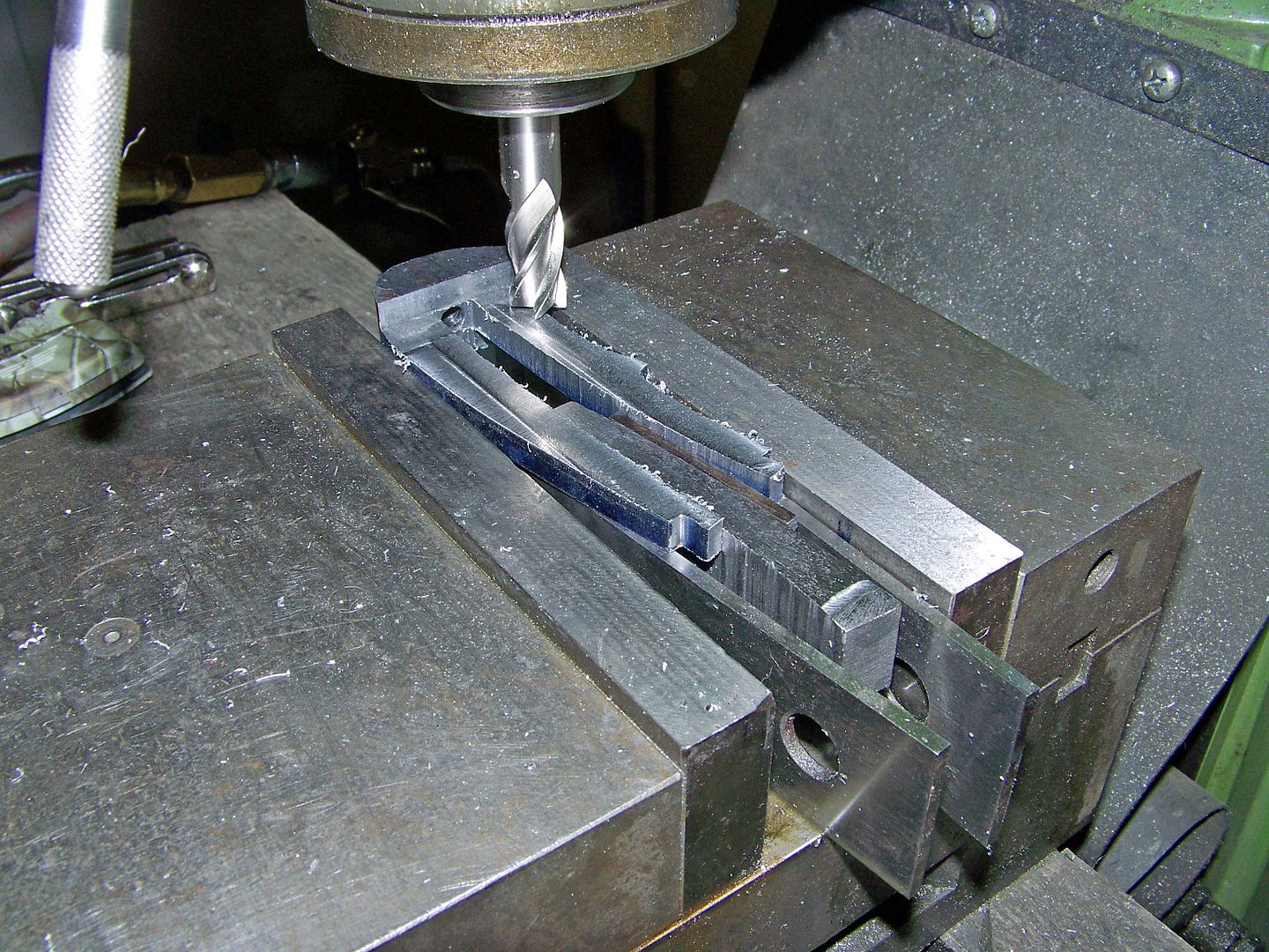

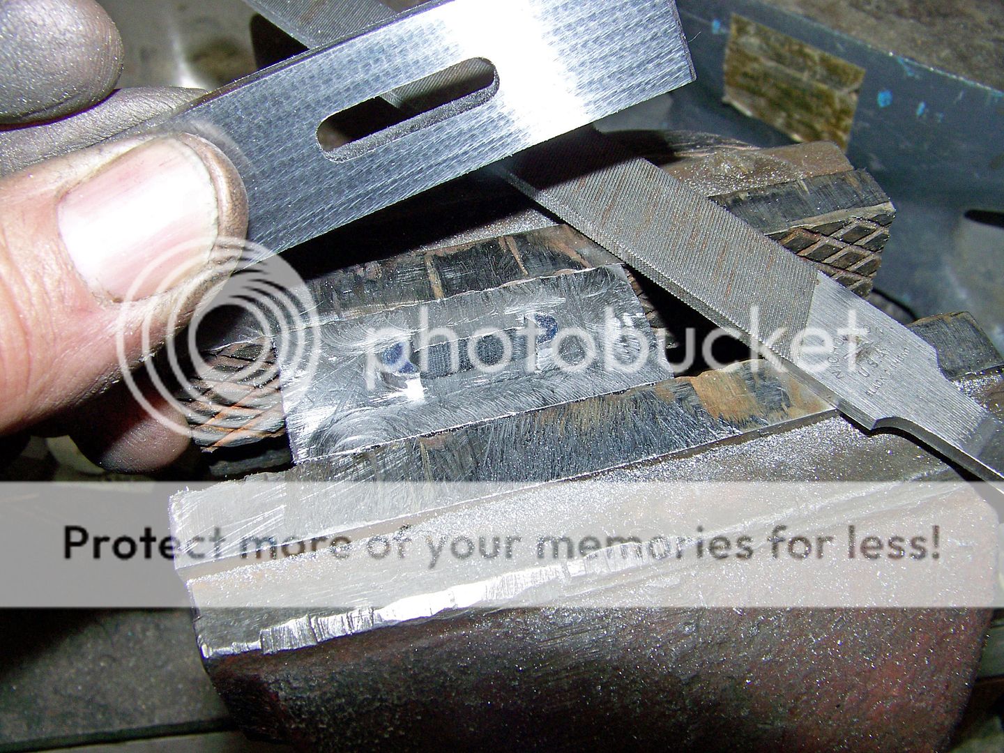

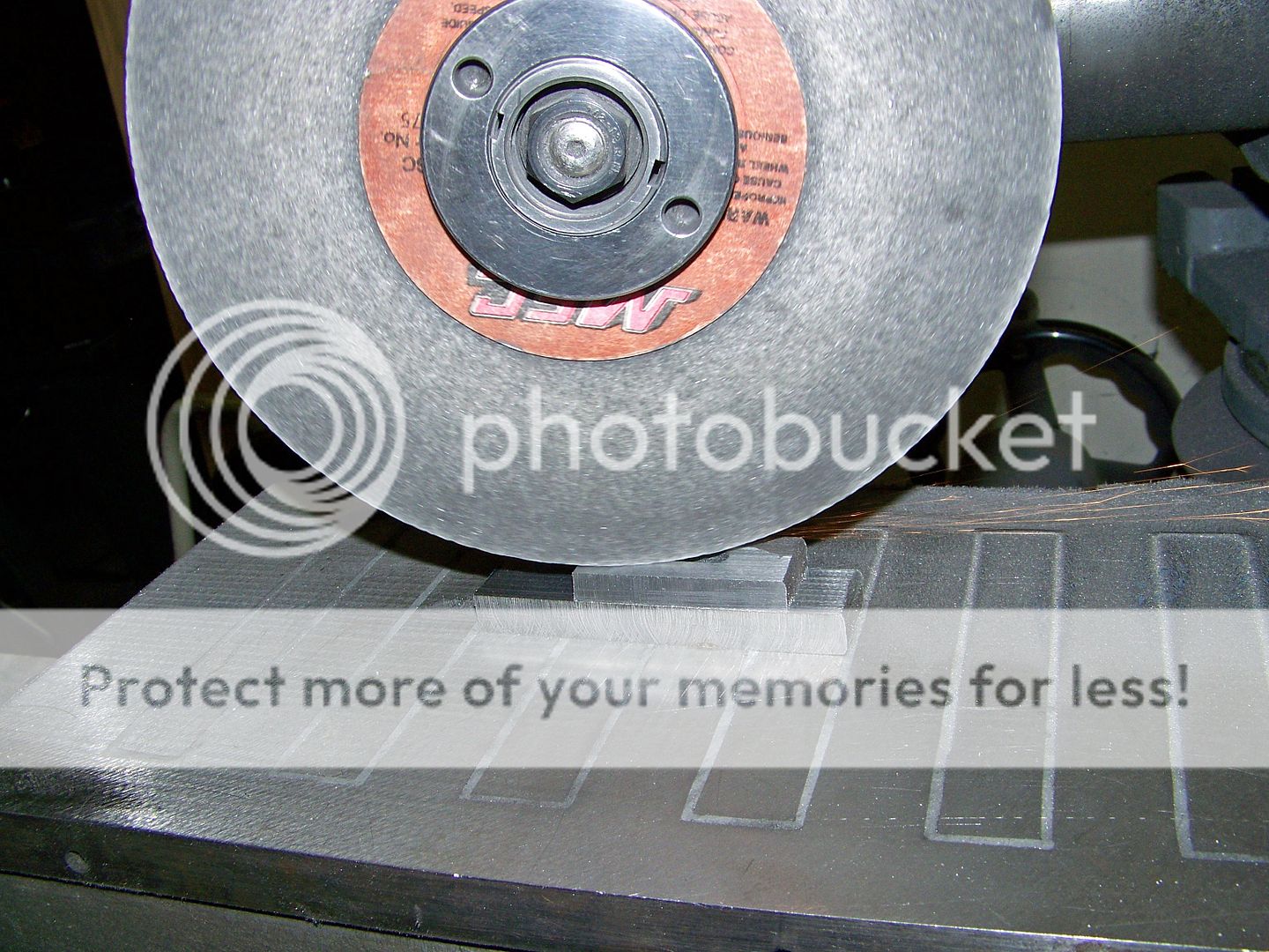

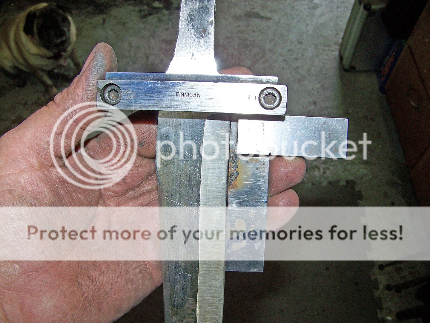

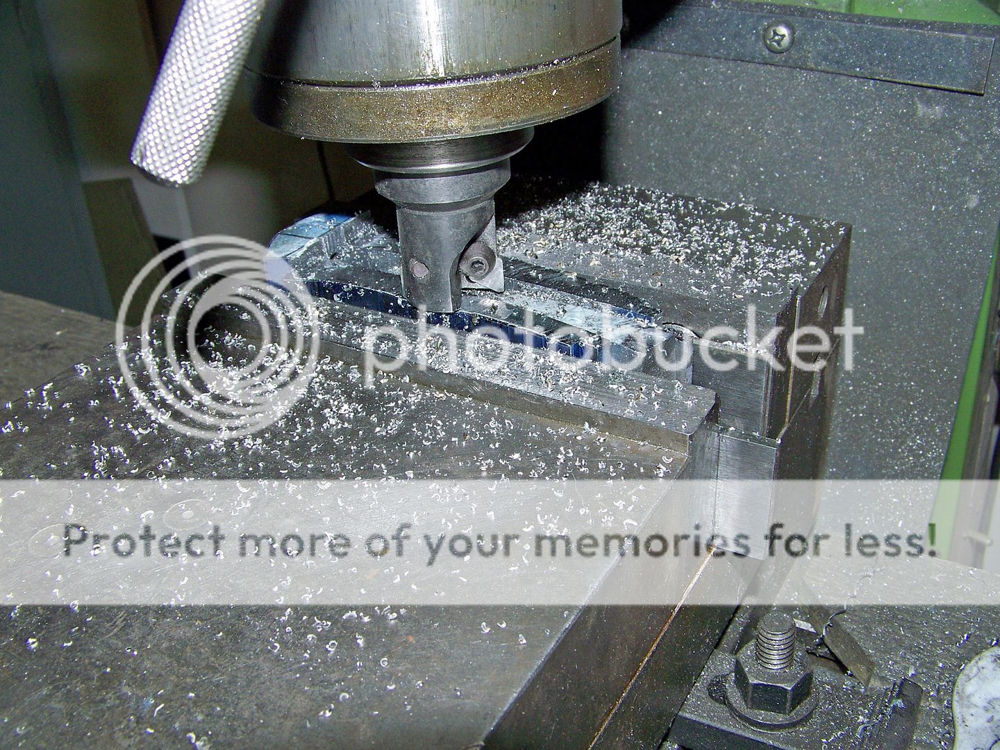

Today I worked on the guard, spacer and tang. I want this to be a framed handled "Take Down" bowie so the guard and spacer needs to slide on tightly but also slide back off again. I like to mill the slot in both and mill some of the spacer back off and leave a pair of tabs that engage in the backside of the guard. They lock the two together and no alignment pins are needed. The frame will also have tabs that engage into the back of the spacer. I rounded off the tang to match the rounded slots.

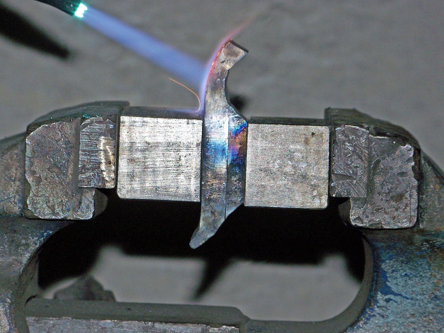

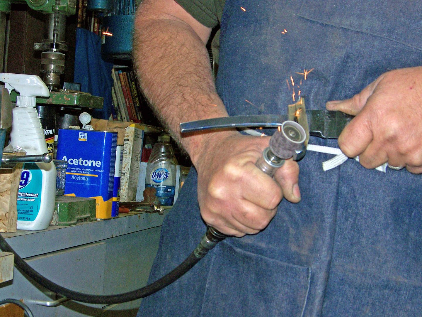

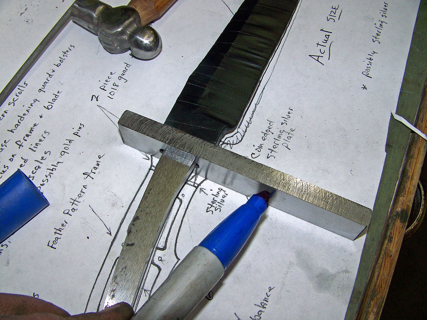

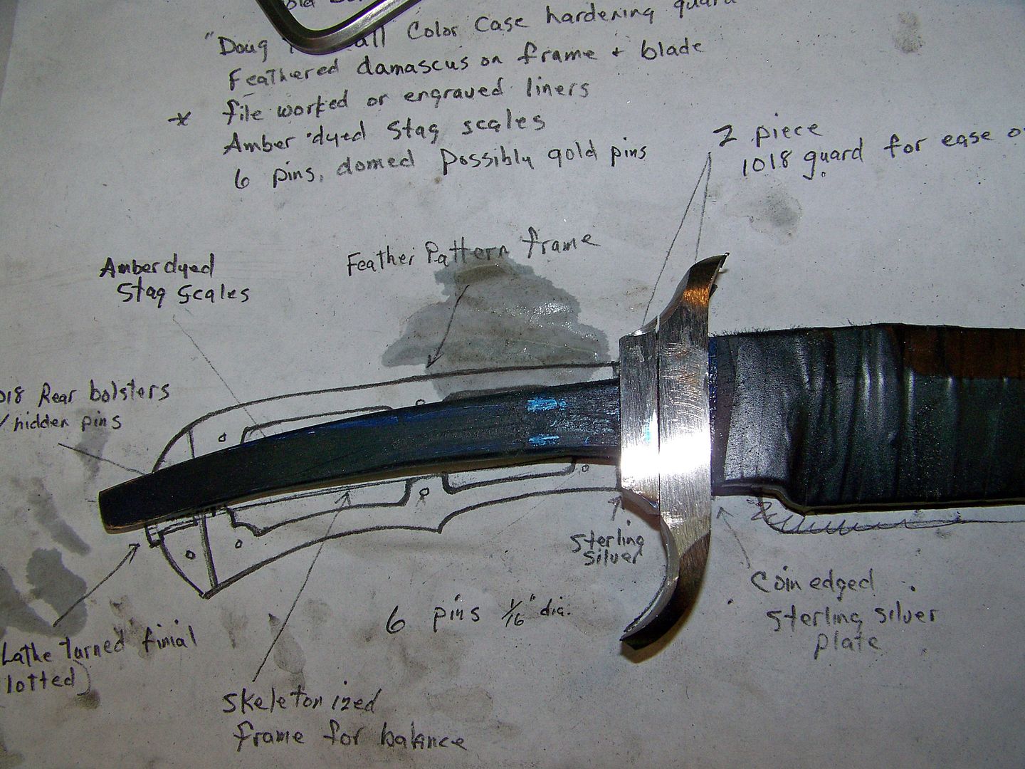

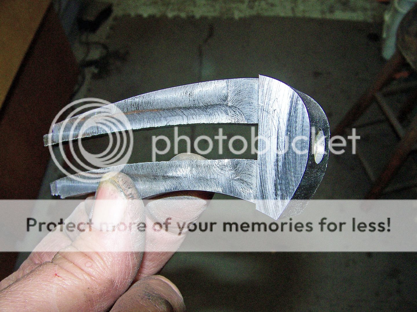

I roughed out the guard on the bandsaw and grinder and heated and bent both ends to a lazy "S" shape. This is where its good to have the drawing for the shape and the length.
I have a 1/4 hp foredom that loves to make inside radious's on guards. It took a couple times of grinding and heating/bending before I got the correct shape.

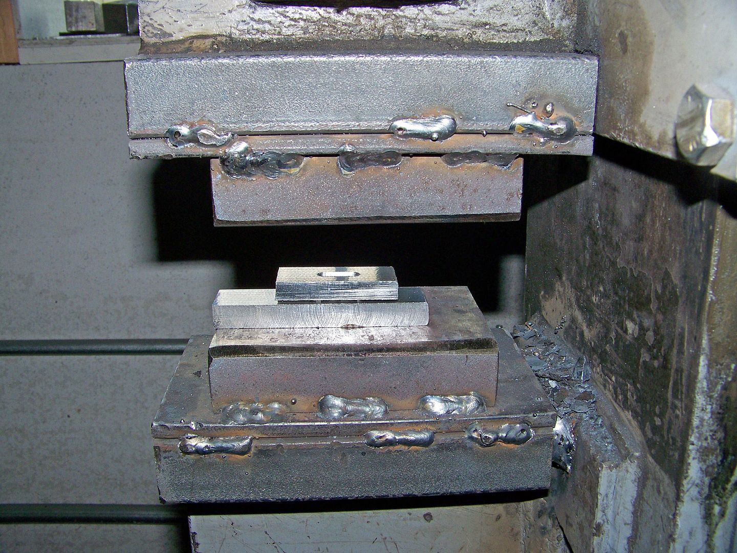

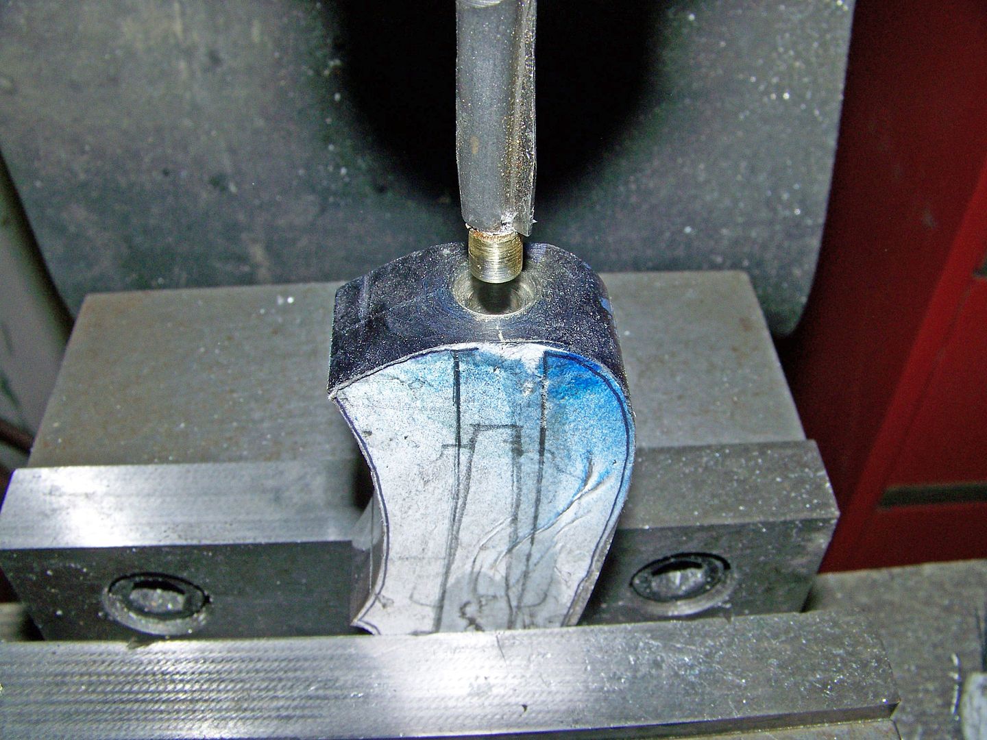

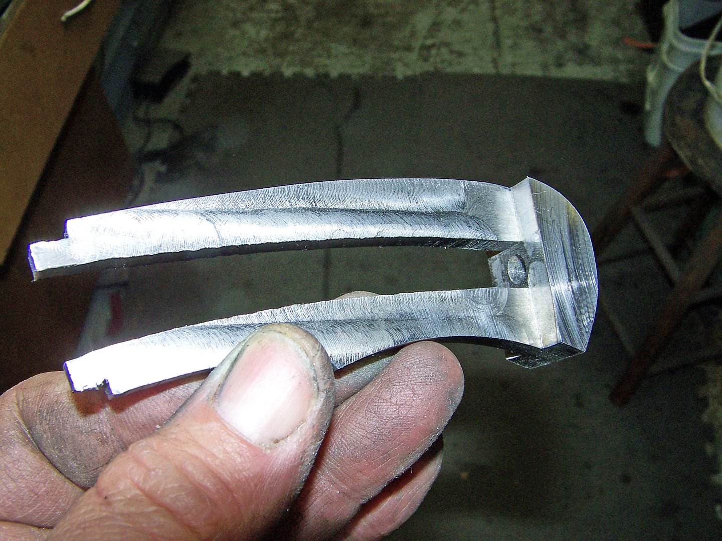

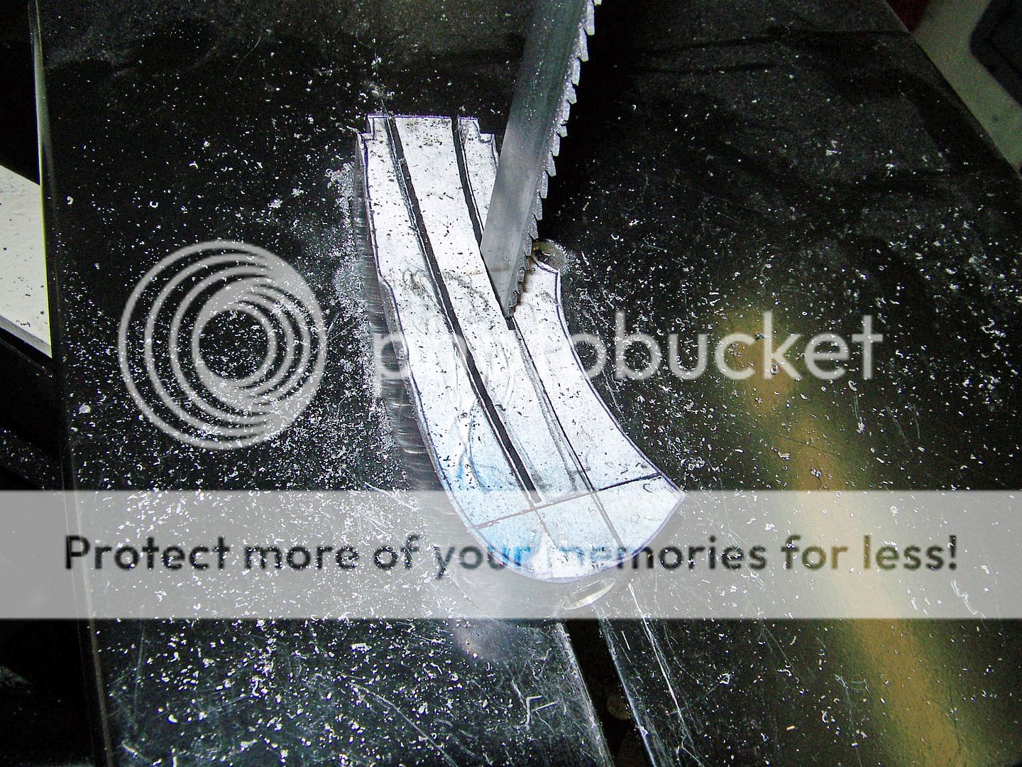

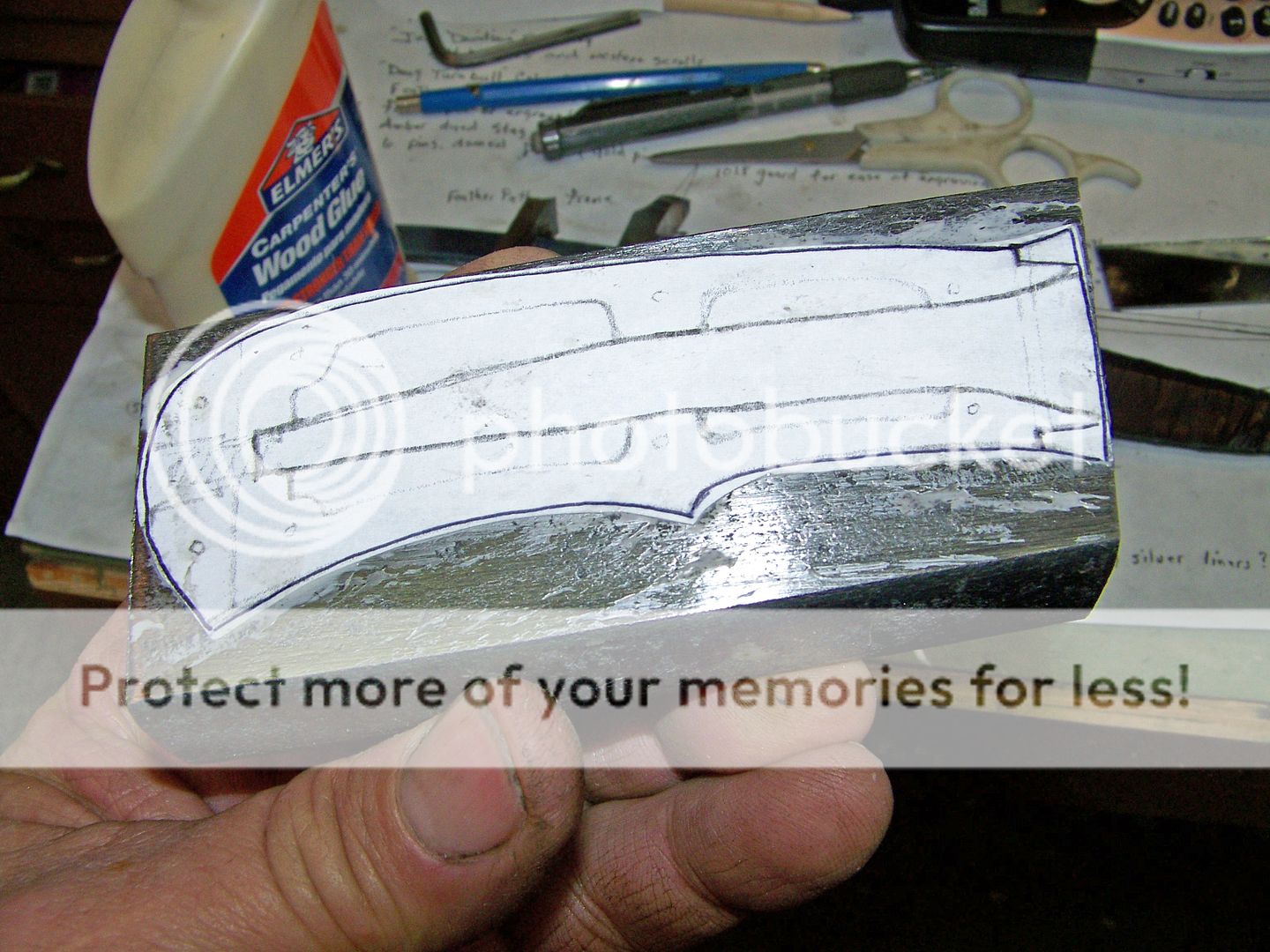

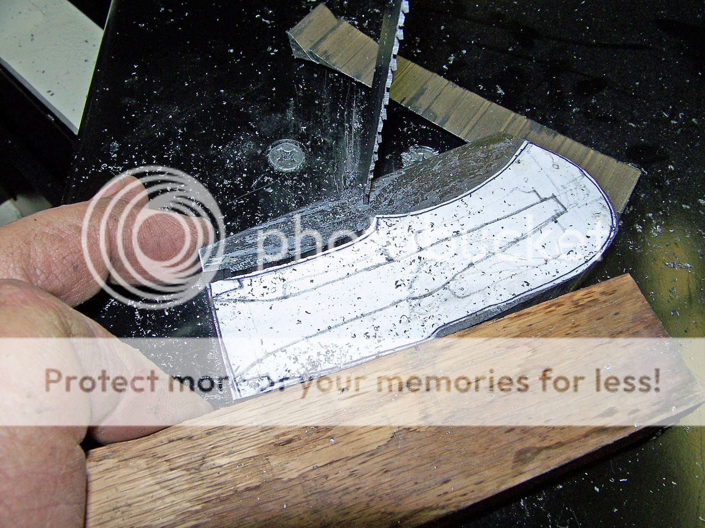

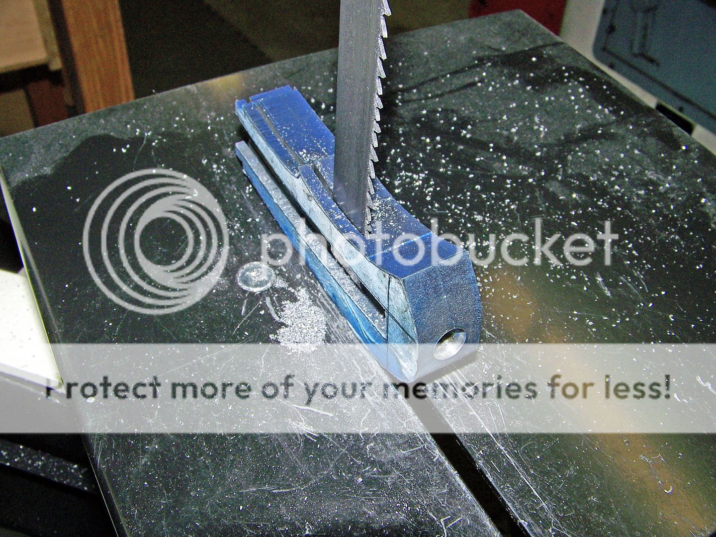

Next I cut the drawing up and glued it to the handle steel for the frame. Its a 3/4" 1018 steel bar and slow to cut out but very accurate. I traced the tang onto the paper and cut it also. Next I drilled and counter bored the pommel for the finial nut. This is a take down and the nut is the only thing holding this bowie together. I will thread the tang soon.

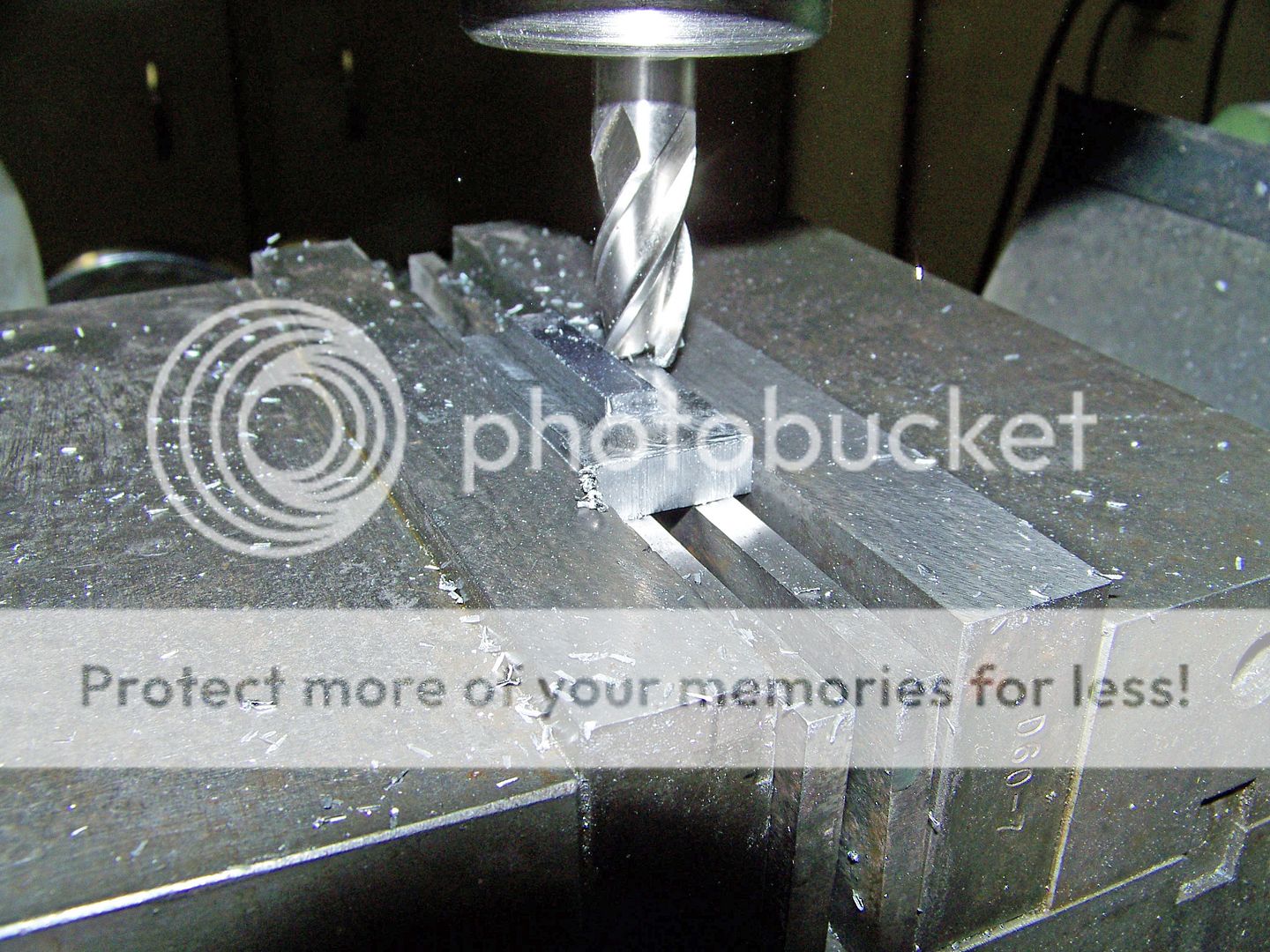

I want to remove allot of steel next and leave the rear bolsters so the bandsaw is handy for roughing it off. The mill works good for removing the rest and surfacing the frame to the same thickness as the tang plus a couple thousands of an inch.
