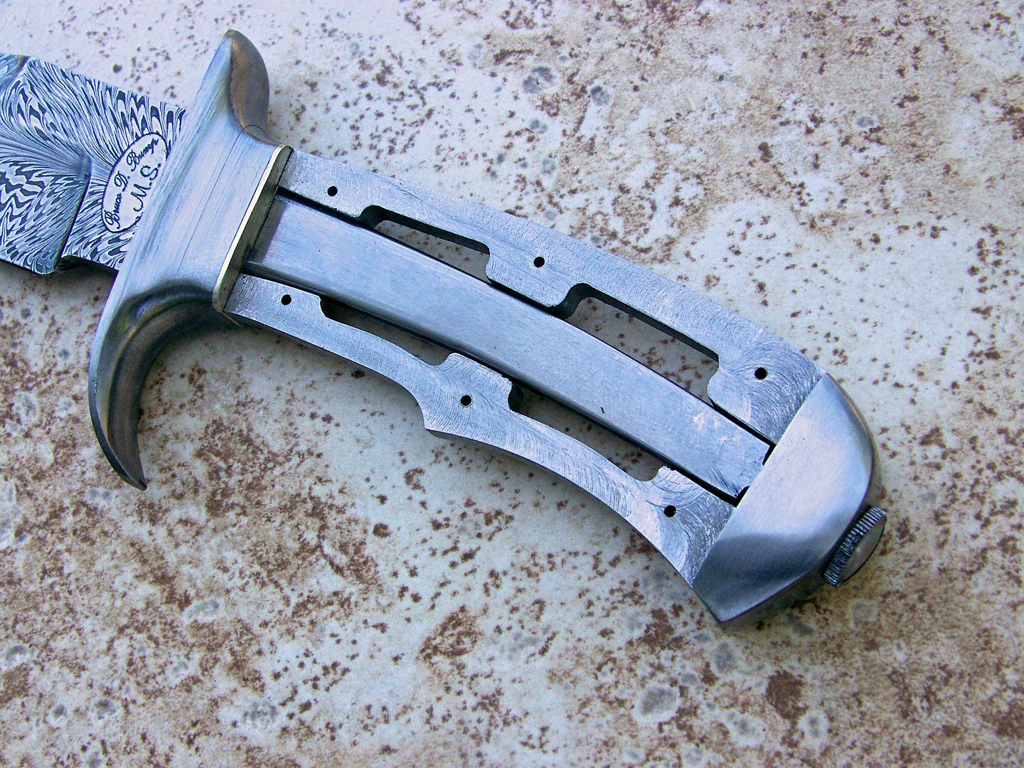

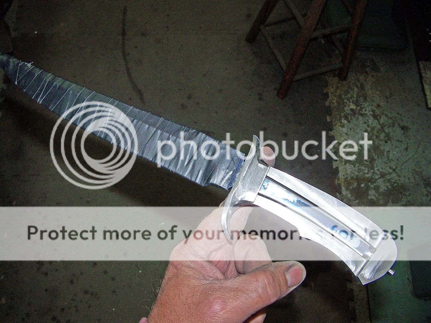

A "WIP" The Bruce Bump "Allan Pinkerton Bowie"
The original idea was for Bruce to make the frame and rear bolster halves separate and pin them together, however he decided to make them one piece (above) thus eliminating any seams for Jere Davidson to deal with when engraving around the rear bolster.

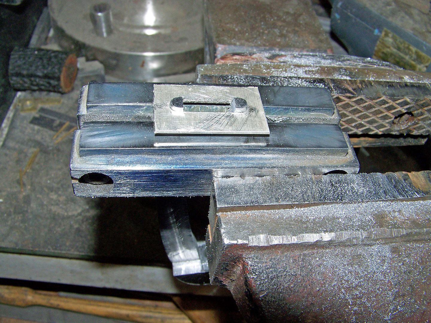

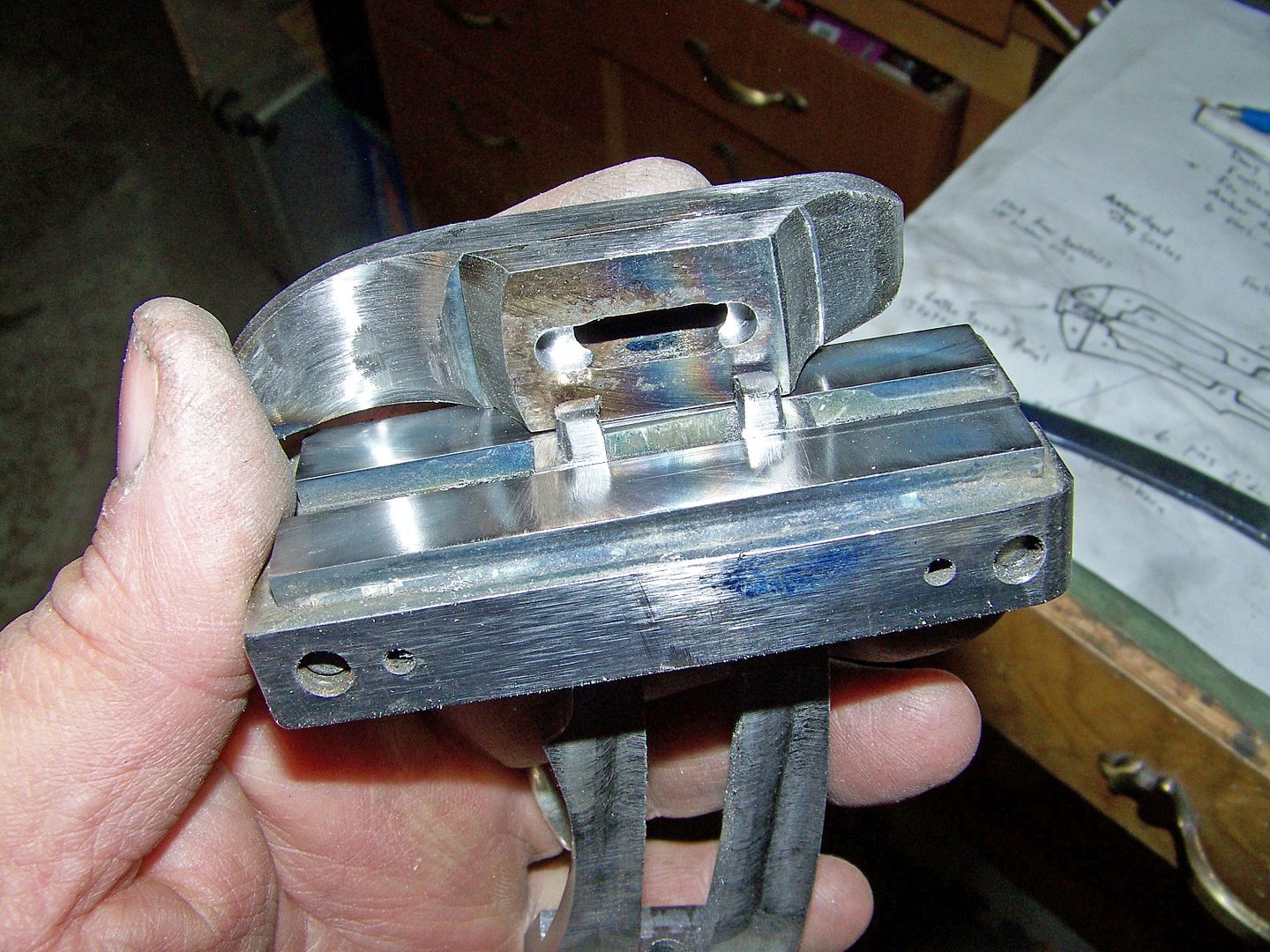

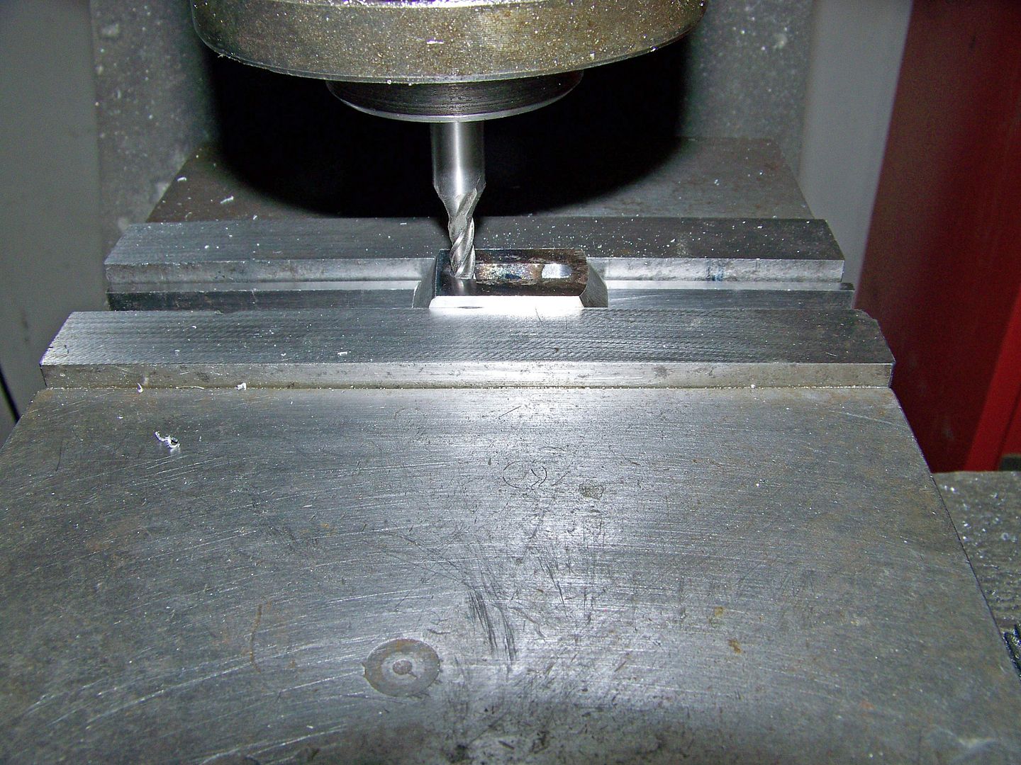

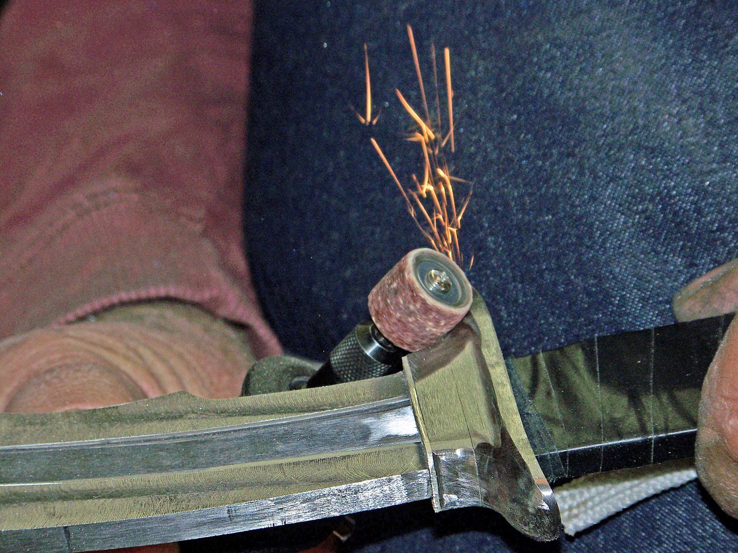

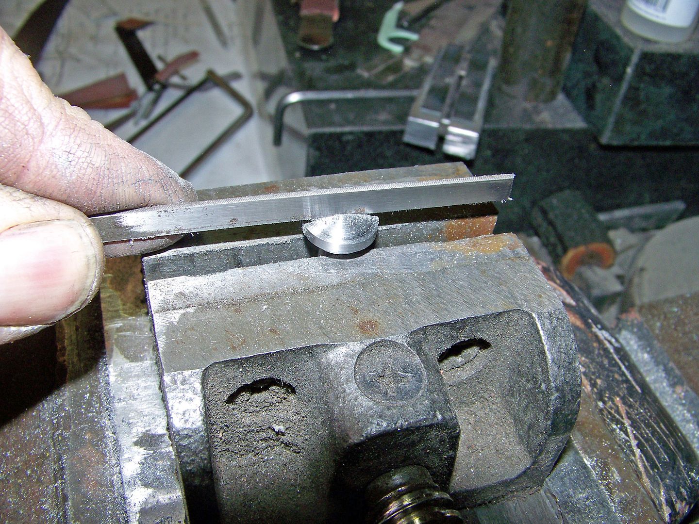

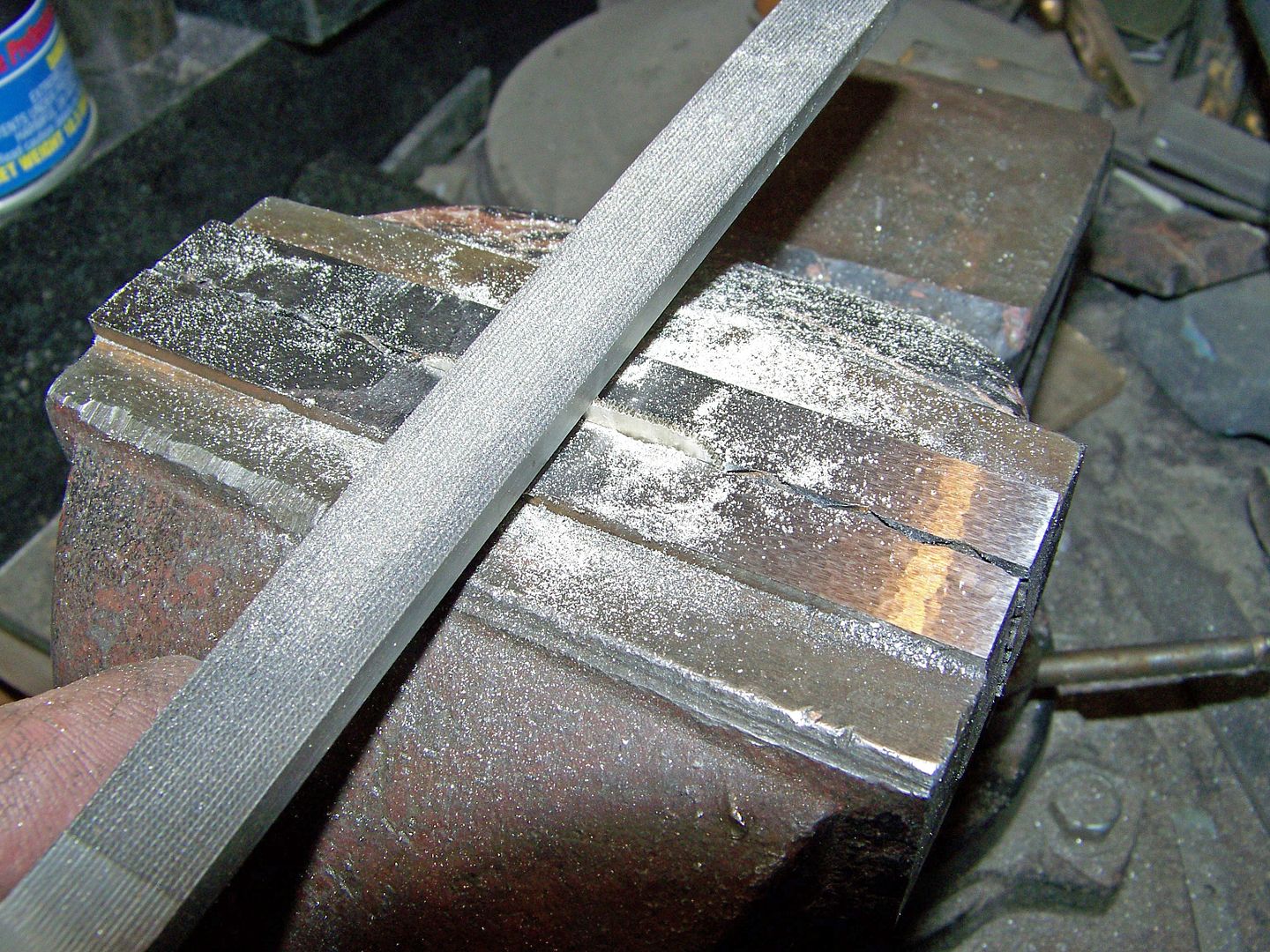

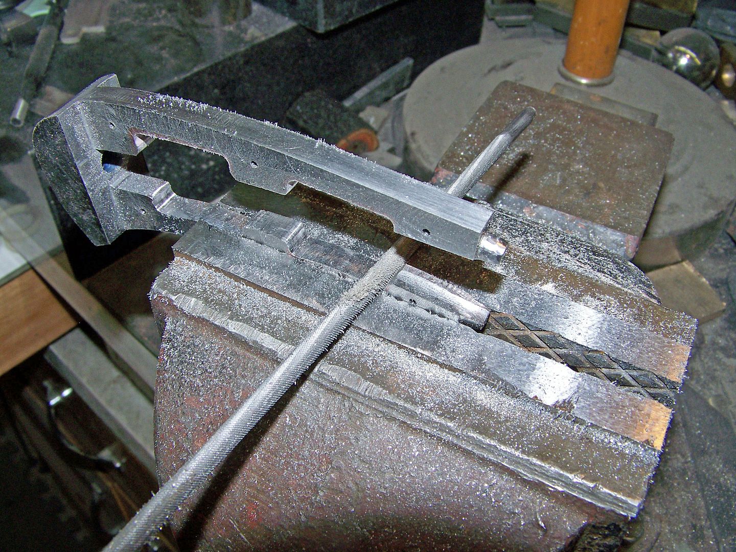

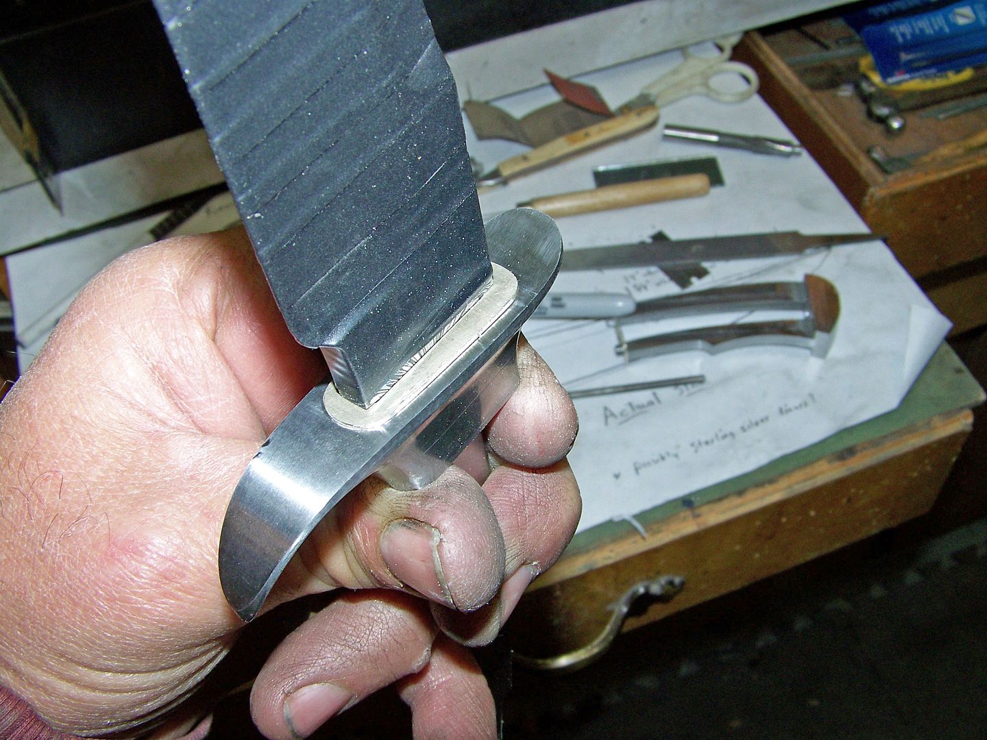

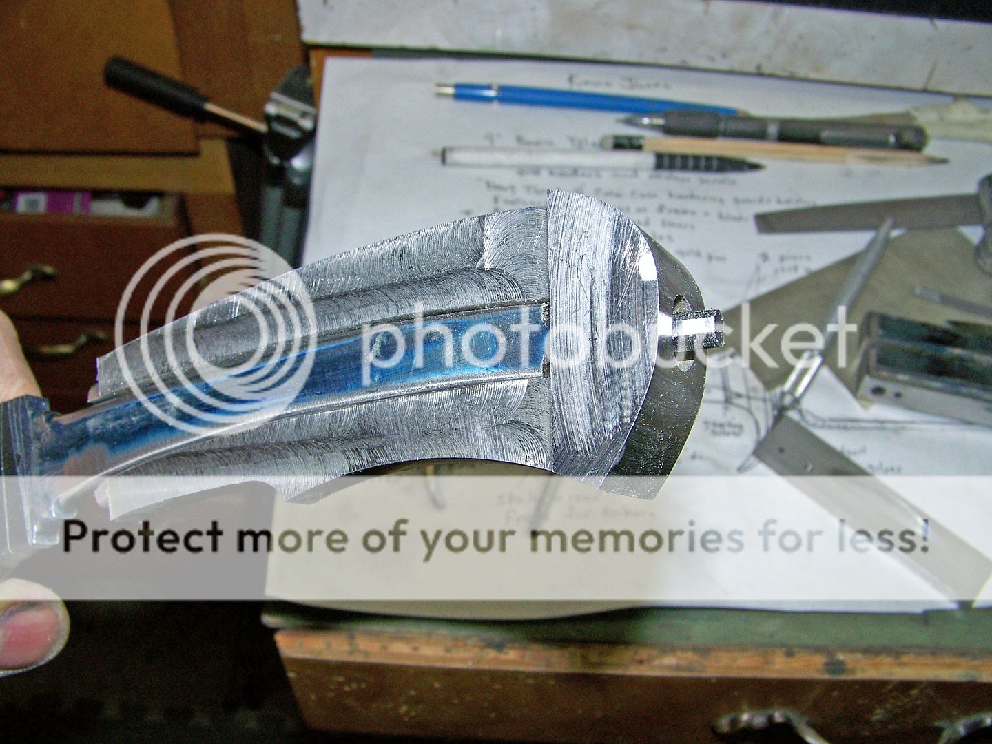

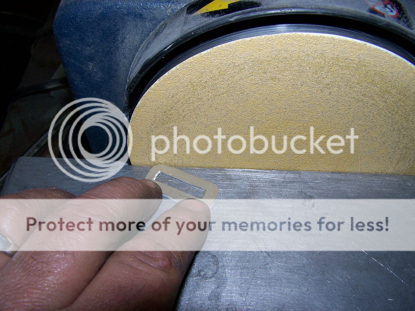

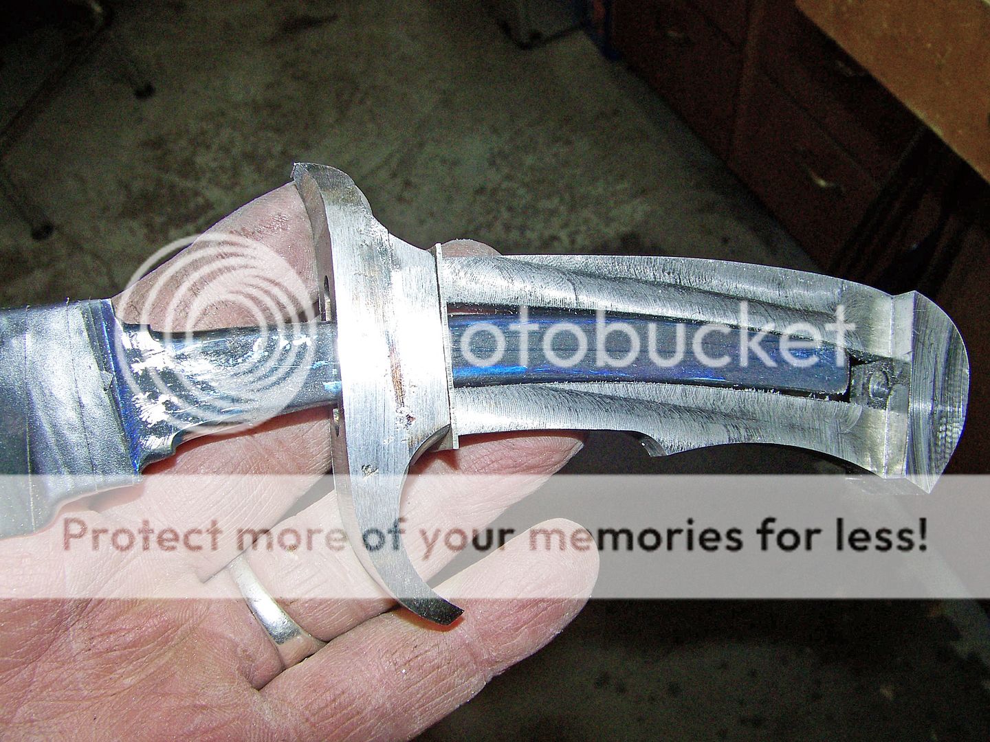

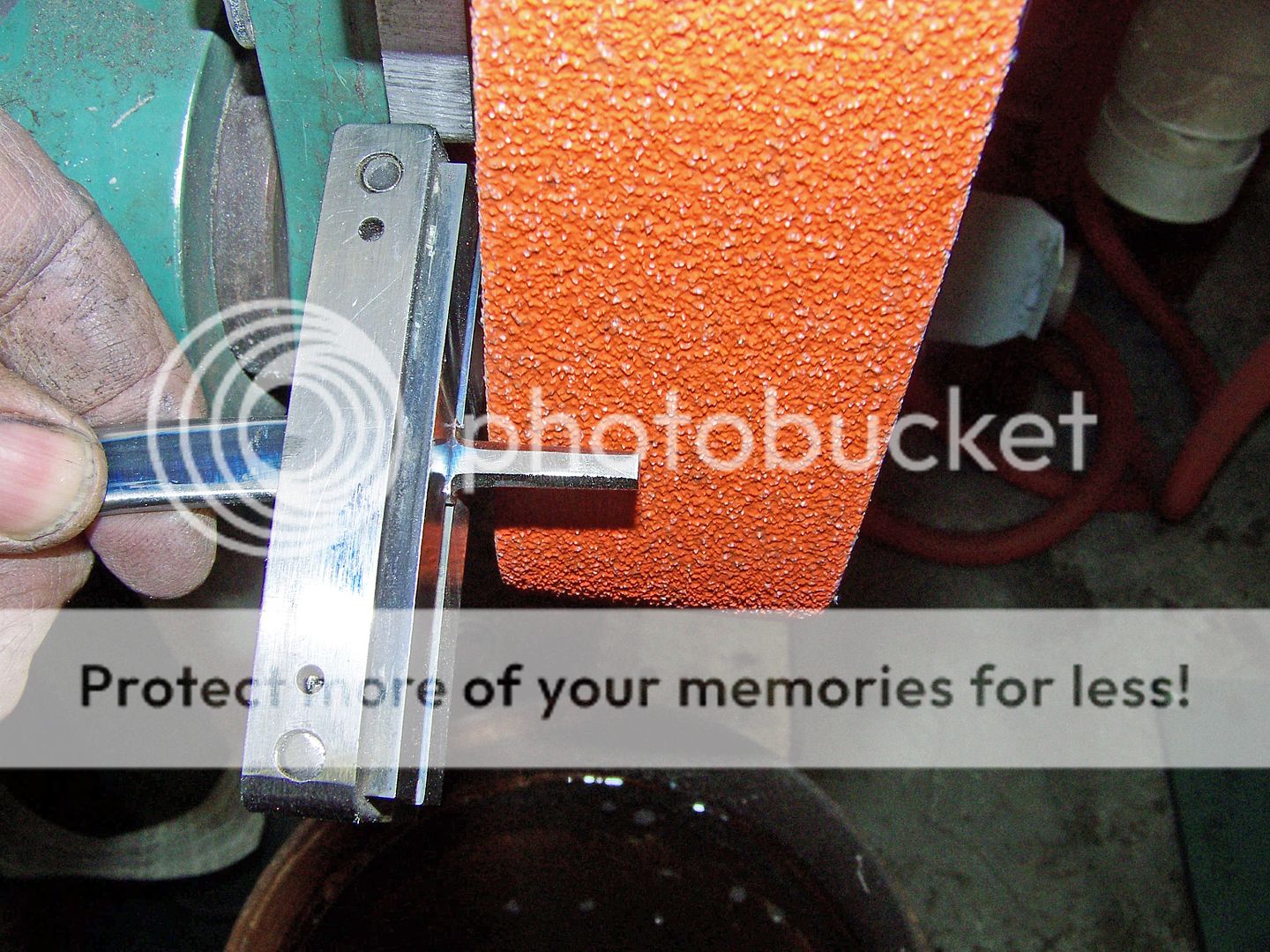

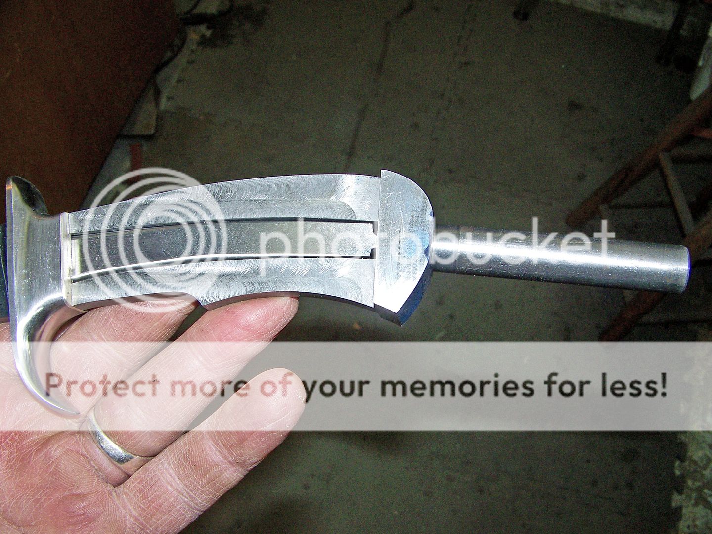

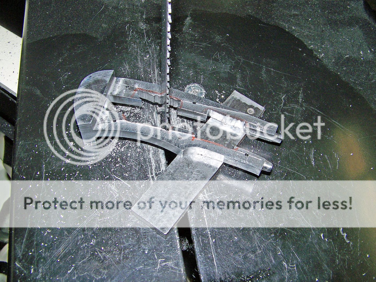

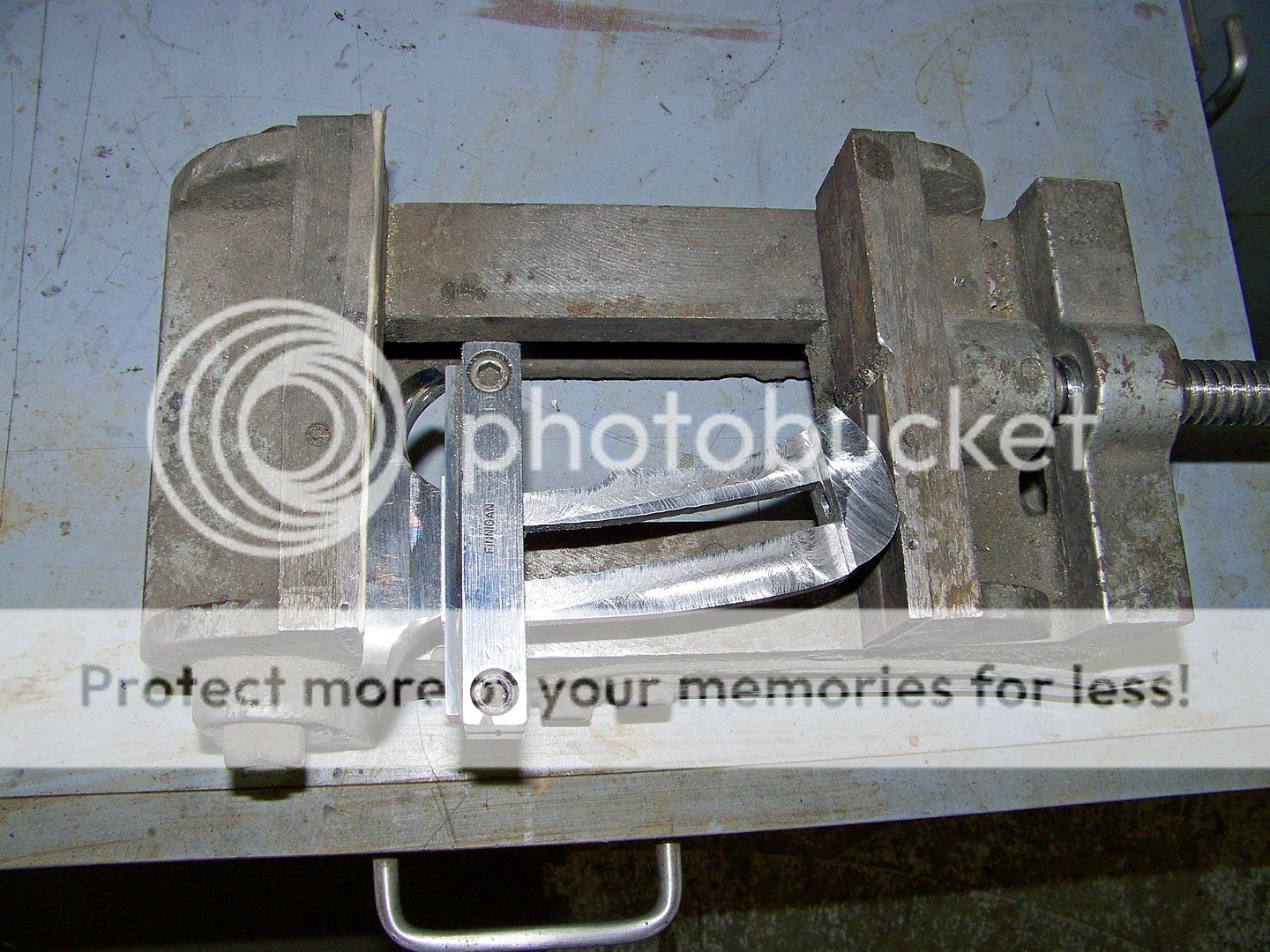

I worked most all day on the fit up on the guard/spacer and the frame. I milled a slot in the front liner too. This will have sterling silver front and side liners between the frame and the stag scales. There will also be a sterling oval shaped plate between the blade shoulders and the front side of the guard also.

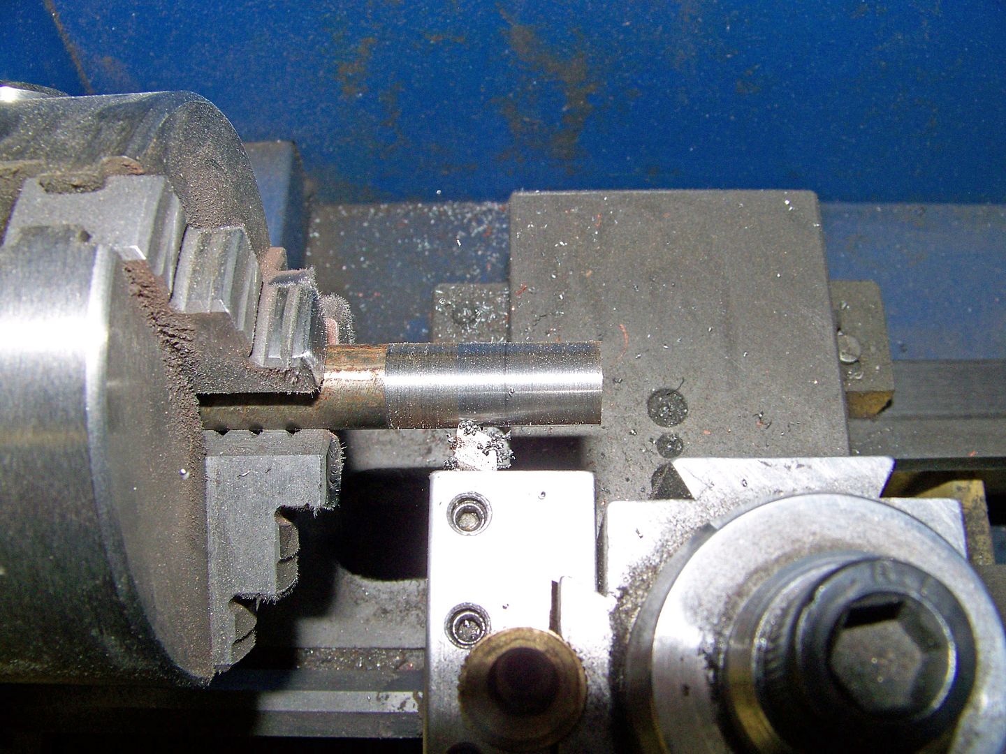

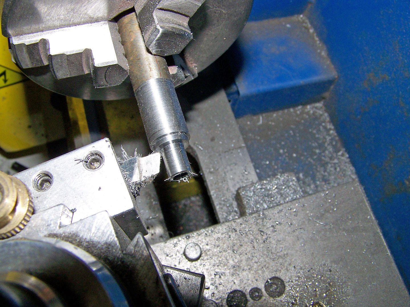

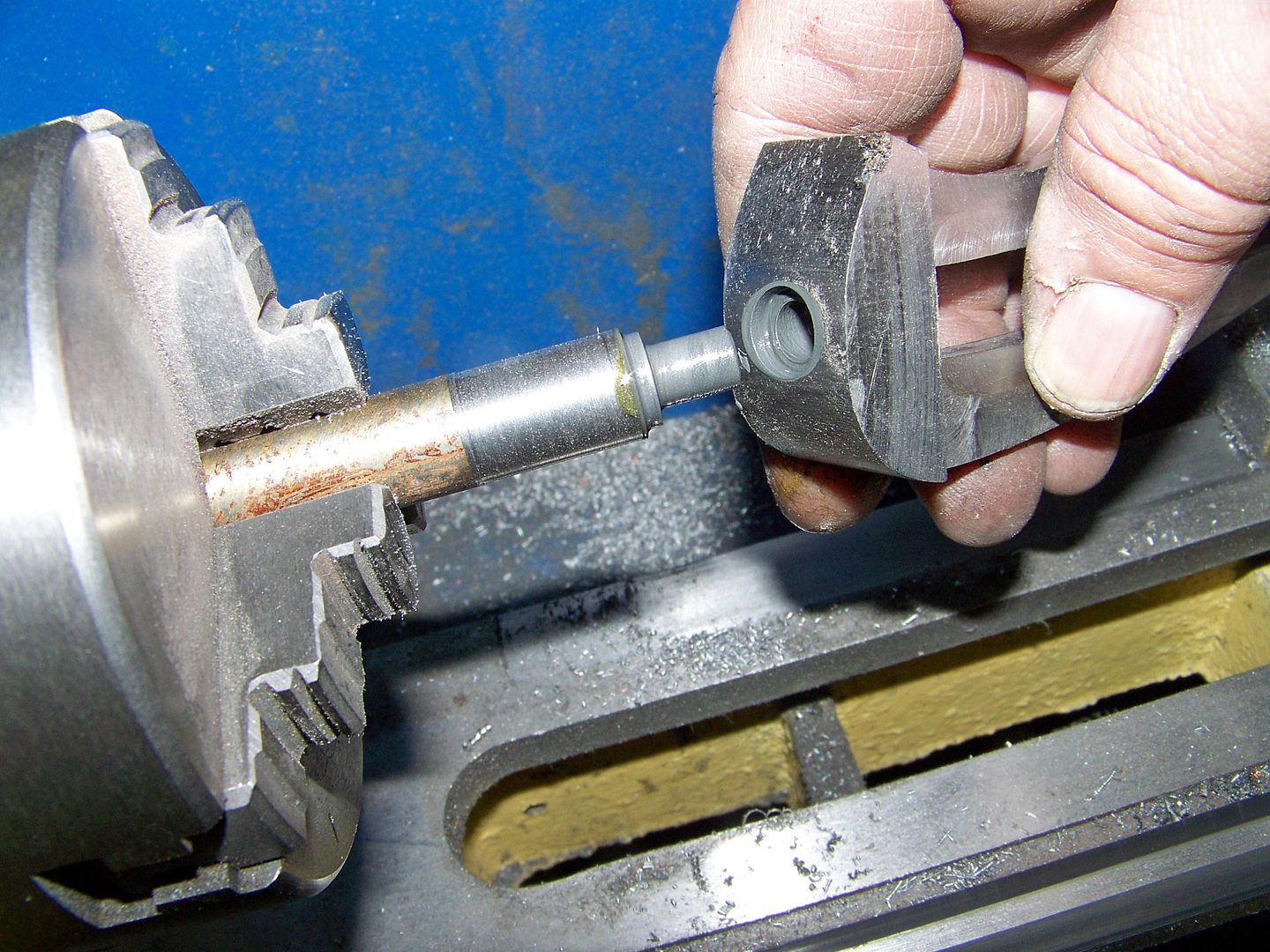

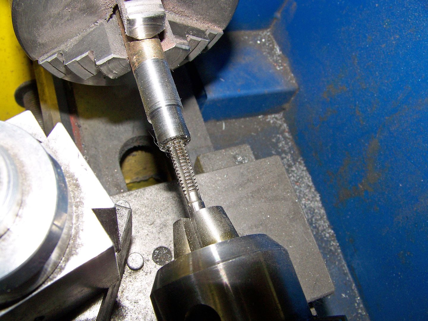

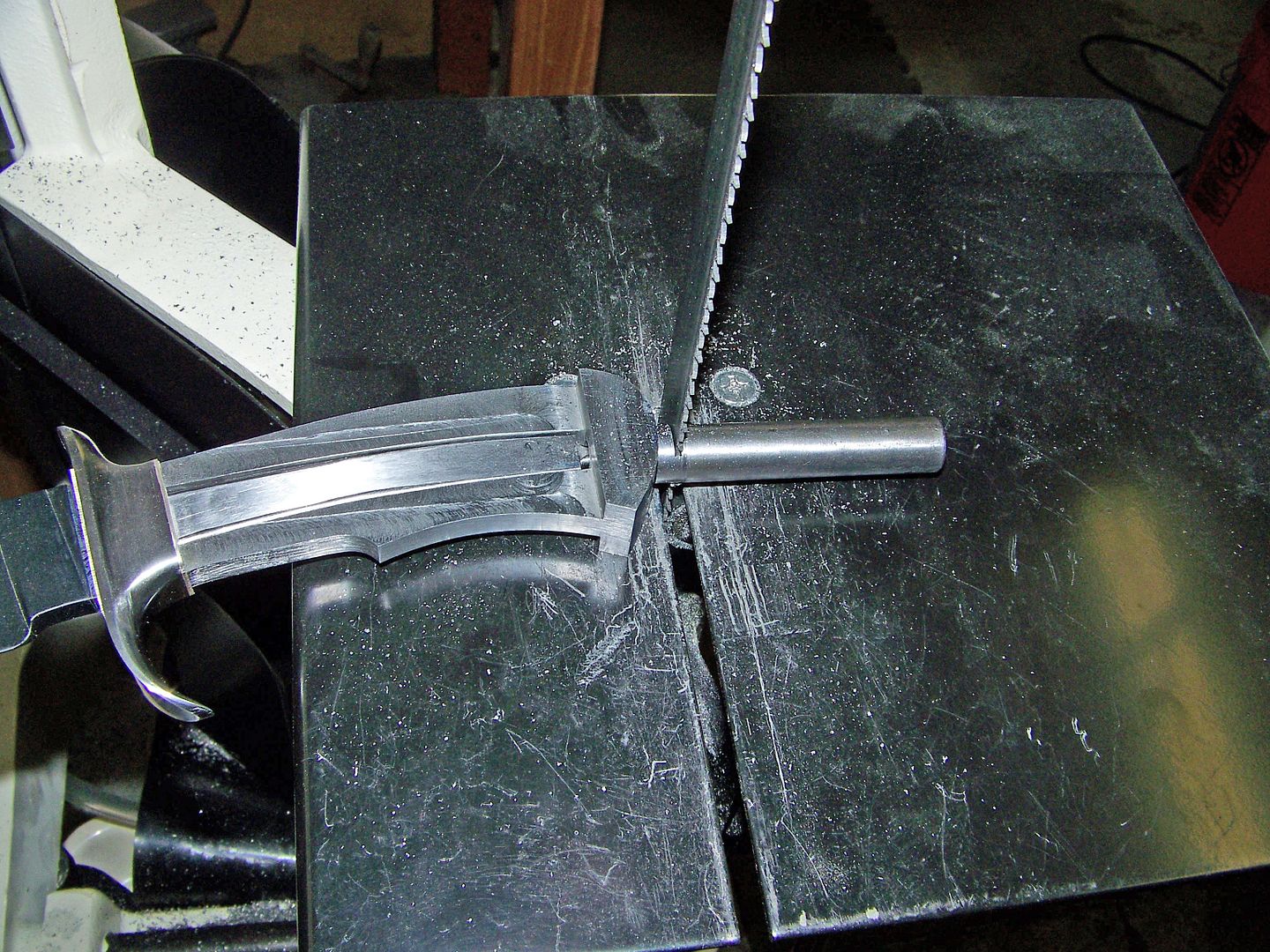

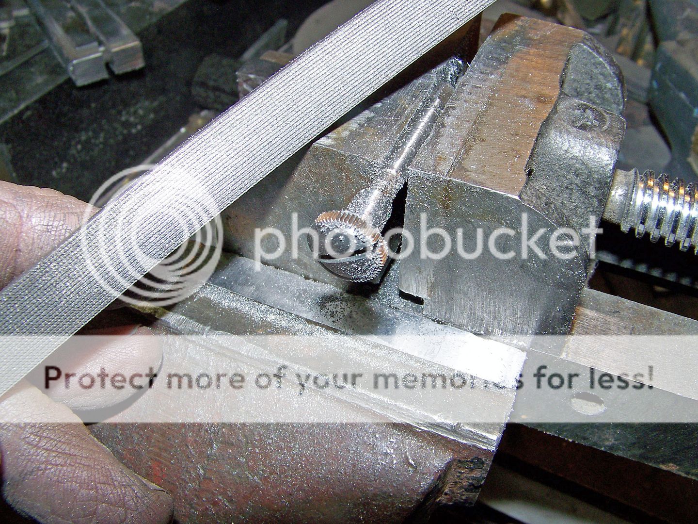

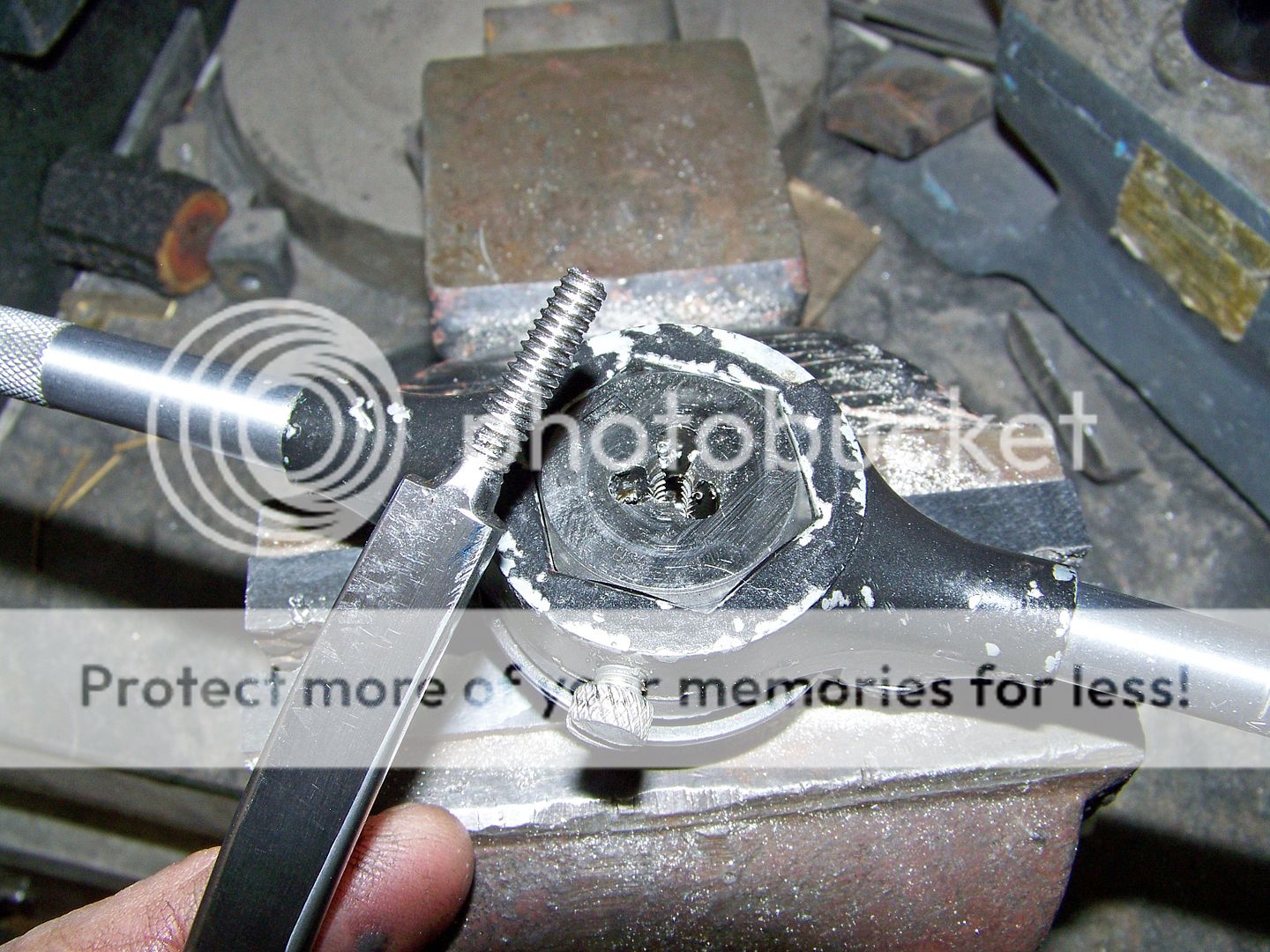

Today I worked on the finial nut, threaded the tang and lightened the frame. I had to make 2 nuts because I broke the tap off in the first one and I'm not so sure the second one will work because the hole is drilled nearly too deep but those are easy problems to solve later. I also began to shape the pommel end and finished sanding and truing up the guard. Monday or Teusday this should be ready to send out for the engraving. I need to order more sterling silver plate for the liners and I'm still waiting for Culpeppers to send the amber dyed stag back but I can fit the liners and scales to it after it is engraved.

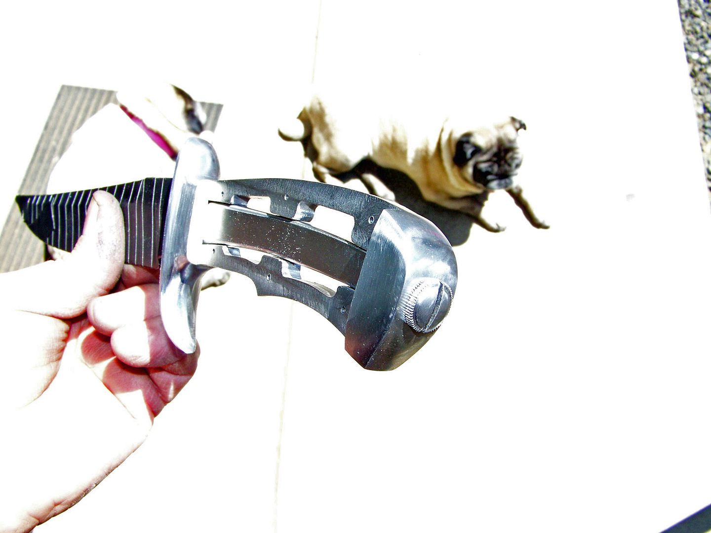

Here is our bowie assembled for the last time before the engraving. I've talked to Jere and he is camped by the mail box.
This is the 3rd finial nut but I like this one and it locks the frame down solid. The larger thread size was a good move.

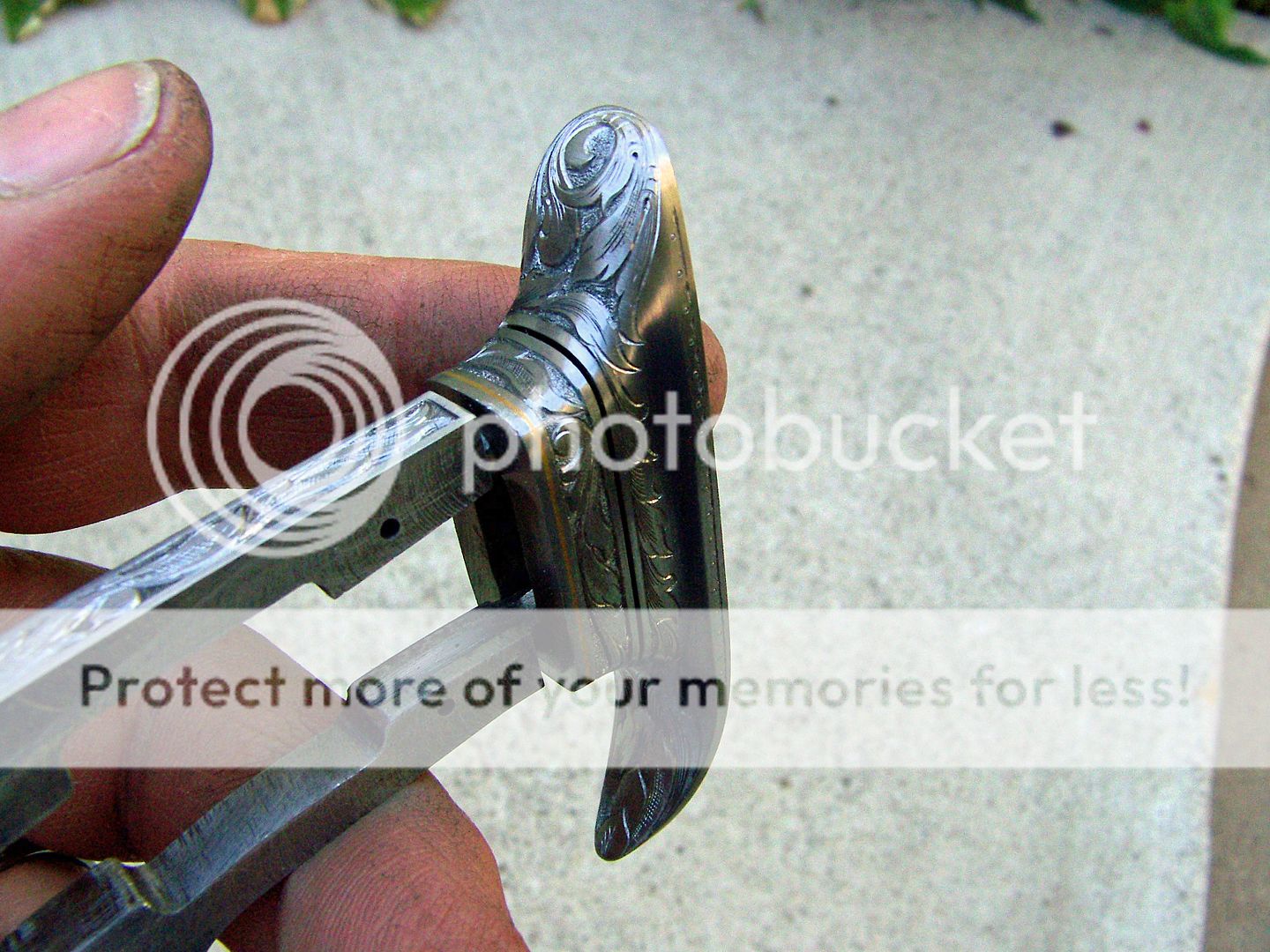

Jere (and Edmund for that matter) live only a couple hours from me so after he finished with the engraving and gold inlay I went to his shop to pick up the guard and frame/rear bolster assembly and was amazed by the beauty and preciseness of his work. He's a hand engraver (hammer and chisel, even makes many of his tools) and the deep relief, detail and straightness of his borders are incredible.
After looking over the work and considering the entire knife design we decided the knife would benefit from him taking it farther. He got to work on it and I returned a week later and picked up the pieces which again surpassed my expectations.

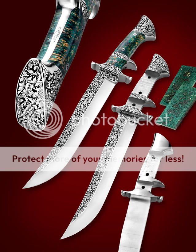

Photos from the David Darom Book, Edmund Davidson "The Art of the Integral Knife".

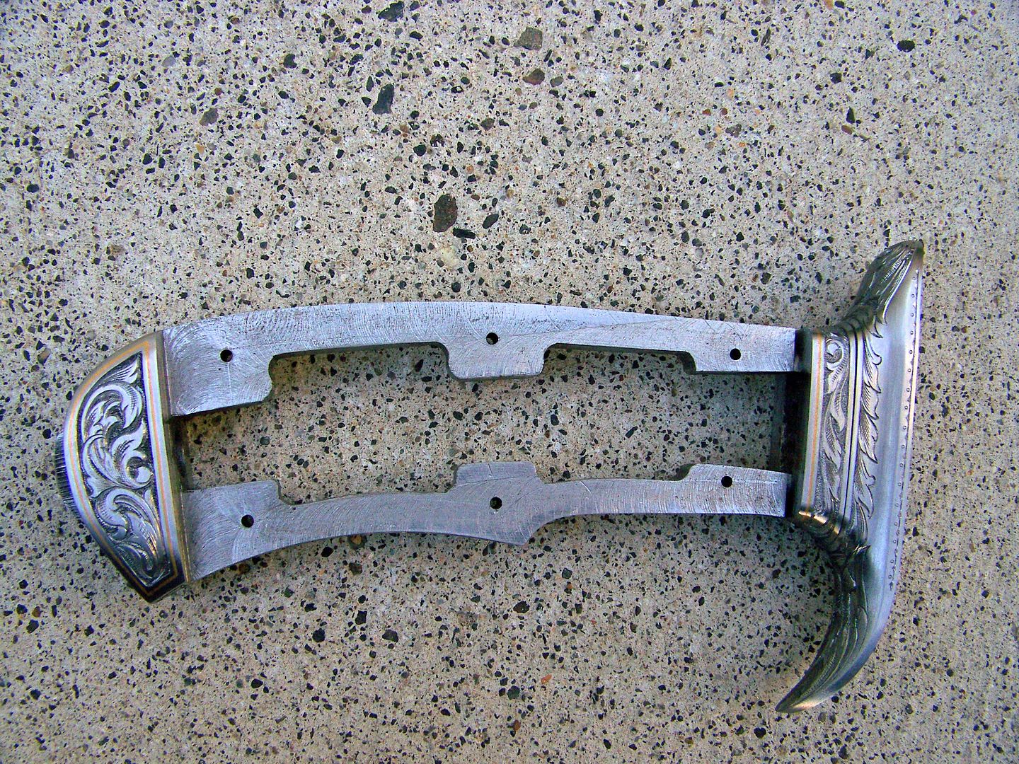

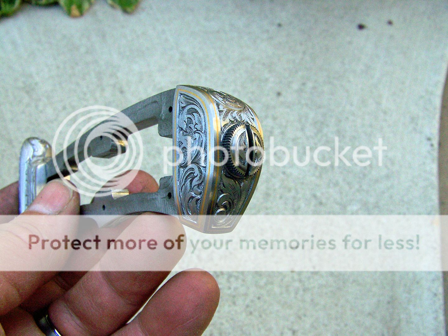

Jere has the engraving finished and Kevin sent the finished parts to me. Today they arrived. My vocabulary cant do his work justice. He is a master engraver and he took our bowie just as serious as a Edmund Davidson knife. Thanks so much Jere, its beautiful!
The next step is to fit a set of Culpepper dyed stag scales to this frame and send all the engraved parts off to Doug Turnbulls for their magic. They will color case harden them and in a couple weeks when they get back a decision will be made as to whether to remove the color or to leave it as is. The idea of color case hardening is to make the shell of the steel very hard and wear resistant. Removing it will leave the dark colors in the low spots and highlight the tops to a high polished silver aka "French Grey". Either way, I'm excited to see how it looks when it comes back.
The detail is difficult to pick up in photos as the relieved backgrounds haven't been inked as it would burn off in the 1400 degrees required for the color-case hardening process.
