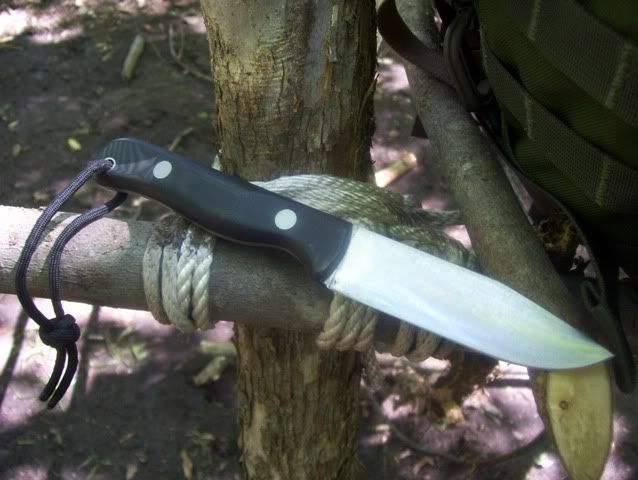

GOSSMAN 4" MINI-TUSKER IN A2
Specs:
Blade Length: 4" from tip to front of handle
Handle Length: 4.25"
Blade Thickness: 5/32"
Blade Width: 1"
Blade Steel: Kick Ass A2 Tool Steel
Black Linen Micarta Handle by Greg Haugh of Lone Rider Grips
Sheath: JRE Bushcraft Style
This small utility knife was my faithful companion during the last Basic Survival Course I taught at the Wilderness Learning Center. From stirring my morning coffee to battoning hop hornbeam ironwood, this blade did it all. A light stropping at the end of the week returned the edge to hair popping sharp and also brought back a glimmer of polished steel from under the nice patina that developed. The coke bottle contour of the handle gave it a secure purchase in my hand during the wet week. Using a longer lanyard with a diamond knot stopper, the mini-tusker became a field-expedient chopper for light duty use. The point, located almost in the center of the blade, made point first drilling a breeze. As for the grind of the blade, Scotts "70% flat and 30%" convex is a real winner. With his attention to detail, this little blade came out perfectly and handled every reasonable task without issue.
Don't hesitate to contact Scott about this one. It is my favorite Gossman knife I own and might be my new favorite knife overall.
