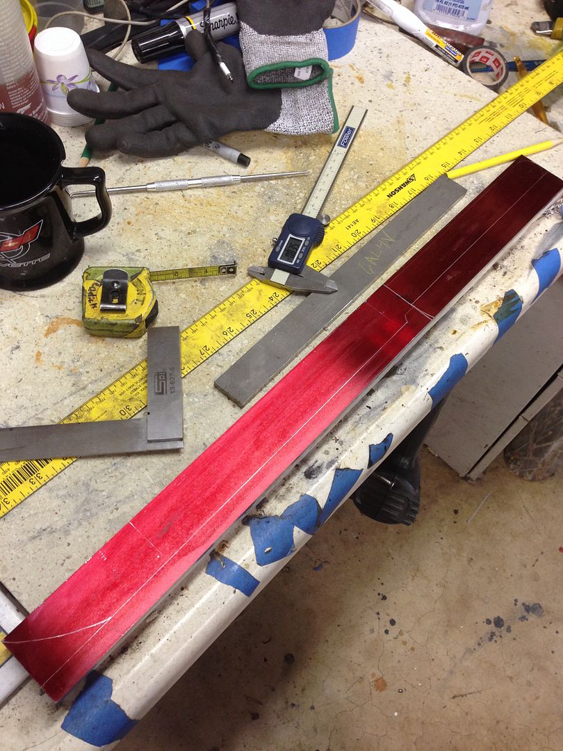

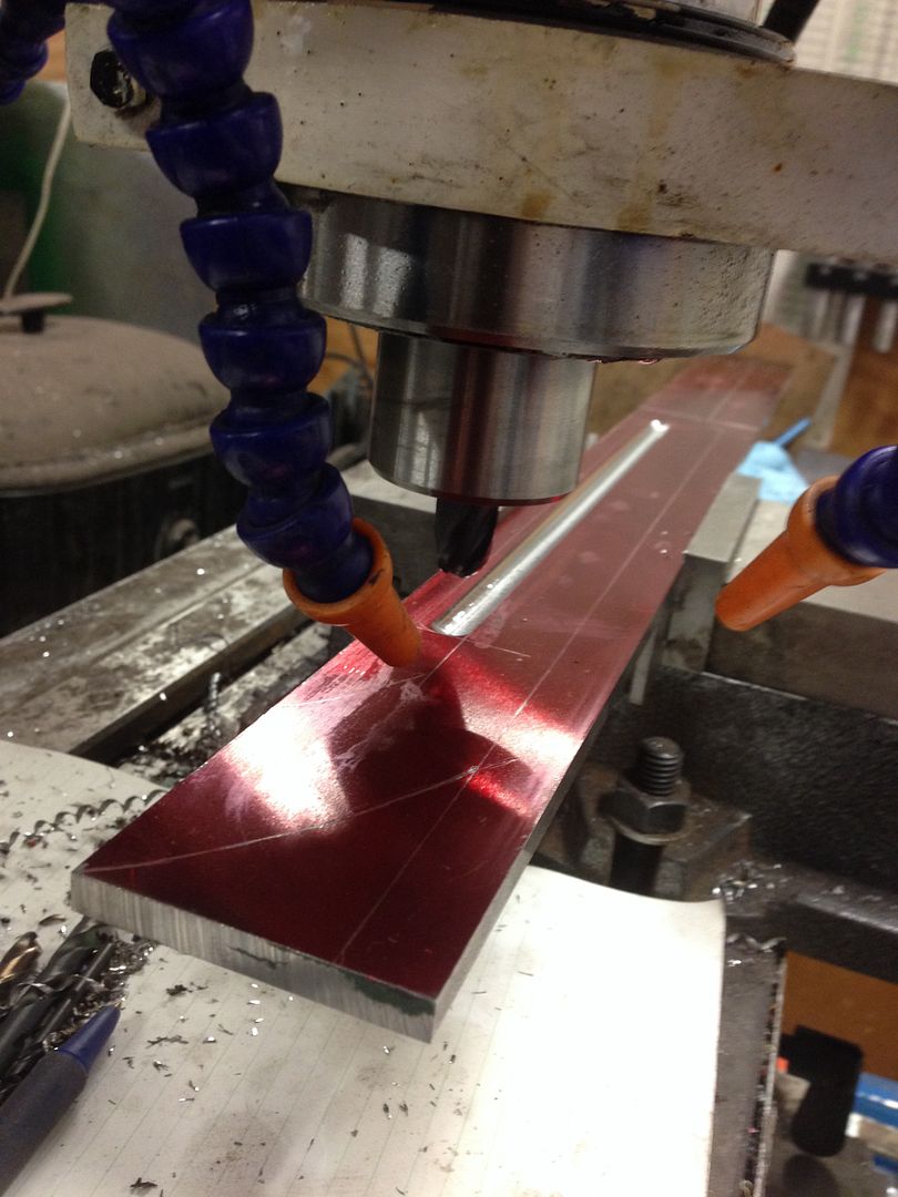

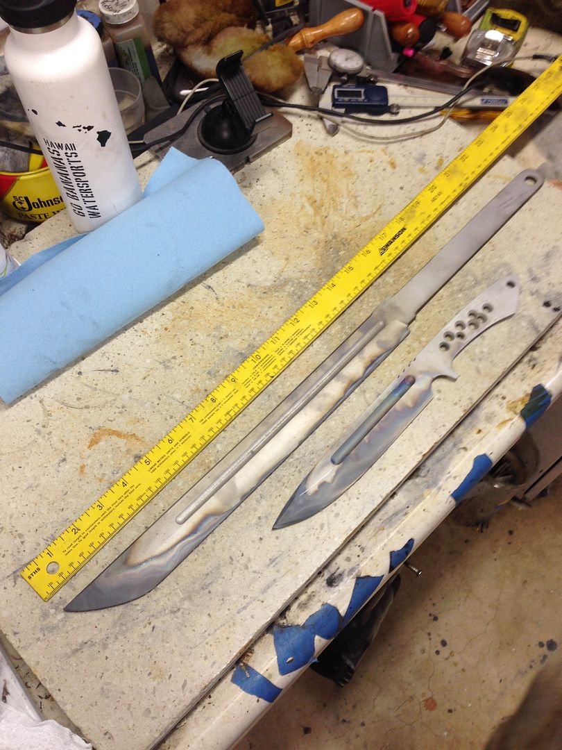

Laying out my design
Milling in the main fuller. I like to this before the blade is profiled, as it is easier to get everything lined up.
I also milled a false edge on the top of the blade.

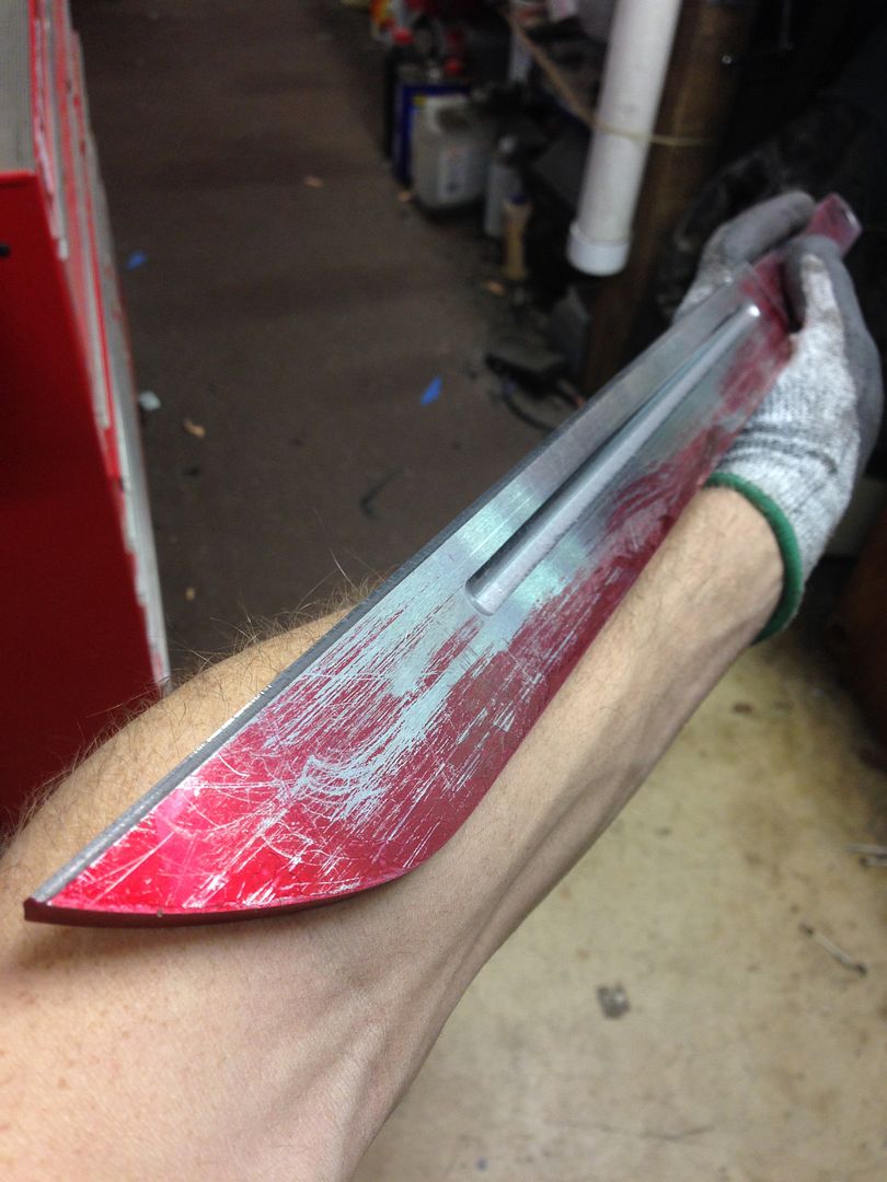

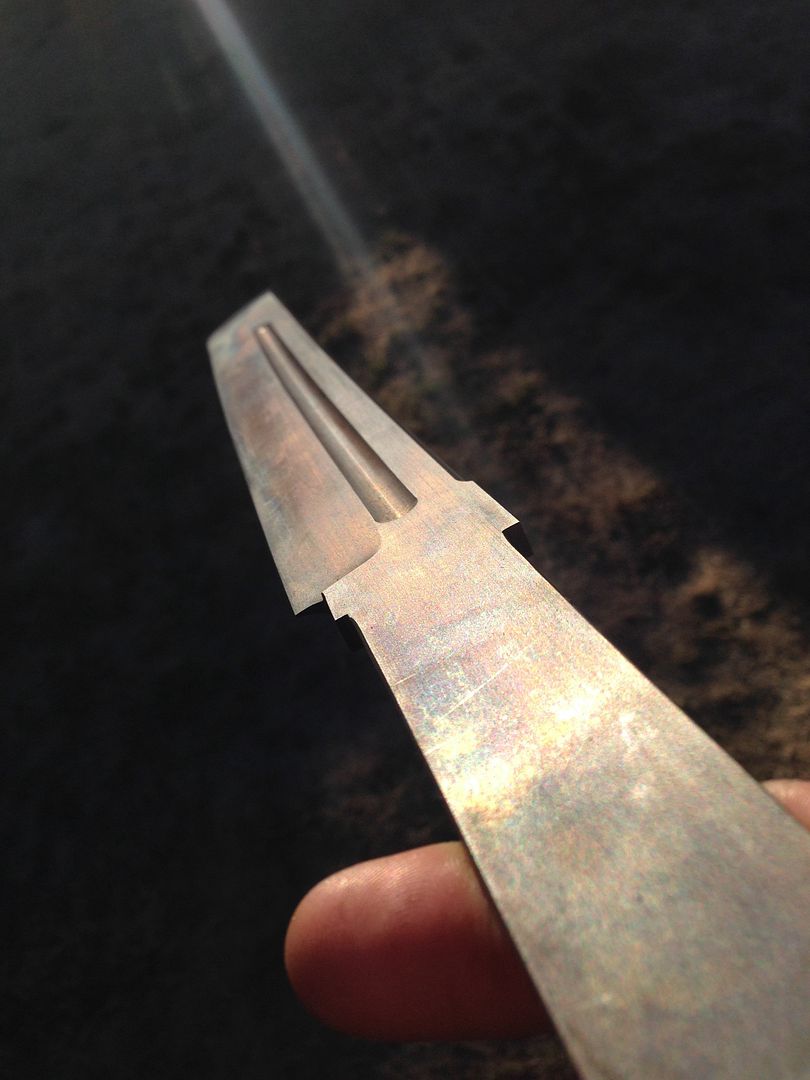

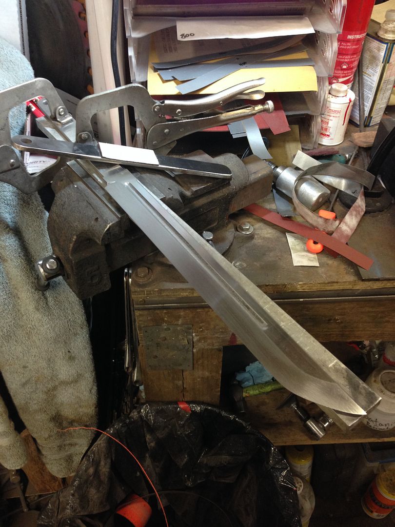

Here I have the bevels roughed in.
Squaring up the shoulders for the Guard.

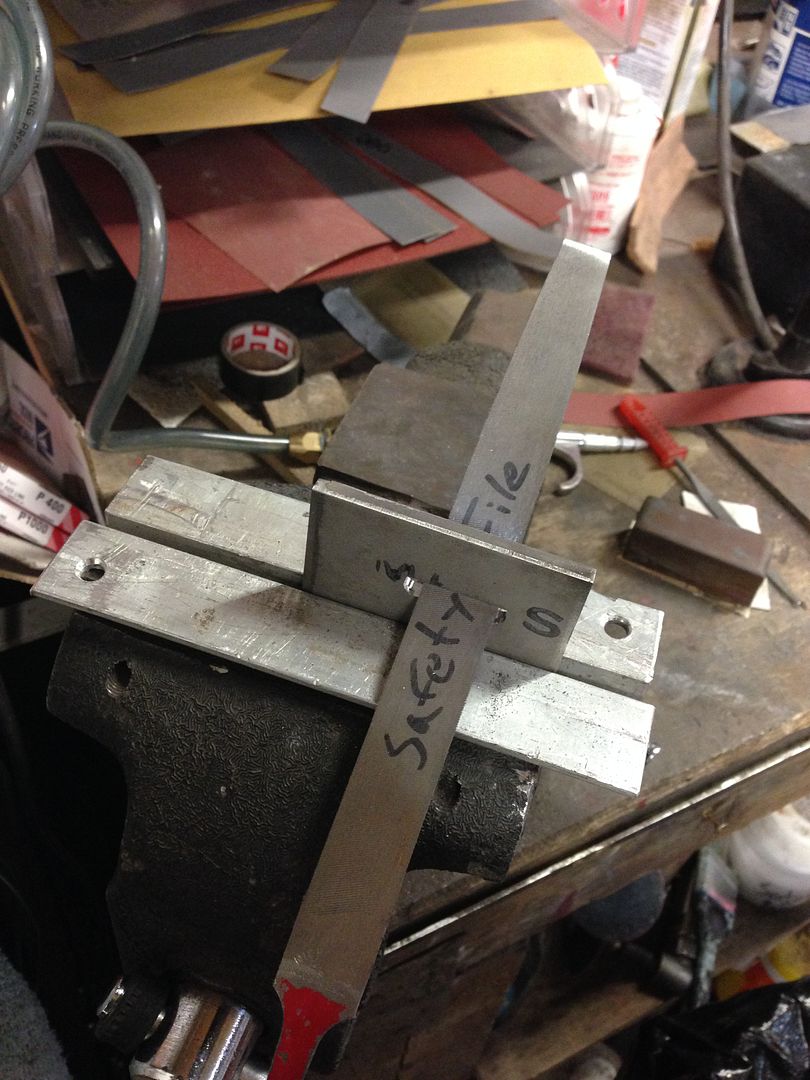

Truing up the bevels by hand. Since this is an air hardening steel, I can get the blade 95% before heat treat.

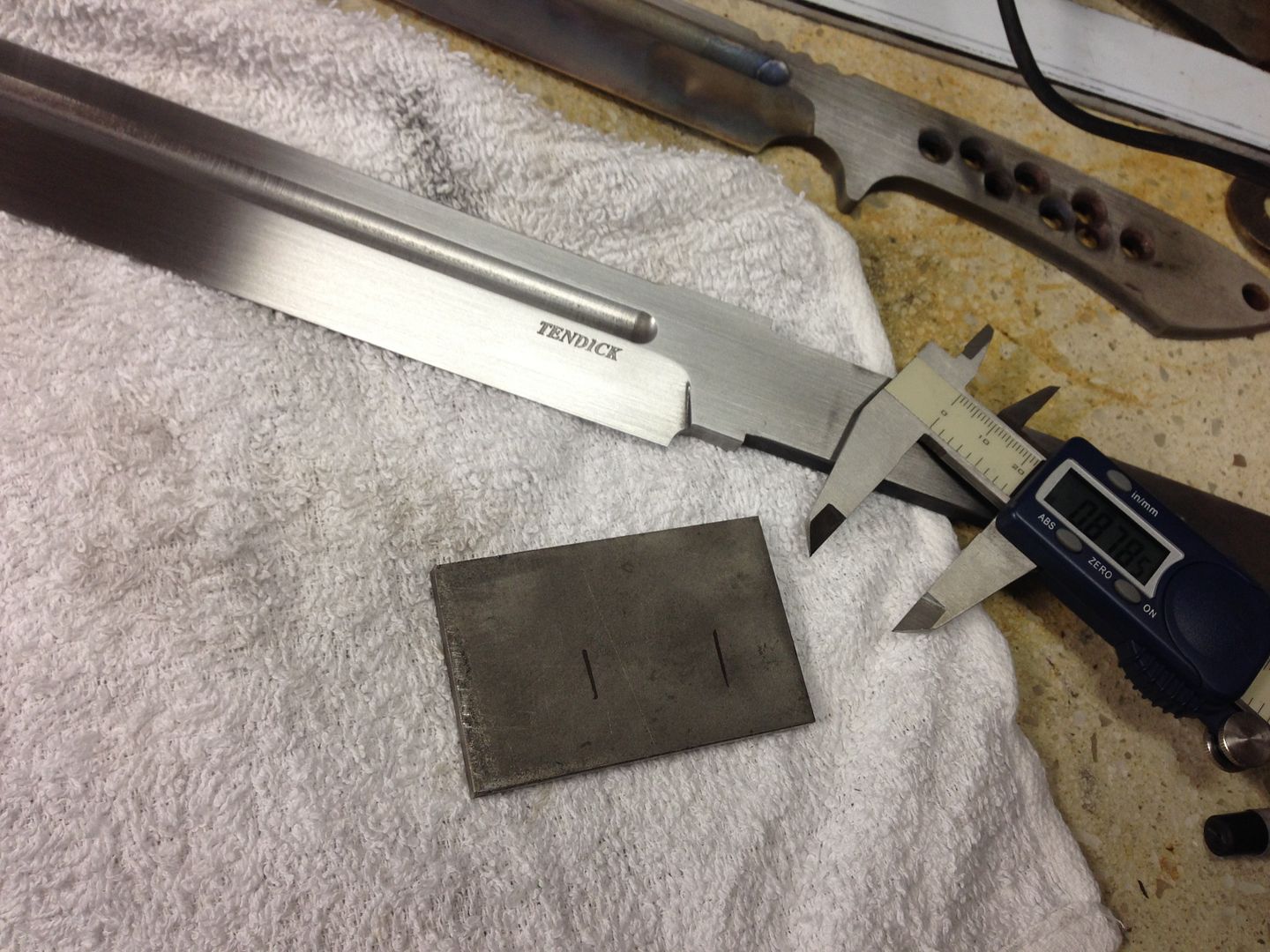

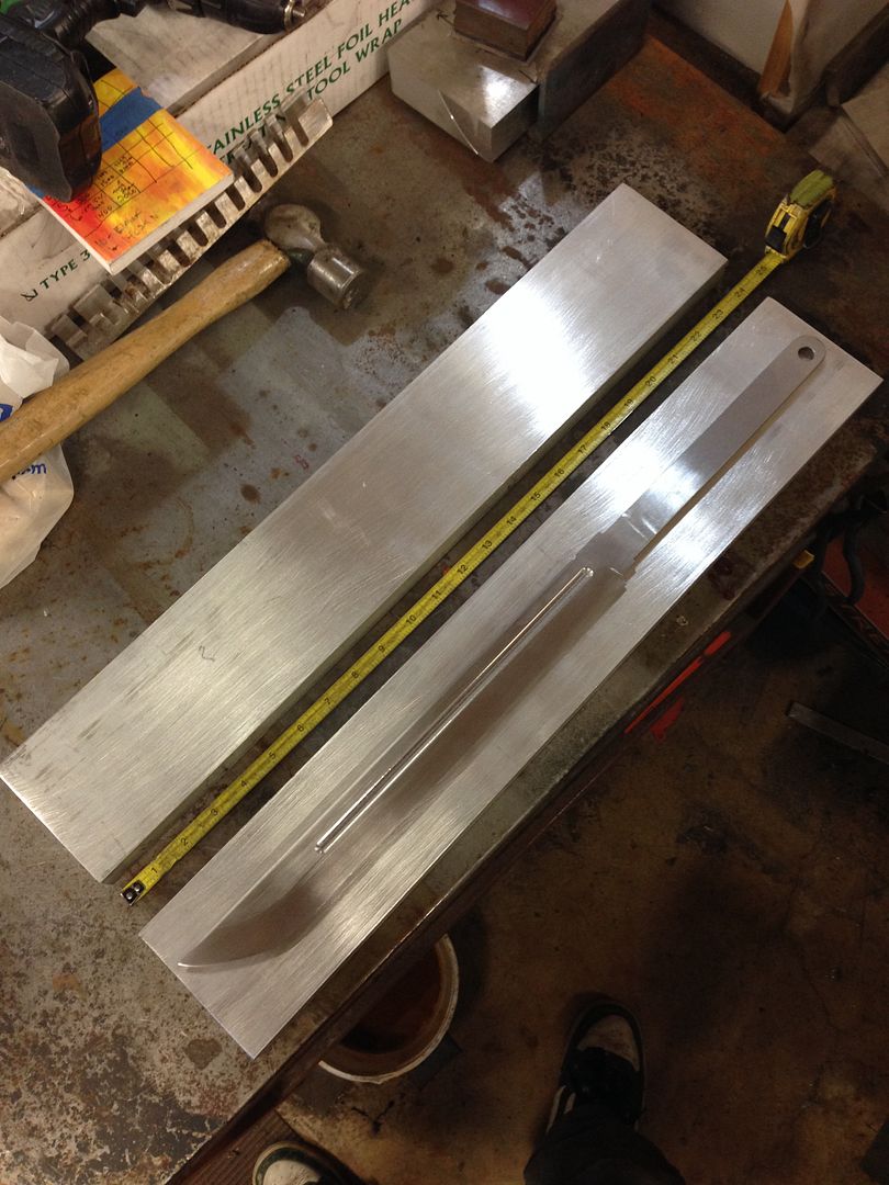

Had to pick up some new quench plates for this big guy. Not cheap!

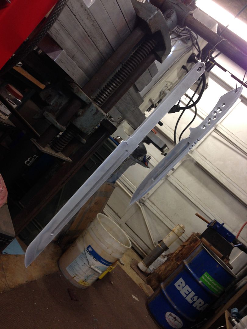

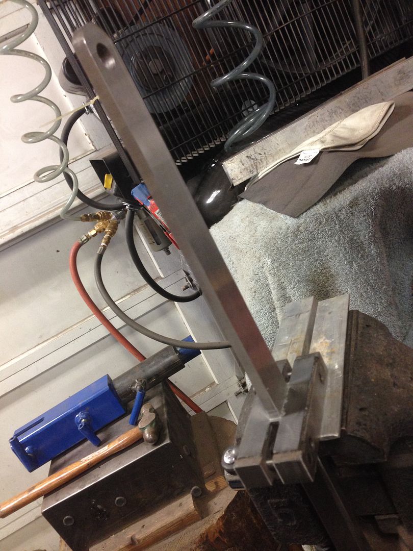

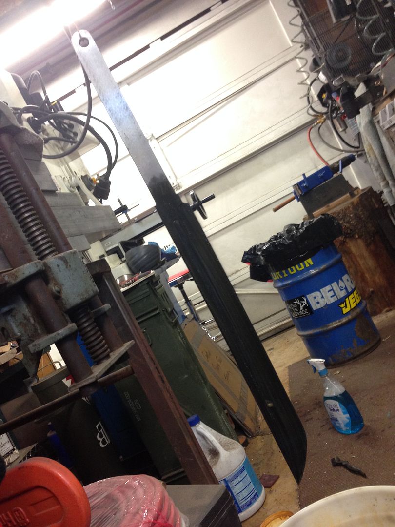

So here is the blade post hardening. It was sealed in a high temp stainless pouch and clamped between the aluminum plates to cool.
A2 likes a nice soak in Liquid Nitrogen immediately after hardening, here it is after the soak, coming up to room temp.
Normally surprises during HT are bad. Much to my delight though I got a nice one.
The blade actually developed a bit of Sori during the quench. Pretty cool!

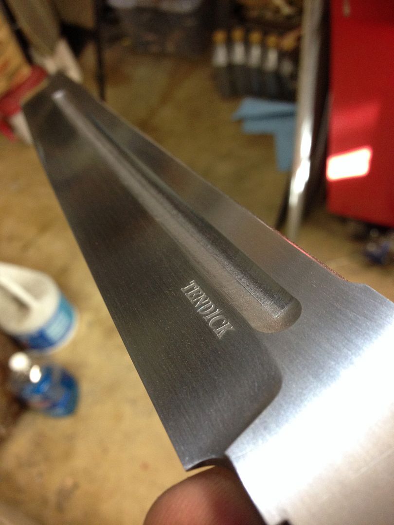

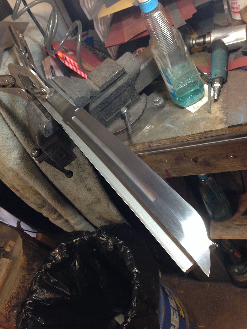

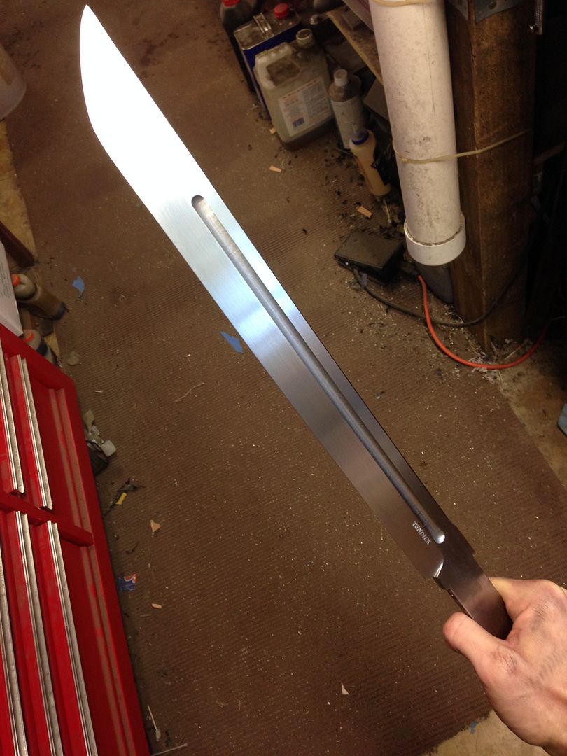

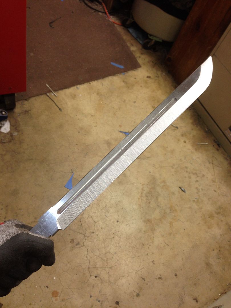

The blade all cleaned up and ready to mark.
Nice deep mark.
Another shot of the blade all cleaned up and marked.

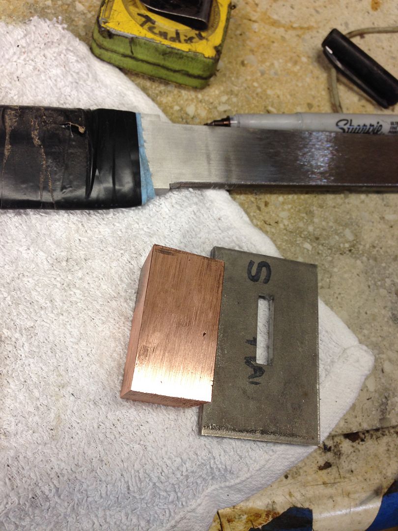

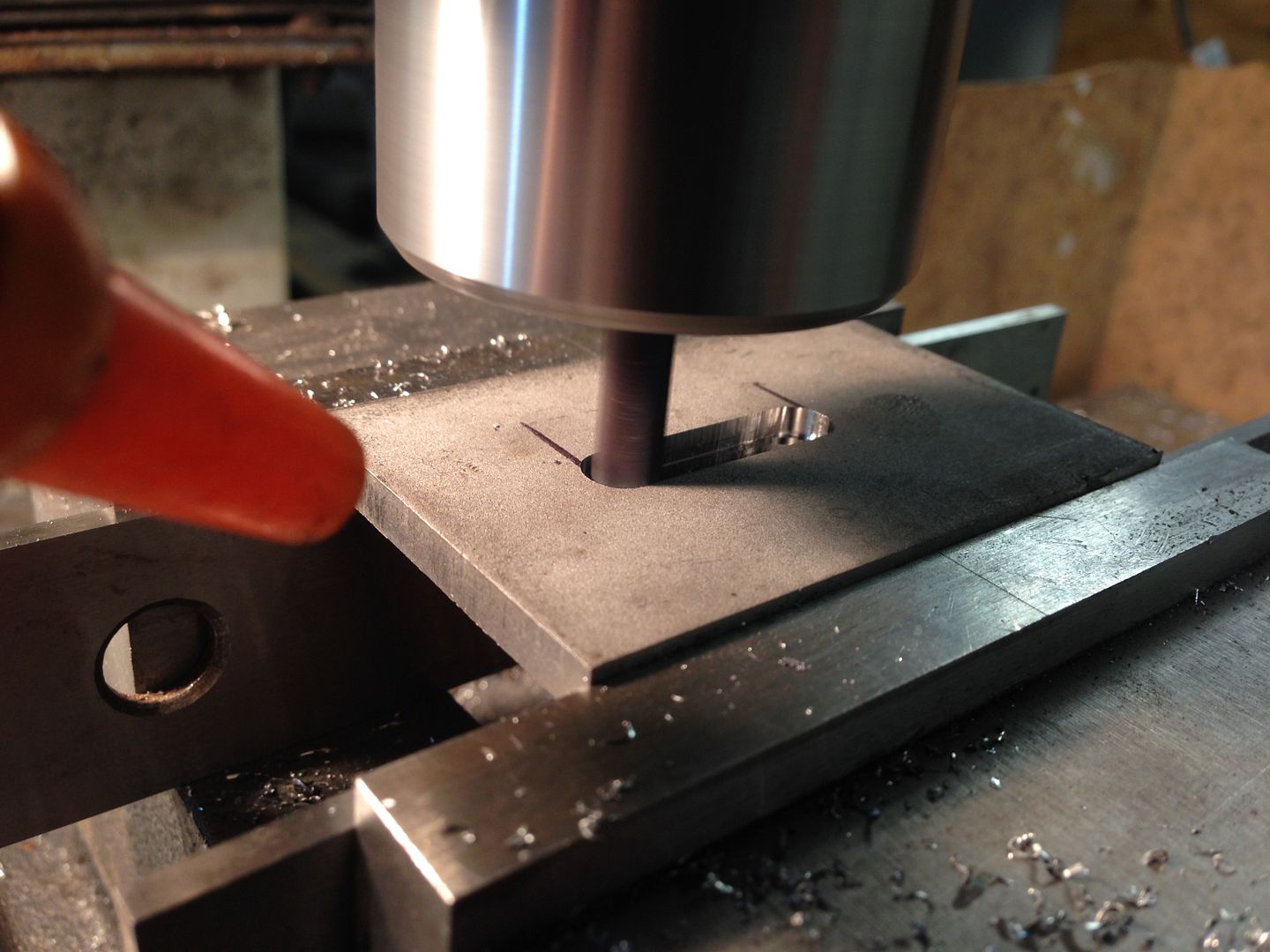

I decided to go with a titanium Guard on this guy. Laying out for slotting.
Milling the slot in the guard.
Squaring up the opening on the slot. I like to use a file that I have smoothed the faces on. This way I only remove material where I want to.

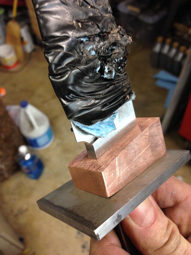

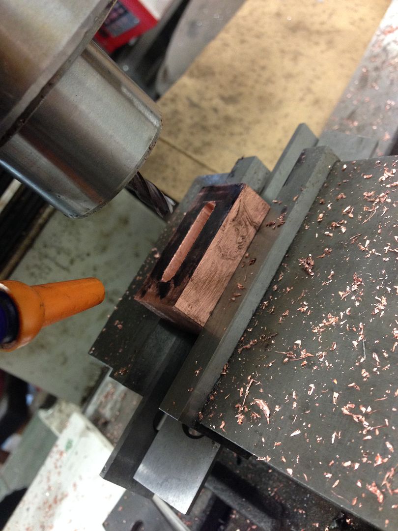

Thanks to Steven kindly pestering me everytime I post a Japanese inspired piece without a habaki, I decided this would be a good piece to try my hand at making one. I wanted to do it a little different though. I decided to machine the habaki from a solid piece of copper.
Milling the slot in the top. This will slide over the ricasso and rest against the blade shoulders, just like a guard.
Here is the habaki and guard rough fitted.

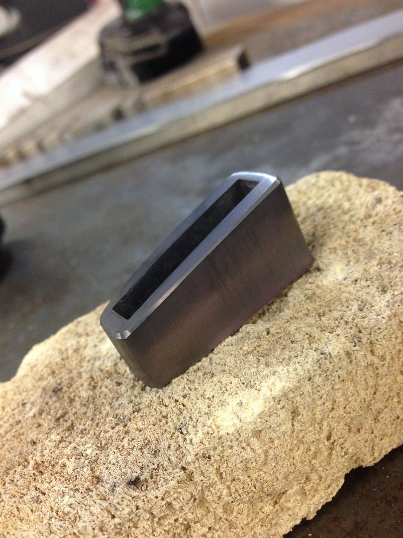

Here is the copper Habaki all shaped. I decided to give it a nice heat coloring.

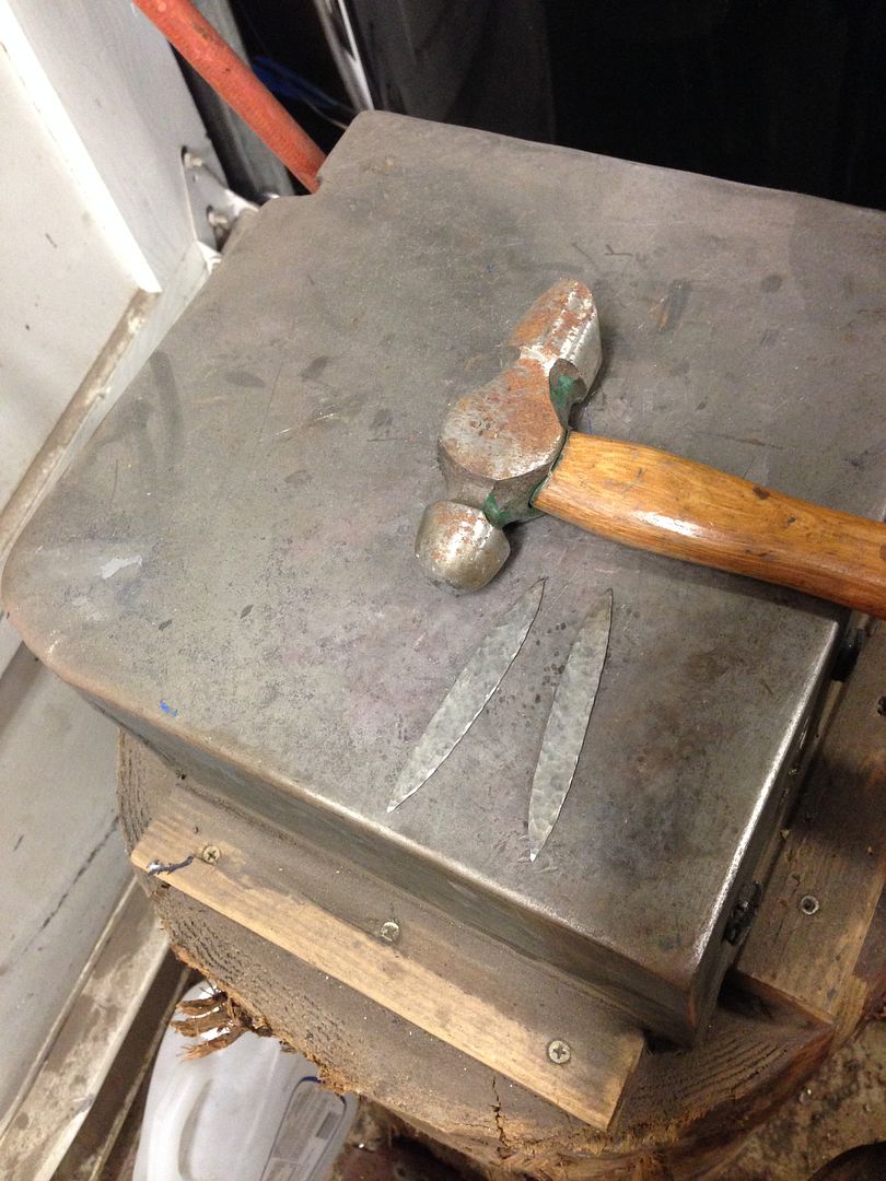

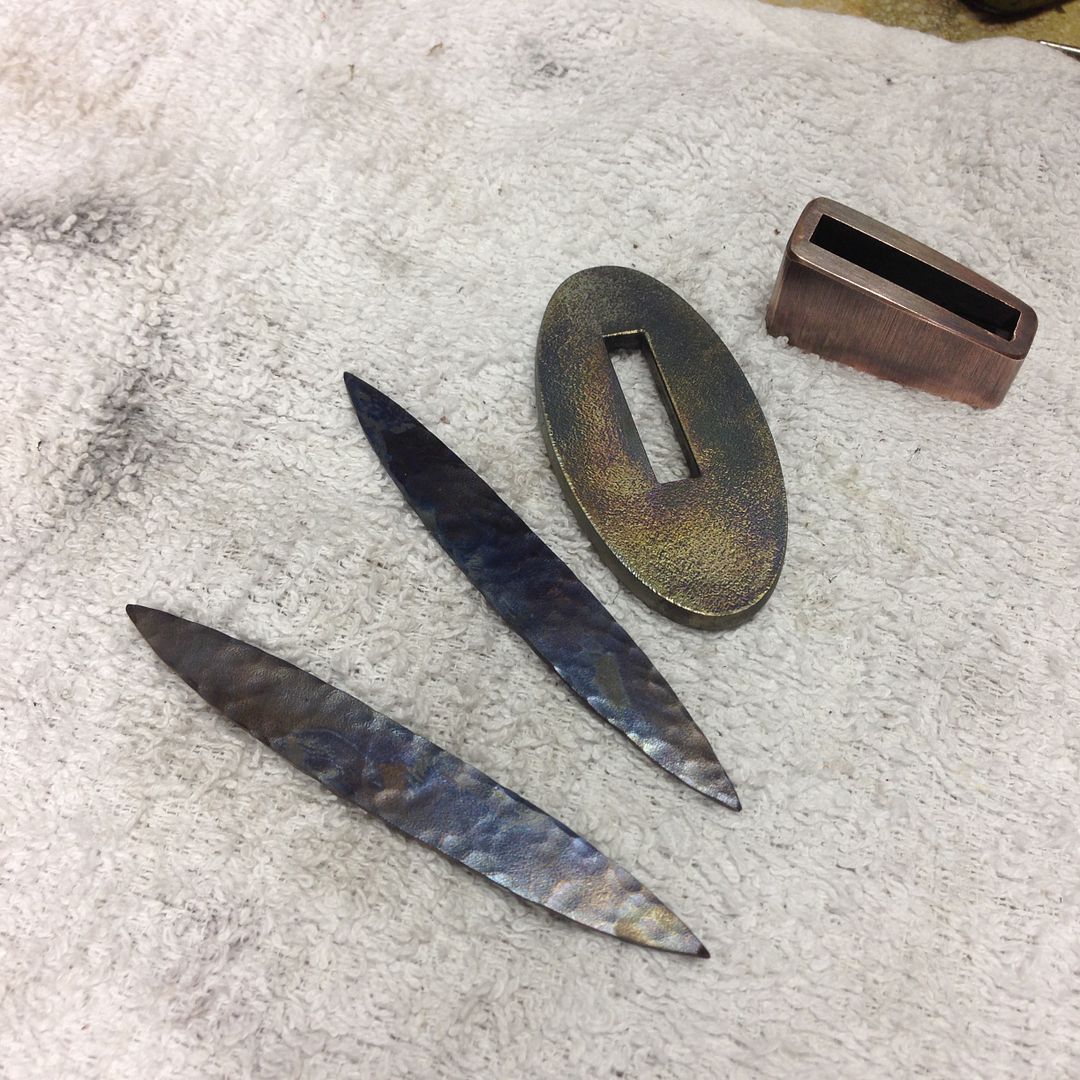

While the blade was aging, I decided to make a couple titanium menuki's. I figured I would give them a hammered texture and a "diamond" shape reminiscent on of stingray skin.
Here are all of the fittings ready to install. The menuki and Guard are Titanium and heat colored.
