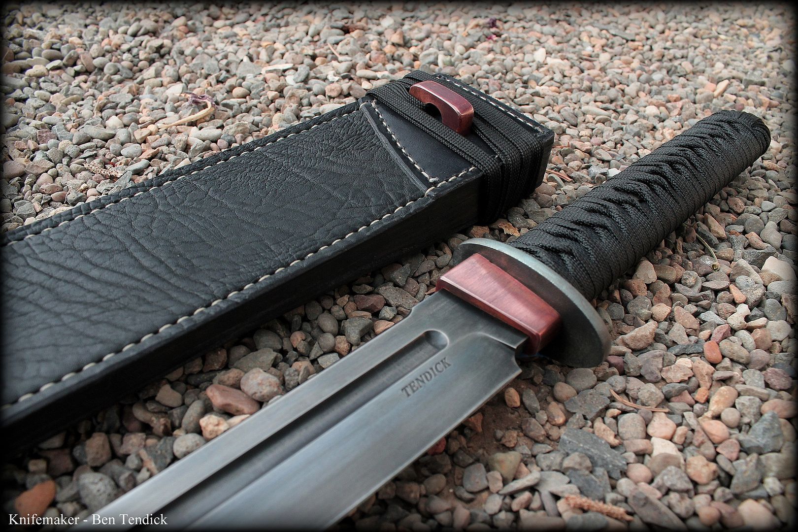

Thanks Dan! I just finished it up today. Here are some pics showing how I did the handle.
The fittings were a press fit, but it set them permanently with JB weld.
Here it is all ready for the handle
The handle is basically a hidden/full tang handle. I put leather pieces under the grip for extra thickness. I use contact cement to attach the leather.
Here is a simple little handle wrapping jig/hinge that lets me clamp the blade in place and flip it back and forth while wrapping. It is super handy.
Normally I would use sting ray skin under the Ito wrap. But I wanted a different look on this piece. So I did an under wrap with bamboo fiber cord.
Here is the Ito Wrap started and the first titanium menuki in place.
Finishing up the wrap. My fingers are pretty sore at this point!
All wrapped up. The Menukis are staggered for a right over left hand grip.
At this point, it is complete! I want to take better pics, tomorrow hopefully. I am also working on a special sheath for it, and I will post more pics when it is done.

May I ask what you used to produce the antique effect on A-2, and how fine you sanded it before the treatment?
It had a 220 grit hand rubbed finish, and then I went over it with a red scotch brite pad. The antiquing process is the cold blue/bleach method. There is tons of info on it in the knife makers discussion, so I won't go into major details.

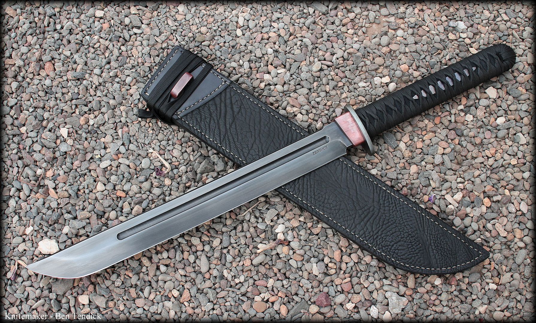

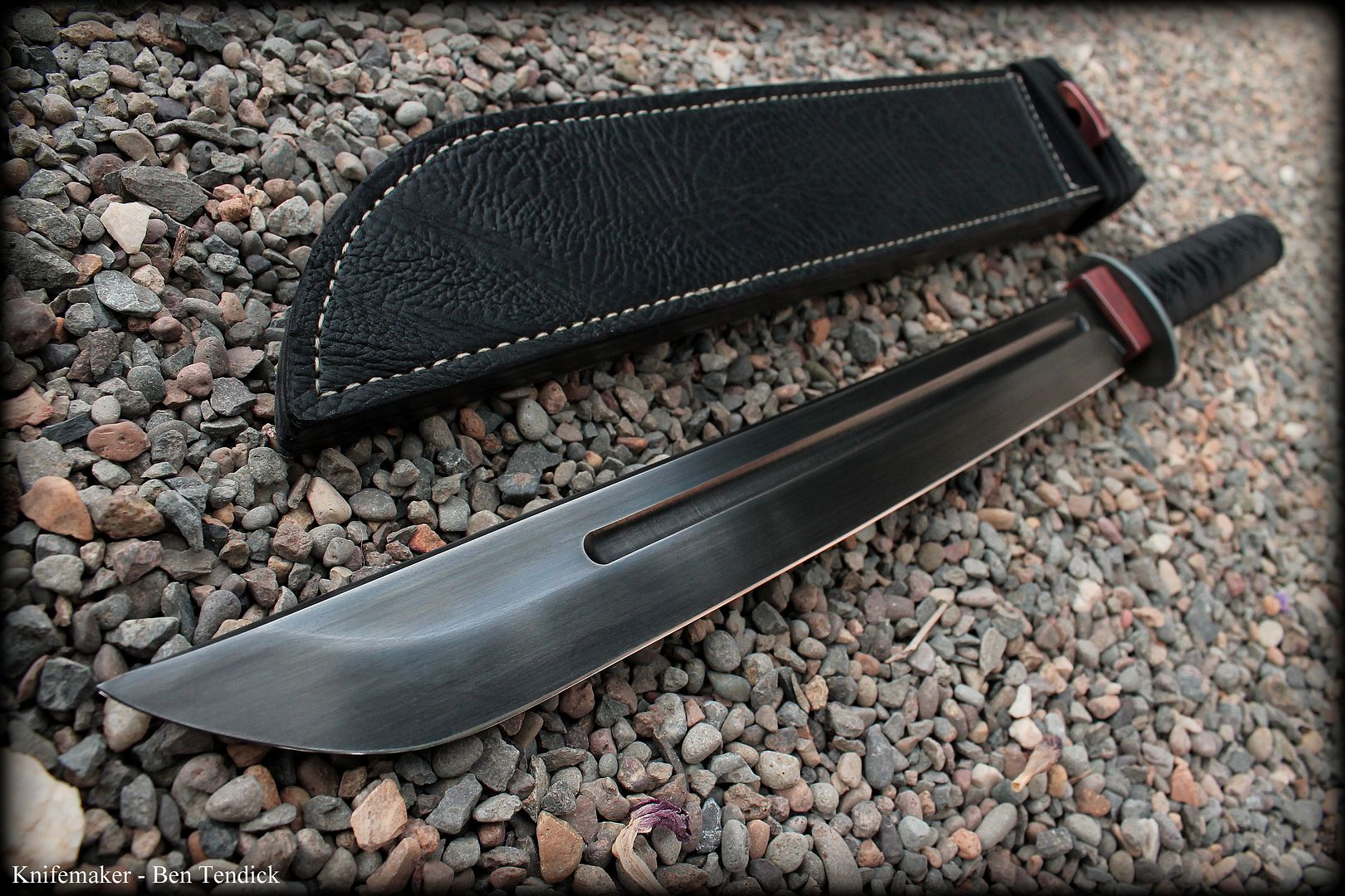

Ok guys I spent all day working on the sheath, and I just wrapped it up. I know some people would prefer a more traditional saya, and some people like leather, and others kydex. So I made a combo of all 3! : )
I decided to incorporate a traditional style Kurigata as the belt hanging feature. It also has a layer of kydex on the front side of the blade, so the blade draws quickly and smoothly from the sheath. These are both things I have never tried before and am quite happy with the results.
Anyway here are some pics from the sheath making process. Keep in mind it is entirely hand stitched.

Ok Everyone, here are the final pics. Although not the most exotic or fancy blade I have done. This overall package is by far my most favorite I made since I started making knives a few years ago.
I stepped outside my box on several new things with it, and learned quite a bit from it.
