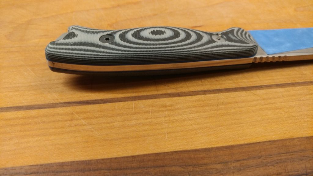

I spent about 20 minutes shaping the handle with various belts on the WSKTS, and another 15 finishing up with papers, scotch-brites, and polish.

AFTER getting the scales & liners on there just fine, I went for my walk (2.5 miles with a 20lb pack) and did my taxes (everything but the medical expenses - wife went to sleep, and it's her area of expertise) I started over on the tang, 80 grit on up to 800, followed by gray then white scoth-brite, and Flitz buffed out with P3000 tri-zact. Transition should be smooth as silk now.

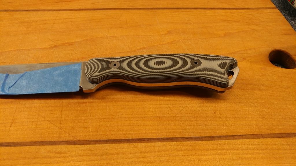

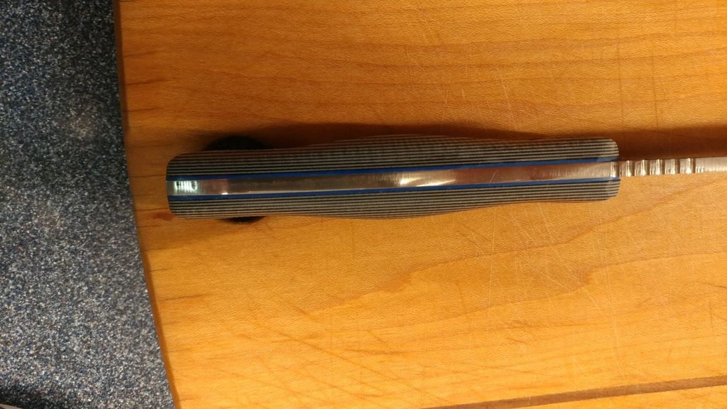

Pics are finally up!
This was before I re-flattened the tang. I have also gone back over the liners at the "beak" and 2 protrusions at the back to smooth 'em over and make 'em flush.
Scales fit up:
And here's the tang flattened and re-polished to get rid of the little bevel:

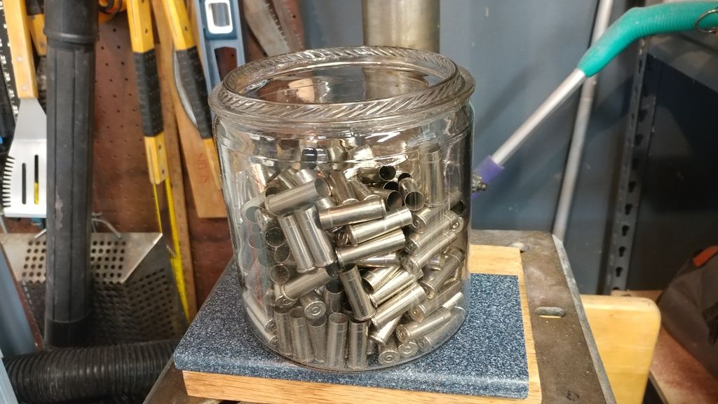

They've already been washed in soap and water, soaked in acetone, and thoroughly dried. Mostly Remington 38spl - a small percentage are .357mag.
My kids haven't been drinking much gatorade, so I may need to get creative on the tumbler.

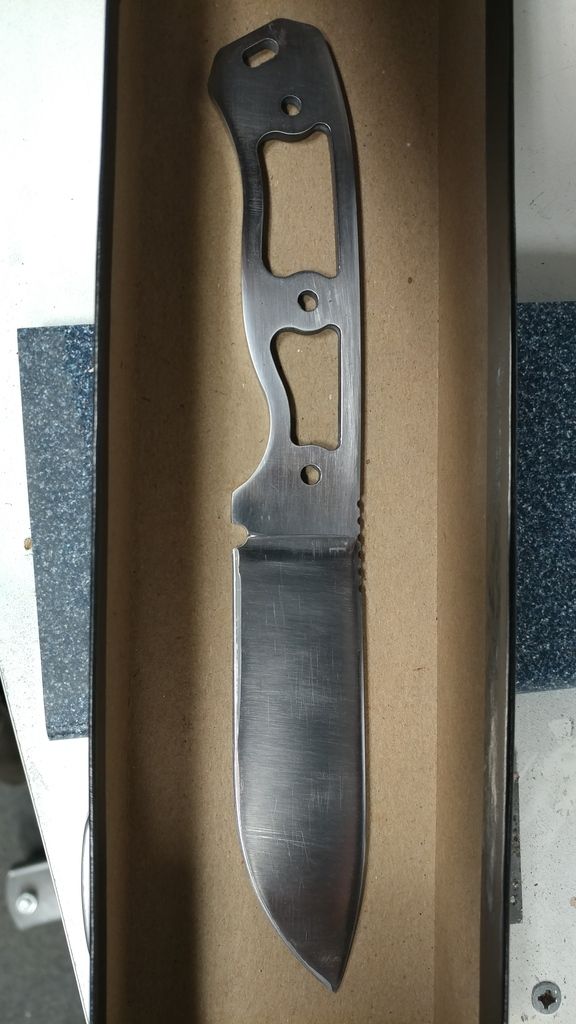

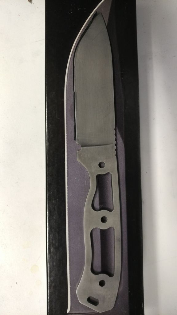

I spent another hour re working the blade just like the tang. Still not mirror, but more even and I'm happy with it. Currently in the acetone bath getting ready for resist.

Anyway, here she is, all cleaned up and ready for the chemical treatment. Closed up the box to keep the nasties out until I'm ready to go.
If possible, and not in the bath yet, wipe the blade down with rubbing alcohol prior to acid etching.
Acetone can leave an oily residue, and the alcohol will remove that.
Though the acid shouldn't be affected by the small amount of residue on the blade, I just want to see you have all opportunities to get a clean etch.

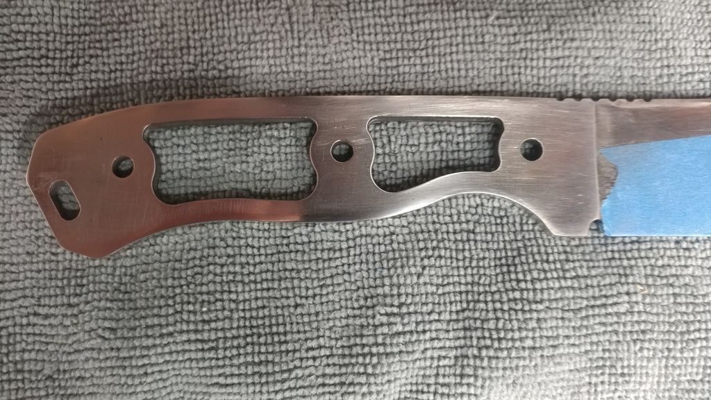

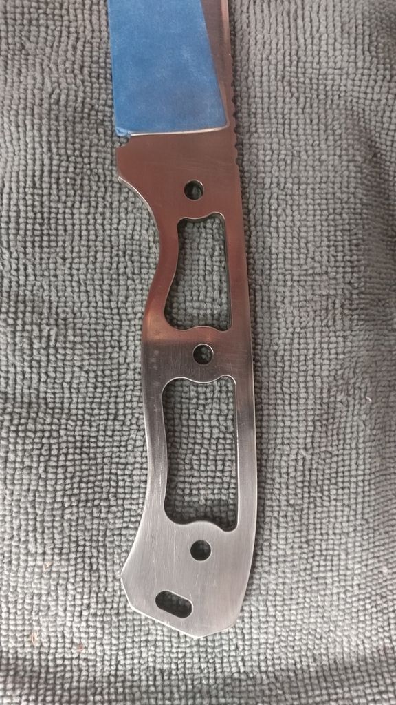

Managed to get it etched.
Sat about 12 minutes in the acid bath. Put in hot water for a minute. Rubbed down with gray scotch-brite. Back in the acid for 6 more, into the water, then rubbed down with water/baking soda paste using a white scotch-brite. Then rinsed the heck out of it.

Home safe and sound, and back to work on this one.
Cleaned it up with mineral spirits, acetone and denatured alcohol.
Rubbed down with~1000 grit white scotchbrite.
Taped off the edge.
Also got some 3" ABS to hold it all.
A little big for the dryer, so it's STILL a work in progress.
All those cases filled the tube to just about 50%.
Sprayed a ton of WD-40 in there.
Now I just need to shake it up for 15 more minutes.
Going in 5 minute intervals so I can get other stuff done, and my arms don't fall off.
