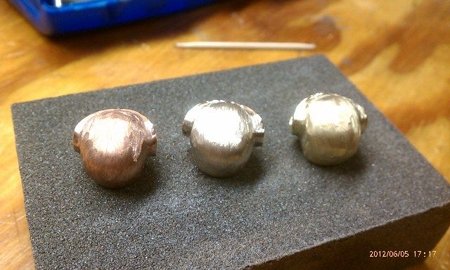

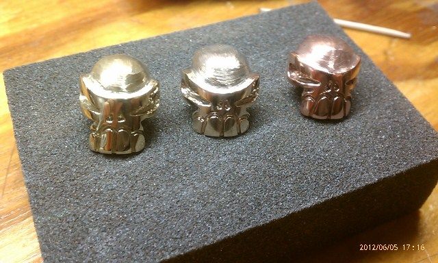

Brass, Bronze, Copper

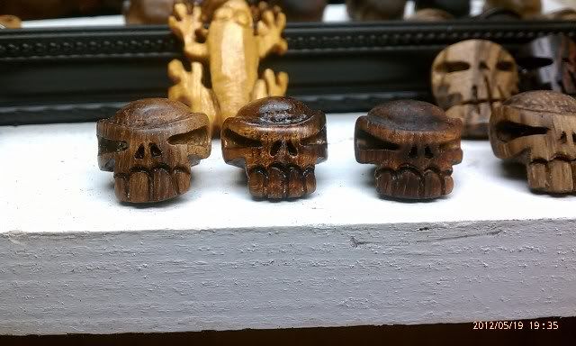

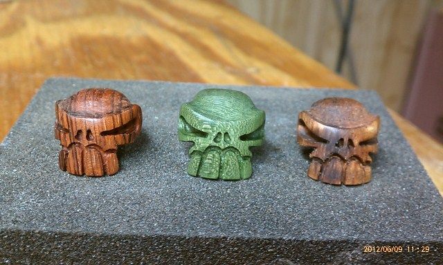

A few wooden ones! All Koa wood.
Bolivian Blackwood on a Boker Gnome.
A few more wood varieties. Zebra, Burmese Rose x2, Cocobolo.

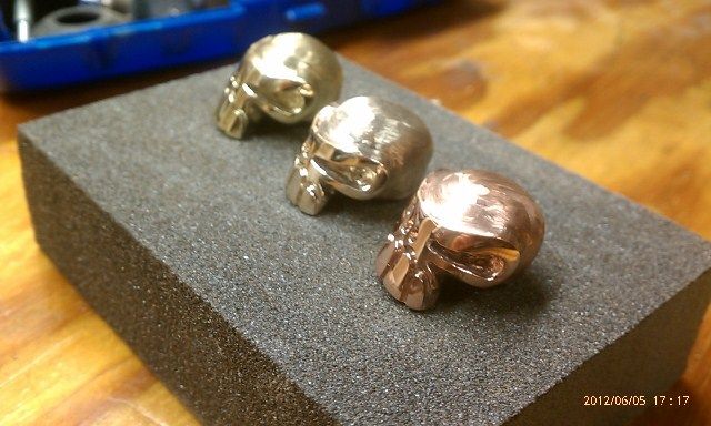

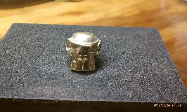

Thanks for the compliments. I decided to try Copper and Bronze too. They turned out really well, though the Copper was a lot harder than I expected. From left to right, Brass, Bronze, Copper.

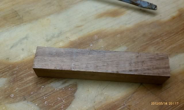

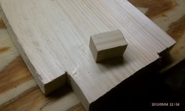

Initially I started with scrap wood from my son's karate class.
With the more exotic woods, I use pen blanks from a local wood shop. Premium Koa pictured below.

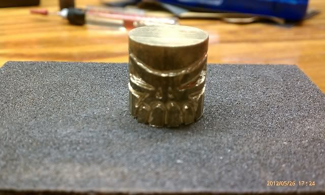

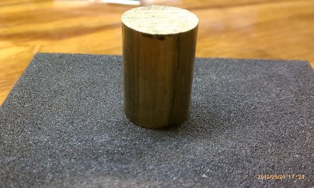

From there I round the square block to round. I draw a skull pattern and begin sanding and cutting. Below are a couple brass pics initially from 3/4 round stock.
Here are a few Tiki building shots.
Tools include a dremel and tiny, tiny engraving cutters. A lot of sand paper too. There are other pics on EDCForums.com and CPFMarketPlace.com for those interested.

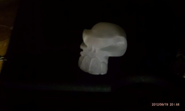

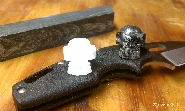

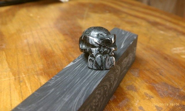

Check out these two new ones! The first is a M3 with a silver base. Basically it is a silver and resin composite. It polishes to a brilliant finish, will patina dependent on the base metal, and is chemical resistant.
The second in Opal Acrylic. A semi-transparent/milky white acrylic. The face is also polished though you can't tell in the pics. It reminds me of a ghost! :D

By far the metal is the hardest to do. I would suggest you practice a design in wood first. The round stock I got from old scrap at work. It is 3/4 inch. You can check McMasterCarr for pieces. Wood is pen blanks to start. Everything can be found on the Internet. The most expensive to make is probably the copper and brass. The copper is the hardest metal to carve, followed VERY closely by aluminum.
