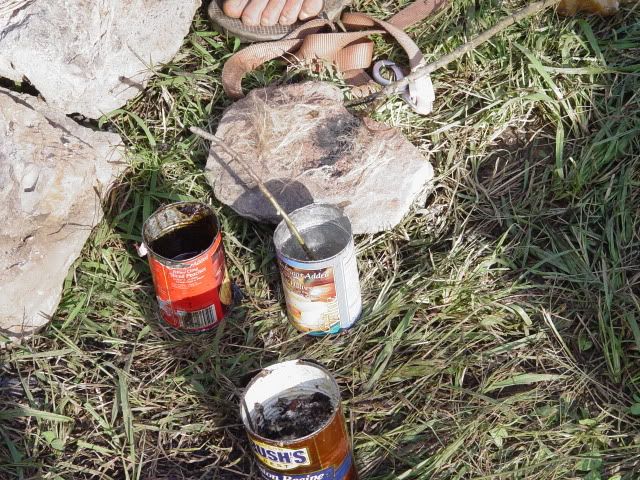

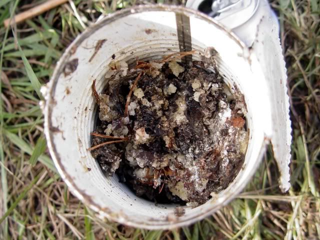

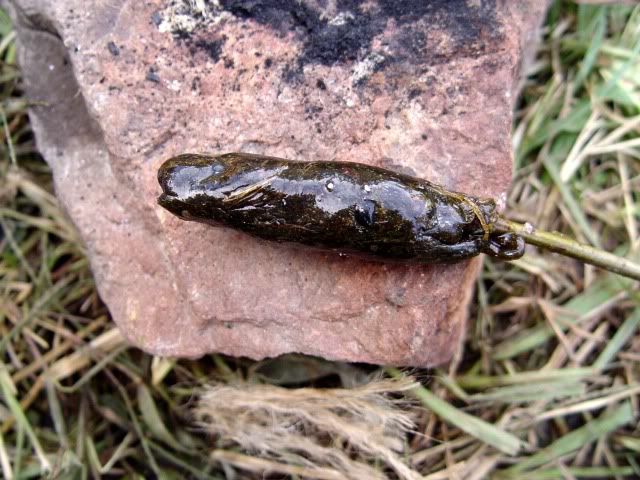

The dry herbivore scat is nothing to really worry about when touched. It is essentially ground up grass. Ungulates (deer, sheep, etc.) leave scat in the path of travel in little pebbles that dry fast in the summer, so it is easy to find as I travel via deer trails and such. I don't ever use scat that is so old that it is a moldy powder that disintegrates to the touch.
It serves to add flex to the pitch, and helps with bind, like straw to adobe clay bricks. It also gives more body to the mix.
You only have to beware of respirating the scat powder when grinding, just as you have to beware of respirating the pitch as you make it. Best to do outside.
You can grind up dry grass to serve the same purpose, but it has to be finely ground. Hence the herbivore scat, as the animal does all the work for you.:D
As I mentioned in the original post, there are other substitutes that could serve the same purpose! :thumbup:
