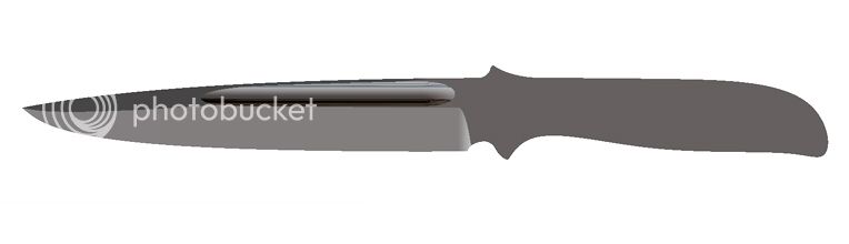

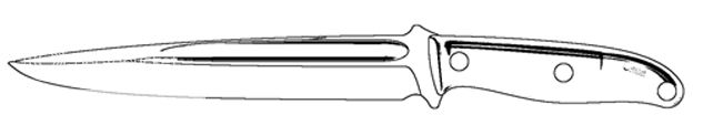

My design process starts with hand drawings and is initially based upon intuition and experience where I figure out what I think I want on paper and then scan that into the computer for further development. I’m almost always wrong about something at this point in the process. In this case I got the handle all wrong.
I’m tracing it with NURBS geometry where I make further refinements. When I started it looked like this:
The blade is designed as a stout stabbing weapon similar to a WWII era bayonet with a beefy point and deep fullers. There is a thumb ramp (in the wrong place initially) and a substantial finger coil behind the guard for safety, and the proximal end is also shaped for thumb placement when held in a reverse grip.

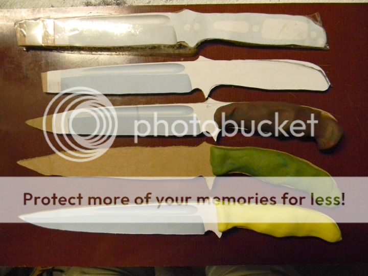

I cut out the preliminary design in cardboard and immediately found problems with the grip. I don’t like how it “points” in the hand (when gripped it kicks out to the side at an angle), the grip is too tall in the meaty part of the palm and too long for a solid reverse grip because the thumb has too far to reach. I make a couple tweaks to get in the ball park and then move on to playdough models.
There is a point here I’d like to make. Too many knives are made with handles that just look cool, or are easy to make, or are simply laid out to use a convenient bar of steel without enough work being done to optimize the shape of the handle for the tasks to be done and for the human hand. Sometimes the grip becomes an oversight.
Handle some of the knives made by folks like Bob Loveless and a lot of the ABS guys and you will find there is a reason they don’t look like broom handles. And I have a cool trick for you so you can back into that design very easily with just cardboard and modeling clay. Seriously, you need to try this.
It is an iterative process. First you cutout your preliminary design in cardboard and layer the grip with clay. Pass it back and forth between your two hands, squeezing on it as you do so. It will eventually start to take on an idealized shape, and it will reveal where your tang profile is wrong because the material will be pulled away from the tang where you have tang where it shouldn’t be, or built up in places where you need to add material. For a knife of this nature requiring three specific grips there are some compromises to be made in the geometry, but you can get something that is pretty dang good in all three, and all you have to do is look at the playdough. These are some of my work in progress models:

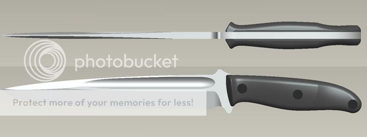

Once I had the handle right I modeled it in CAD.
First as a relatively faithful copy, then as a somewhat simplified version that captured all of the significant dimensions and geometry but looking a little less like a constipated cat turd:
With the scales modeled I was able to calculate my weight and balance in the CAD system and start working on skeletonizing the tang and moving some meat around to balance the knife.

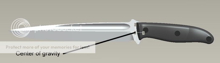

Balance and weight:
It is possible to have two knives of identical length, weight and center of gravity that behave very differently in the hand based upon mass distribution. As the mass moves out towards the extremities of the knife it resists changes in rotation. Also, because one end can not rotate around a center without the other end also moving around that center, a weight such as a pommel on one end resists movement at the other. Through this mechanism, a pommel doesn’t just balance a long or heavy blade, it resists deflection and adds power to a cut through the conservation of momentum. This little blade I’m making doesn’t really need a real pommel, but the tang certainly doesn’t need to be overly skeletonized down on that end either. This blade would be an extremely poor candidate for a tapered tang unless I were attaching some form of counterweight to compensate.

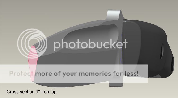

The handling of a fighter benefits from a light tip, however taken to an extreme this is at odds with the tip strength needs of a modern tactical knife. I’ve chosen to start with a .250 blade thickness and I’m carving away unnecessary weight with deep fullers and a swedge that creates distal taper past the fuller. The blade that I have come up with is .180” at one inch back from the tip and has a pronounced diamond shaped cross section.
I’m skeletonizing much of the tang but leaving it solid at the very end for balance.
According to my calculations the end result once the scales and hardware are figured in is a total weight of 12 ounces and balance across the “guard” in a package just under 13” total length and .250” thick at the ricassio. In my opinion this is very good so I’m done with the design and ready to start building it. It will be interesting to compare the final results with these calculated values.
I’m not telling you all this just to impress you with my awesome knife balancing-fu. Nothing I’m doing here is at all novel. Most experienced knifemakers do this, either through intuition, experience or trial and error, but it doesn’t usually just happen by itself, some thought has to go into it.
So to sum up, I’m making every effort that I can to make this a tough tactical knife that is still reasonably light and lively. I’ll end this part of the discussion here because I know I’m going on a bit about an esoteric topic, but I felt this particular topic needs more discussion around here so that’s my .02. Moving on to the good stuff, the next post (in a few days) will be cutting chips. I’ll talk about speeds and feeds and stuff…
