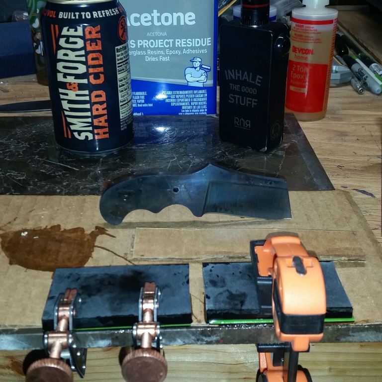

I got the last of my stuff for the jig today. Now just to assemble and get steel.
I have flat bar and sheets of basic steel for welding. I been thinking of just giving bit a go with that to see how straight my lines are and try some different things.

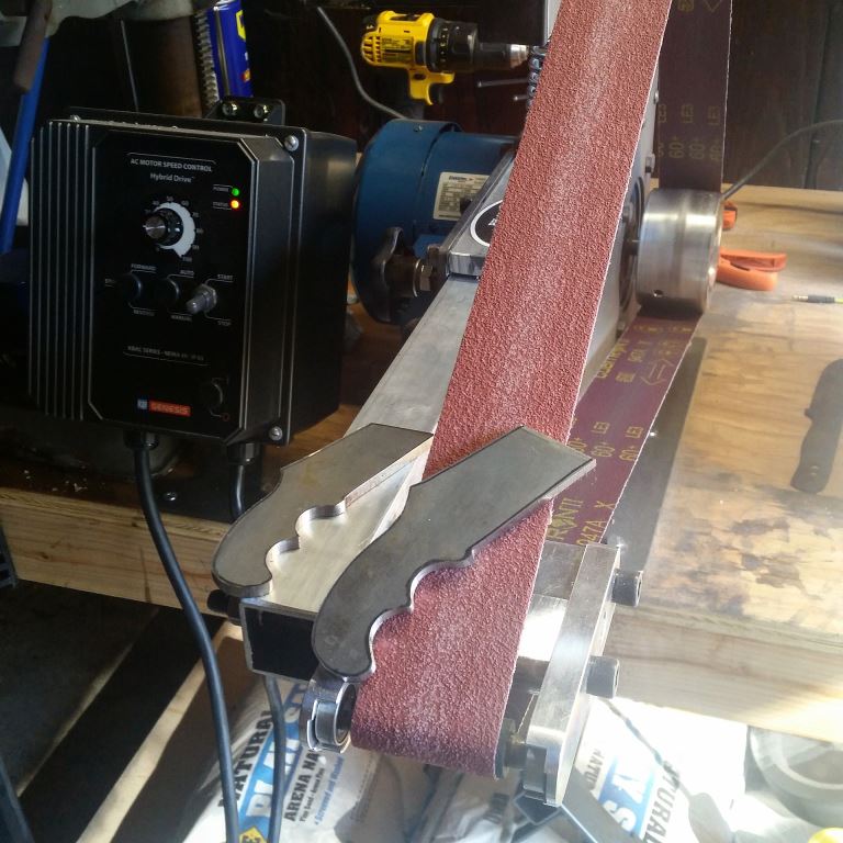

Definitely calling it practice at this point and there's no giving up here. Going to try to get a few more cut and profiled this weekend. Might not have enough life in the one 40 grit Cubitron I have to do grinds on more than 2-3.
Is it worth even trying to grind bevels with a 60 grit Cubitron II belt?

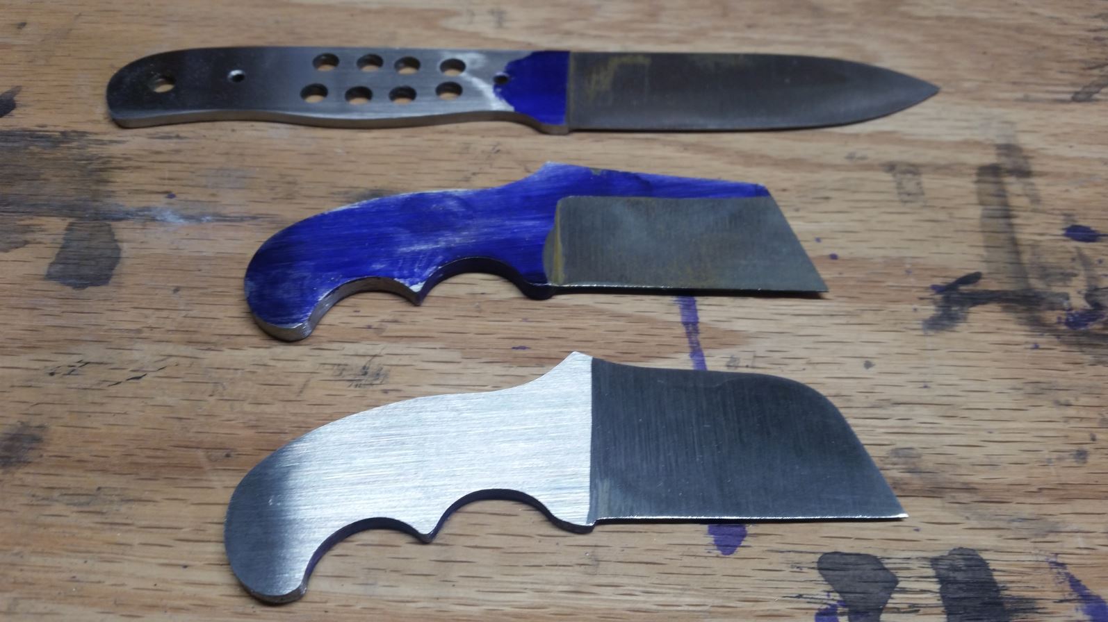

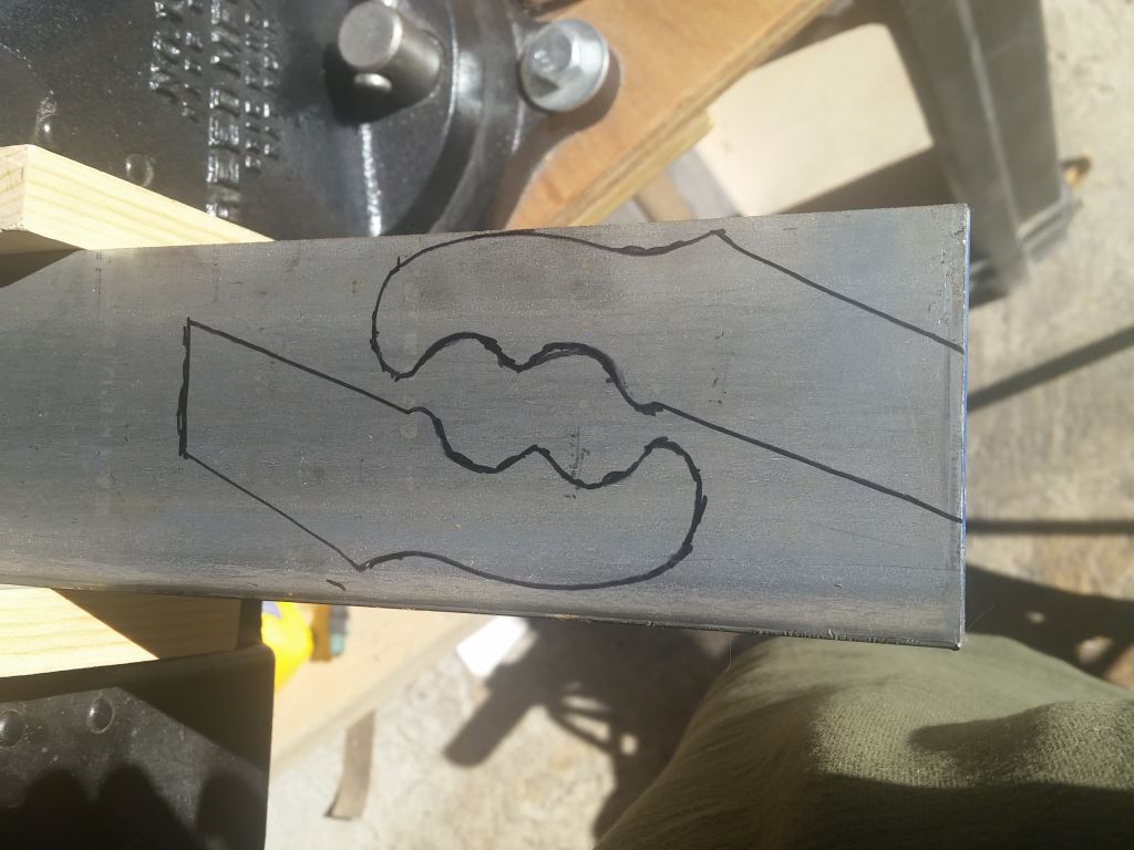

Cut out 2 blades from 3/16" 1084 from a drawing I did a number of weeks ago. Small enough to get some good practice without using a ton of material.
1st one is a menagerie of mistakes and corrections. I did it on the flat platen and had a really hard time getting good grind lines. Part of which is because it's not a fresh belt. Not happy with it at all but I'll finish it just the same.

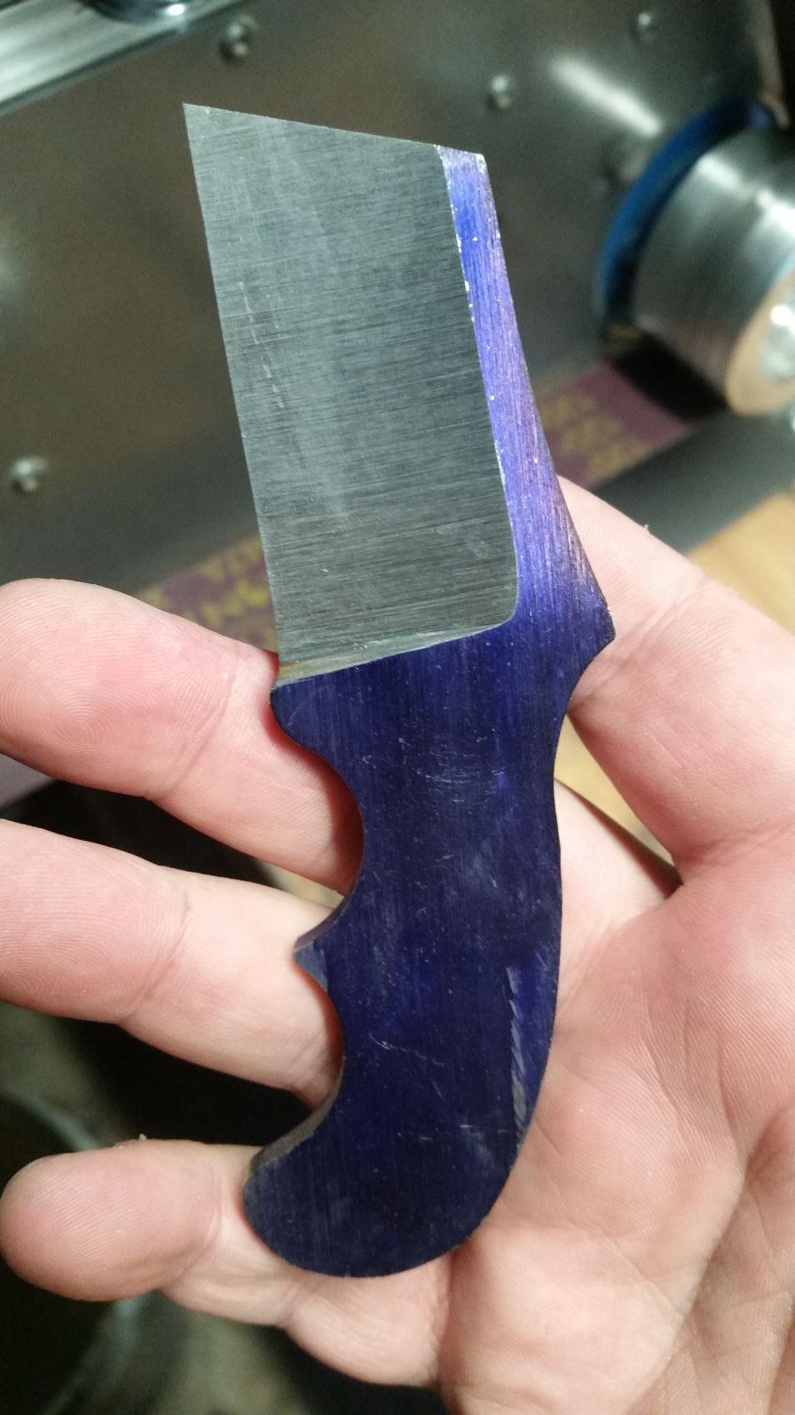

For the 2nd one I used the 10" contact wheel with the same dull belt. Holy cow! Sooo much more forgiving of mistakes on the big wheel. Honestly I think this design is better suited to a hollow grind anyhow. Pretty darn happy with knife #2.
Grinds are at 120 grit and I need to do some edge finishing to smooth things out before I drill pin holes.

Good work and a good thread. A couple of thoughts that may be of help. Might try using a 60grit or even a 90grit belt as you learn. They don't grab as aggressively as the coarser belts, particularly at the plunge. As you gain confidence, go to the coarse grits to speed things up a bit. I've never used a jig, but they sure look like a good idea to start. You can use a file to make a slight "dent" at the plunge line on both sides which will give the belt a place to bite and start your grind. Like Andy, I didn't have anyone close to watch when first starting, so had to make a ton of mistakes while fighting the learning curve. Just keep at it and have fun!
Thank you Rick. Thats some great advice that I will take advantage of. I've definitely cut back on belt speed to go a little slower since I started. Not too keen on using a jig but depending upon how much steel gets used in learning I may consider it. As masochistic as learning by freehand grinding seems to be, I really like the potential benefits it offers over using a jig. After all, both you and Andy are great examples that it works to learn that way.

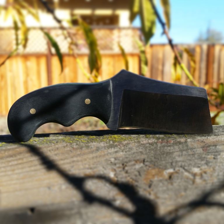

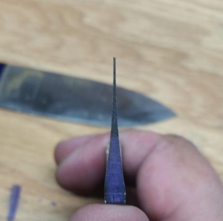

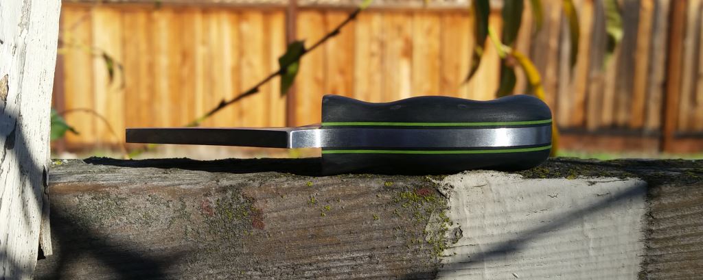

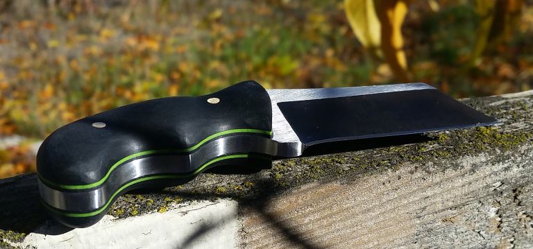

It's taken awhile for various reasons but here's the first knife essentially done. Overall I'm very pleased with the geometry, handle, and ergos, if not the slight warp I THOUGHT I escaped from during HT. It's subtle and shows up well on a flat plate if not so much looking at it in hand. I think I know why it warped... grind was a bit too thin and on one side the grind was a bit higher than the other. It's more of a twist so I couldn't bend it out. Lessons to learn from for sure. Improve my grinds and things will go better during HT and the rest of the process. The handle could use a bit more smoothing out with maybe a scotchbrite pad (don't have any atm) and the blade could use a little sandpaper smoothing. I may do that later but for now, I want to call this done and start cutting out a few more blanks to grind on. Thanks for reading and looking in this thread and on IG (@necrolicioius). I really appreciate the support, advice, and inspiration.
Warmest regards and Merry Christmas to you all,
Anthony
Looks great! I think you should call it the revolver. Have you got a chance to test it out much?
Thanks bro! It's funny you say that because because I've been thinking Derringer every time I look at it. I've hacked a bit at a 2x4 before the handle was on and it seemed to hold the edge ok. No chipping or rolling. I'd love to be able to know the actual hardness. 1084 tempered at 400 for an hour so it should be about 58-60. I hope. I'll try to get more testing done after refining the edge a bit.
