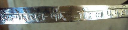

Here are 4 so-so quality photos of my gorgeous M43. Old hat to the older members, so forgive me for being repetitious. I throw at an average of 18 paces. With the fragile butt shape one needs to be careful and accurate.
