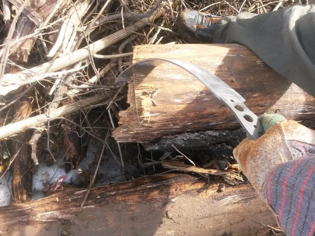

I make alot of hard use machetes from 52100 and they work great but I have been interested in using a stainless steel for people who live near salt water and want a hard use tool that is also resistant to corrosion.
I looked into steels like ELMAX and CPM 154 and a few others but for the most part the cost is just too high and there are still concerns with toughness and flexibility with stainless steels in long, thin blades.
Then I was introduced to AEB-L by Aldo. I did some further reading and was interested to see that it forms no chromium carbides and has enough free chromium to make it truly stainless. It seemed to me like it was more or less 1070 with free chromium.
After ordering up some .130 stock I made a machete and had Peters HT it to 58 at the edge with a spring tempered spine.
Now, I haven't done extensive testing with this steel but it really seems to perform like 1070....while also being stainless.
First test I wanted to make sure it wouldn't break in half on me so I stuck it in a stump and gave it a few good bends. It can do 45+ degrees easy and come back true.
I did some chops into frozen hard wood and the edge help up without a problem.

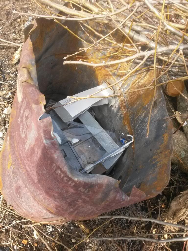

Next I chopped it through a steel barrel 6 times. I wish I would have taken a picture but it suffered almost no edge damage--really impressive stuff.
I will report back after more extensive use but this steel really seems promising for bigger blades that need to be stainless.

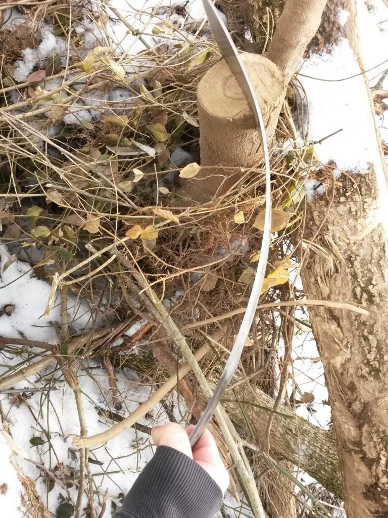

Did some more testing today. This is a really tough steel. I don't think it takes damage quite as well as 52100 but then again few steels do. It certainly behaves like a simple high carbon steel. If you asked me to guess what steel it was after my tests today I'd probably say something like 1060 or 1070. I think AEB-L is about as tough as a similar alloy content carbon steel.
I gave it a few really deep bends today and it came back true without issue. I actually got it near 90 degrees but had a hard time getting a pic of it one handed.

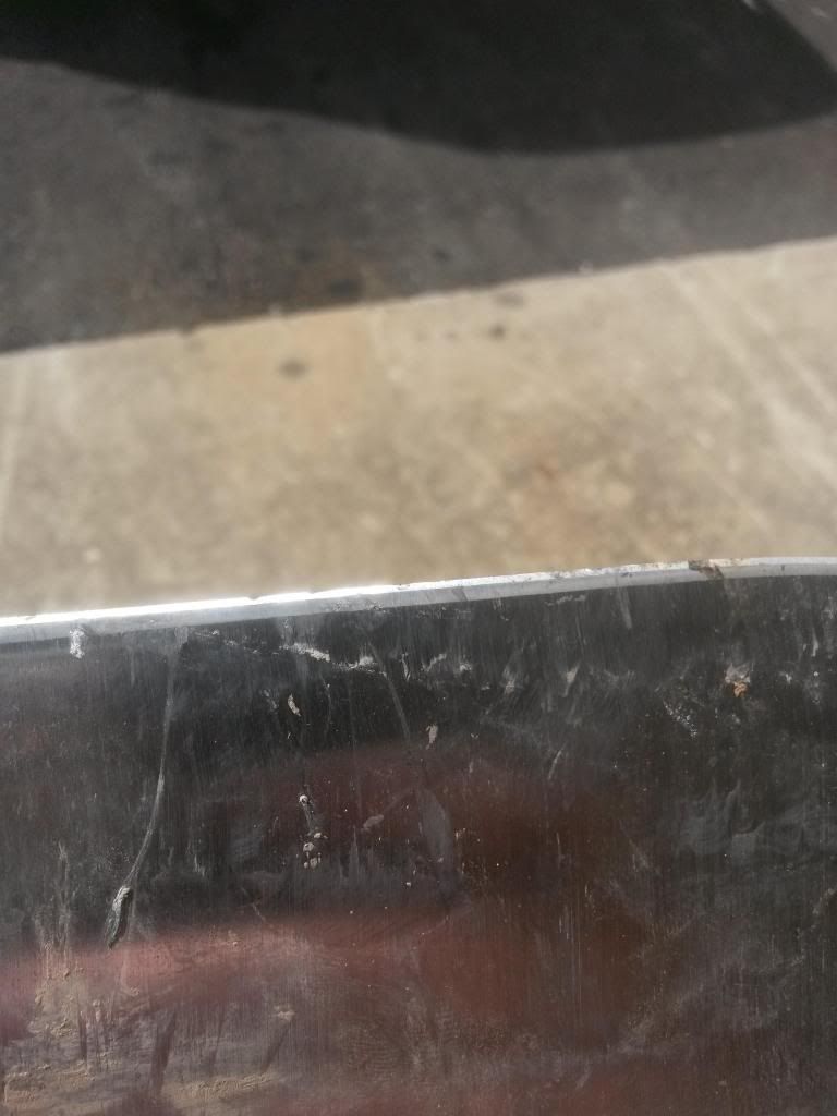

Next I thinned down the edge a bit and gave it a bunch of chops into a steel barrel. This damaged the edge pretty badly but As thin as I had the edge I don't think many steels could do that without taking considerable damage.
Finally I chopped some nails that were in a 2x4. The edge again suffered damage but not very much.
Edge post nail chopping. Every time I hit a nail I got a small chip. I didn't have a good setup though and bet it would do much better with a secure target and a handle :thumbup:
