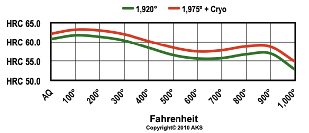

I heat treated 3 blades in aeb-l
I fillowed the instructions per AKS.
Ramped to 1995 for 5 min
Air cooled to room temp
Into alcohol dry ice for 30 min
All the blades came out soft! Can bend them by hand
Can i salvage them?

Ok i just checked the blades again. Two are still soft, but one is good! I cannot bend it and a file will only barely scratch it!
Looks like one made it, and its the best of the three.
Ok there is a miss print on AKS with the heat treat info for this steel. I was too hot for too long.
Heat Treating Information:
Preheat: Heat to 1560° and equalize.
1920°F Austenitize: Ramp to 1940°F and hold at temperature for 15 minutes. Oil or plate or air quench as quickly as possible.
1975°F Austenitize: Ramp to 1995°F and hold at temperature for 5 minutes. Oil or plate or air quench as quickly as possible.
Cryogenic Treating: To get the most from AEB-L you must cryo. Cool to -95 °F. No soak is required.
Temper: Temper immediately after hardeneing or cryo. Temper at least 2 times for two hours each time. Use the table below to achieve desired hardness.
I think the 1995F temp is correct. It does need to be quenched rapidly.

I ht 2 aebl blades at 2075F 10 minutes soak + LN2/cryo. Aust temp was very close to over heated, managed 63rc AQ hardness. 2x 2050F got to 64rc. 4x 1950F-2000F maxed out at 65rc. 4x 2100+F 58rc.

I've always used the 1995 temp, and had good results. I have also always plate quenched the blades.
I did air quench to room temp then into alcohol dry ice for 1 hour. Sounds now like my temp was low compared to bluntcut's sucessful ht. Maybe oil quench is better? I have a piece left, so i will try with oil quench and a higher temp for 10 min soak.
