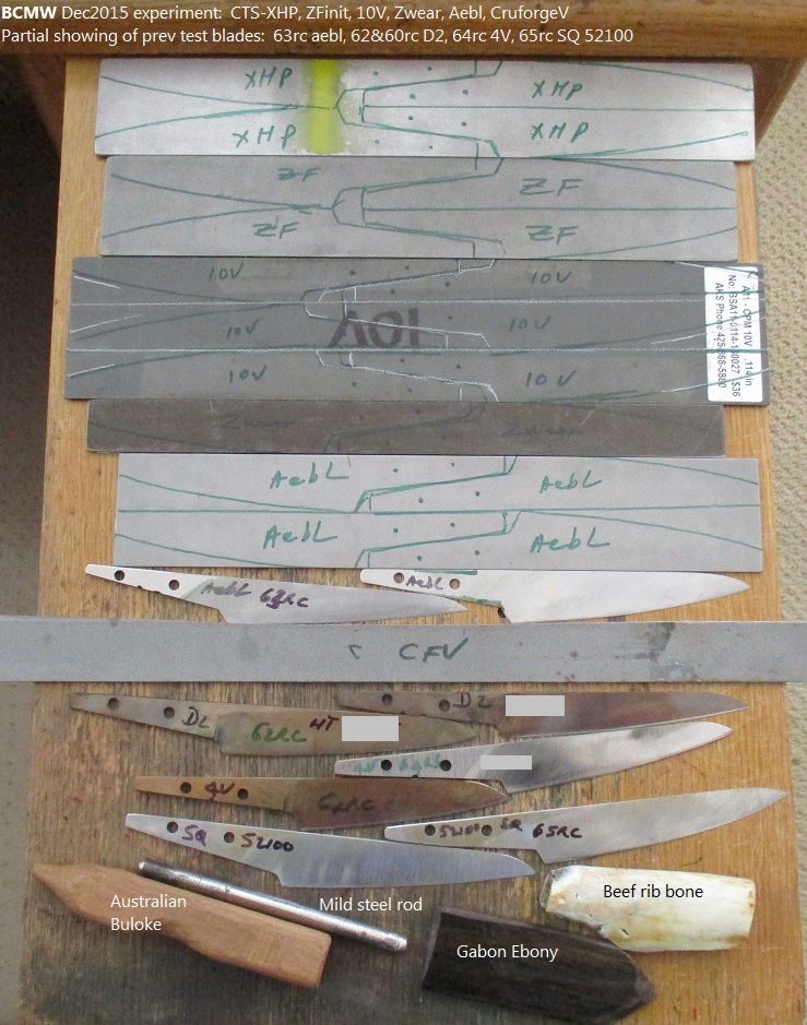

Imagine a wild-knife-nut commission you to make a paring/boning knife with a fixed-specs: AEB-L, 64rc, ~0.01" behind edge thickness, ~11dps bevel. i.e. 1K waterstone-grit edge capable of moderate whittling oak+ebony+buloke without visible roll/ding/chip.
Accepted as a fun challenge... What would you/I do to make one?
OK, actually nobody asking me to make one. Lately, I've tinker ht with medium to high (Cr+Mo) mass% steels. I float this tough specs here, looking for a already invented wheel/ht.
Any experiences & insight & foresight are very much appreciated :thumbup:

Last experiment(aebl; 52100; D2; 4V). I made 2 aebl at 63rc (pic - below) with edge capable of whittle hardwood. I had to use at least 0.015" edge thick to whittle that steel rod. I think, in order to achieve a stable 64rc with aebl, RA needs to be close to zero. My 63rc blades are close but going even higher temp to put all carbon in solution will (after cryo): increase RA and higher percent of plate martensite (thus more brittle & weaker than lath).
I have not run it harder than 62, but my research indicated what Stacy and Warren mentioned. 64 AEBL is going to be too hard for anything but a dedicated protein slicer, IMHO.
Can you even get AEBL that hard?
63rc aebl: 0.09" spine thick with drastic distal taper, zero grinded, 5.5dps - 0.003" BET cutting edge. Whittled pine w/o problem but not thick enough to whittle buloke. Did fine with 0.008" BET and 10dps.

BCMW 20151205 experiment
AEBL 2150F aust 5+ minutes = ran away grain growth. http://www.calphad.com/AEB-L.html predicted/calculated ~2100F of all aust matrix boundary:thumbup:.
1st set: 2x test blades(2150F) - 58RC, fracture grain > 250um (ugly, 15x larger than normal). GB seem to loaded with carbides and elements, guessing that all this deposited/diffused from cooling and tempering. Failed.
2nd set: 2x test blades(2150F) with grain size control - 58RC, fracture grain ~100um. GB looks clean. Much better than uglier 1st set. Failed.
** piggy ride with the 2nd set - a blade I can play around, while toasting more aebl blades **
CruforgeV (2000F) with grain control - 65.5RC, fracture grain ~20-30um (quite large), clean GB. Edge ~13dps, ~0.015" BET was able to whittle beef rib bone fine w/o deformation. Chipped (easy see with naked eyes) after whittle mild steel rod.
20151206 - drop aust temp to 2050F 10 minutes soak - putting a lot of carbon in solution but leaving sufficient M7C3 to pin grain.
Edit 09:50PST:
a. Thinned Cfv to 0.008" BET, 12dps, 1K waterstone finish. No problem whittle oak, ebony, buloke, beef rib bone.
b. ht-ing 2x aebl (2050F), 1x zwear (2050F) - post aust stage.
Edit 11:47PST:
partial tempered at designated temp
a. aebl 62rc & 64rc.
b. zwear 64rc.
c. straightened all 3 blades.
d. to be grind & test edges...
aebl 0.07" spine thick, 64rc, zero grinded, 4K waterstone finished, 7.5dps, ~0.005" BET.
Whittle test:
pine & oak & ebony & buloke => passed
beef rib bone => microchips. Will resharpen to 12dps and consequential increase BET to ~0.006" and retry this test. I guess, I will keep increase dps and BET until passed or max edge geometry reached.
Next - I will grind zwear 64rc and then 62rc aebl. 64rc & 62rc aebl were tempered at the same temperature. 62rc went different route than 64rc and I released too much carbon back into M7C3 form, ended up with only 62rc :(
edit 16:35PST: 64rc aebl, 13dps 0.007" BET, passed beef rib bone.
Edit 17:35PST: 64rc zwear, 12dps, 0.008" BET, passed hardwoods and bone tests.
Edit 22:20PST: 62rc aebl, 13 dps 0.007" BET, passed hardwoods and 3 of 4 tries/sections passed bone test. For the 1 time that failed, a chip is too small to see without a loupe. Peculiar, 64rc edge is more stable at same geometry. Also noticed - because of aebl fine carbide the edge barely bite into bone, while zwear and cruforgev can dig into bone easily - thanks VC.
