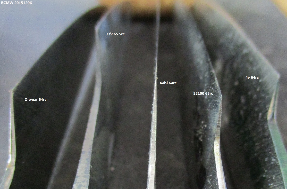

Aebl 64rc 4" paring/boning knife
Edge geometry shot for a few test blades. Off-center-focus choils are actually thinner than pictured.
Thanks. I like to slice fruits with very thin knives - I integrated eating as part of knife testing :)

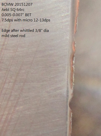

edit 18:30PST: aebl (#7) 64rc. Passed all tests with edge geometry - ~0.005-0.007" BET, 7.5dps and 12-13dps micro bevel. Edge failure mode is mixed between micro rolled and chipped. I am wondering if the edge was over heated during blade bevel grind. 60 ceramic belt was relatively dulled and vfd at power power. No finger burning nor steam puff but since I expect edge failure be major or micro chip at 64rc. Unless RA% is still high. Oh well, just thinking out loud....
Pic might worth a bit more than my rambling neurons...
Edge rippled and chipped at the same time.
