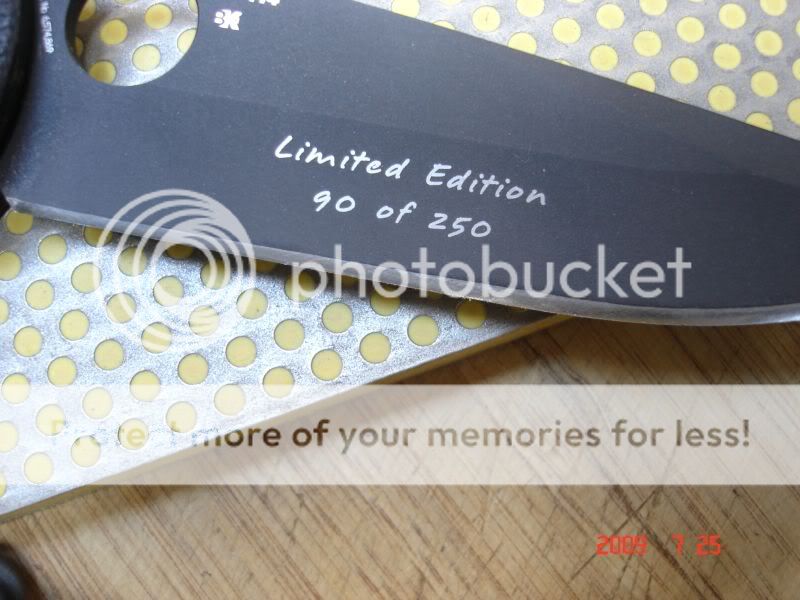

So what's not to love? Well, it's got the saber grind, so slicing isn't its forte. But then Benchmade gave the edge a wide grind that only an ax could love. And out of the box it wasn't very sharp -- your basic folding butter knife. I had to saw off the foil top of a 40-pound bag of dog food, a job my Manix (real Manix) laughs at.
So it needs shapening and reprofiling. But, geez, the scalpers are selling these things for something north of $300. But that's with the "NIB" and "never sharpened" pitch.
Could I really knock $200 off the value of my new AFCK by reprofiling it?
Yep.
Out came the extra coarse diamond stone because a lot of metal had to come off. And this is M4. The Sharpmaker at 30 degrees (inclusive) could only touch the highest point of the edge's shoulder. I don't know what the stock angle was, but it was wide.
Yes, I scuffed the edge a bit. Yes, I can never sell it.:grumpy:
But dang, after a progression of stones and stropping, this thing cuts. Looks like I'll have to actually use this knife.:D
Here's the after/before:
Yes, M4 is a nice steel and takes a dandy edge.
Now go cut some aluminum cans and scratch that coating up. Give the knife some of the character it deserves ;).

I don't know why Benchmade puts such a poor edge on, either. It is a whole different, and much better knife with a 30-degree profile and a sharp edge. The 30-degree edge is much wider, and maybe that detracts from the aesthetics of the black blade.

The 30-degree edges on my Rukus and my Military are not as wide as a 30-degree edge on the AFCK, so that tells me the 806 needs the help.

The reprofiled AFCK edge is just fun to use. It slices paper into curly-cues.
