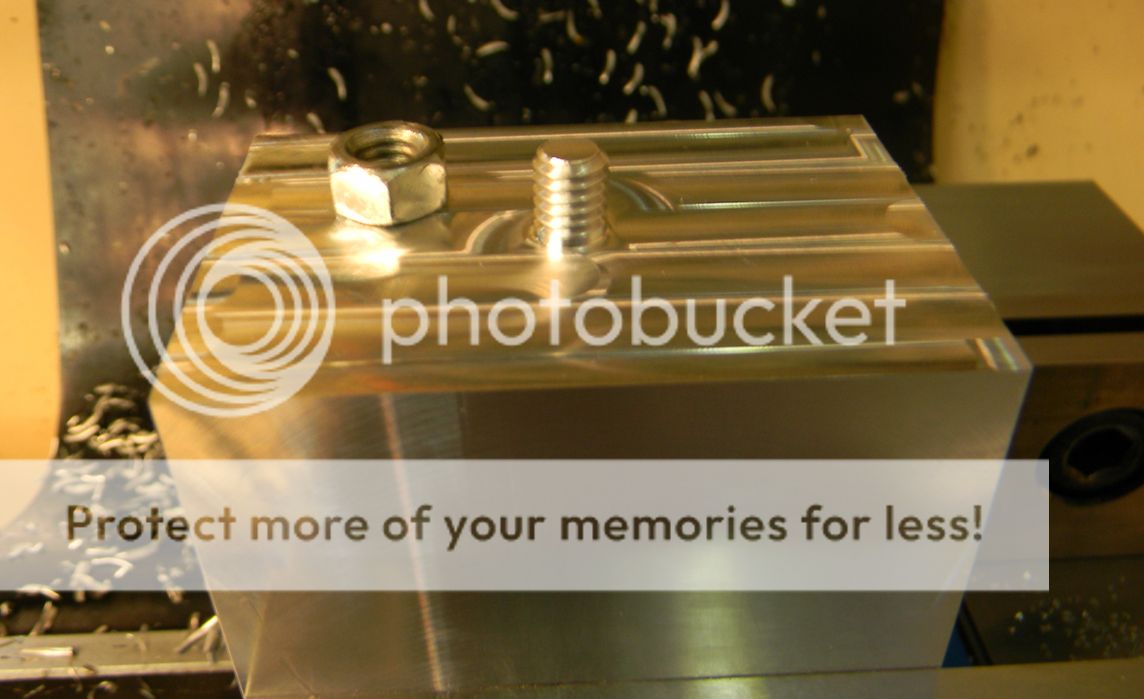

The part cut in the demo (the thread is 5/16-18):
