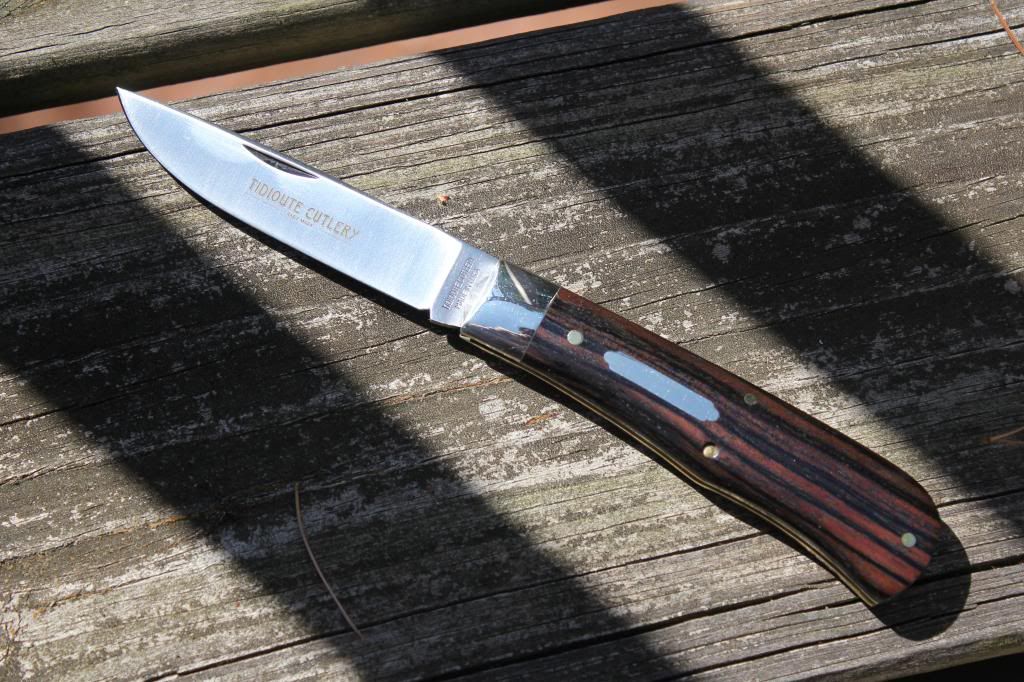

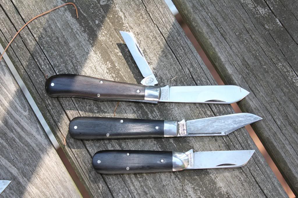

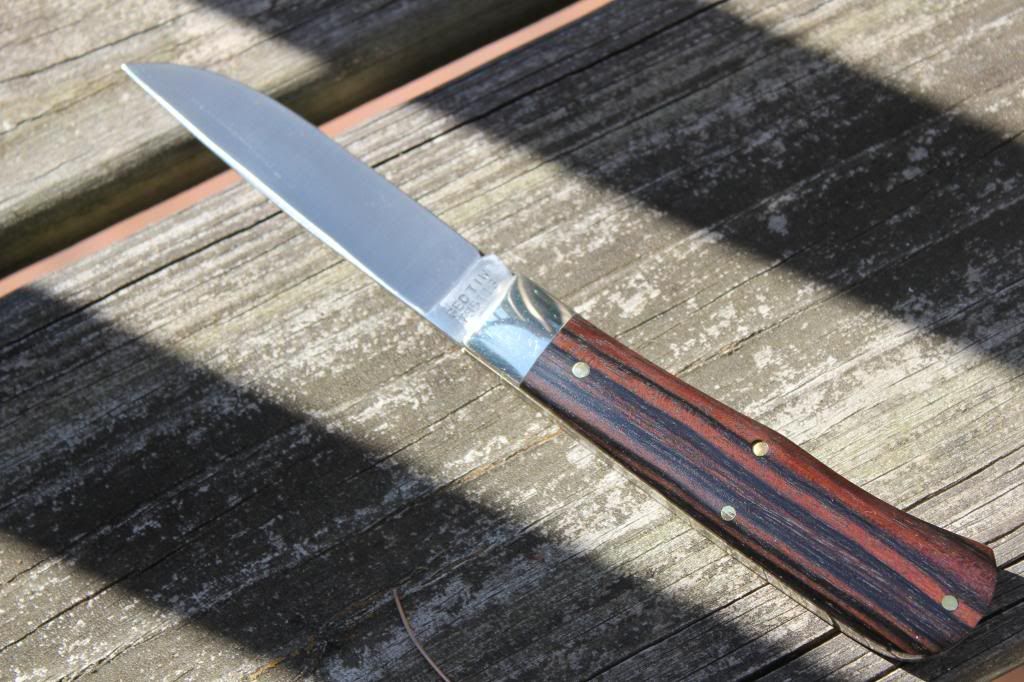

here are a few pics a macassar boys knife, a gabon single spear, and a blackwood sheep with pen, though you really need to handle the materials to get a feel. And the OP already has lots of ebony, so all he needs is to roll the dice and buy a blackwood, then post pics :-)
water basically beads up now
left to right, blackwood, gabon, macassar
gabon, macassar, blackwood
macassar, blackwood, gabon
