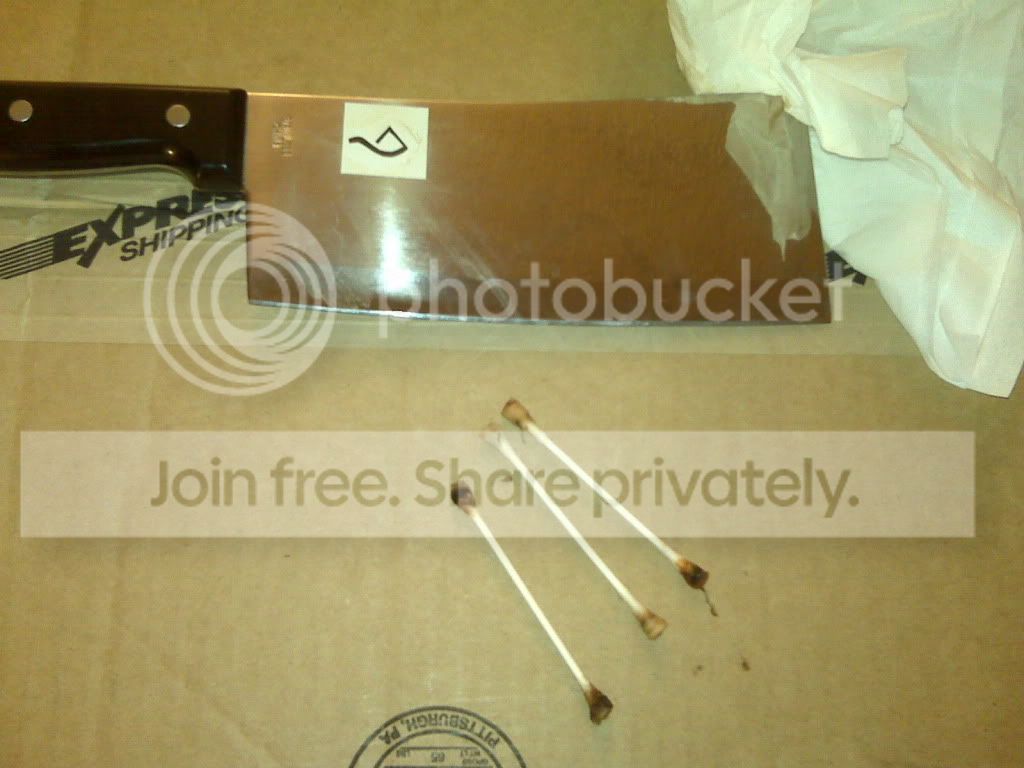

Alright I think using a q-tip is getting me closer. The stencil still looks horrible when I get done. I think I need a better cleaning procedure. The stencil looks really grainy, and the edges all look blurry. Then it hardens up and takes a slight curl to it. Pretty much junk at that point.
As far as the etch itself, I think the q-tip thing helps. I still get anywhere from very faint to blurry, but it's not horrible. I think I need a finer sand paper to use to "sharpen" it up a bit. I used 1200 grit, but it still left scratches. I am machine finishing them with a scotchbright belt, and it seems no matter what if I touch sandpaper to the blade it will leave scratches.
I think I'll get it. I'm going to take a junk blade and etch all over it with some of the practice stencils I got.

Yeah way to wet and holding for to long. If the electrolyte starts to sizzle lift the Qtip.
