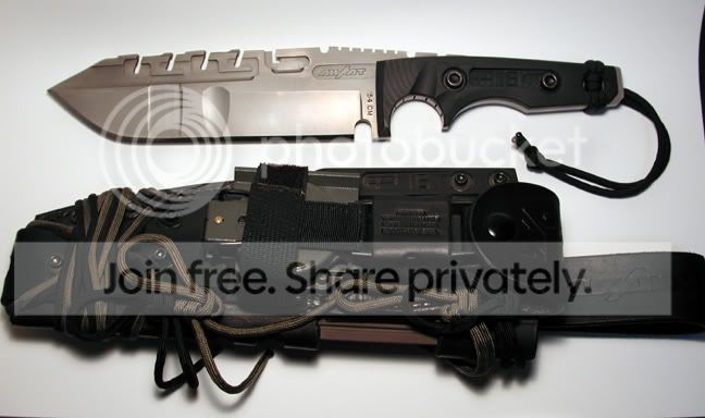

one thing that's always caught my eye about airkat fixed blades is the sheaths... from what i gather in this thread, they are top notch. but i can never find any pics of the sheath, most production photos only center around the knife itself... what's with all that metal stuff all over the kydex? what are they attachment points? all that stuff must be there for a reason...
500jeffreydk, would you kindly post some shots of just the kydex sheaths you have? that would be awesome.
thanks!

The sheath is something special both the old leather ones and the newer kydex. Dwaine does not make leather sheaths anymore due to the time it took. No fixed blades at the moment and not since 2004 or so.
The metal part on the sheath is a thumb rest to get the knife out of the sheath - very nice feature that allows you to take the knife out silent and without the noice a kydex sheath normally makes. The sheaths are also very tight and reverse carry is therefor possible if deisred.
The kydex sheath is open and dirt and mud ca escape from the sheath and cleaning it is also easier. This feature is super cool, and looks great to.
PS Dwaine is making a new folder in colaboration with Joel Pirela, the knife is called RaDok.
Some sheath pictures. Not all the knives are mine!!!
Cheers,
André

Sorry for dredging up an old thread, but I find the designs to be quite interesting. I like the fact that the fixed blades seem to follow the "sharpened chisel" philosophy.
One question I have regards a previous comment made that the presence of complex milling on these knives such as the Apache means that they cannot be tempered steel. Is this true, and (forgive a newbie) is this a bad thing?
Also, whats with the wingnuts on the sheath? Do they serve a purpose, or are they just a design element?
I think what your asking is can the millwork be done after heat treating ? The answer is NO....all the milling,stamping,etc... are done prior to the heat treat. To temper a blade, means to draw some of the hardness back out of it so that it's not so brittle.
I put those wingnuts on those sheaths so that they could be mounted easily to different pieces of gear and easily detatched and mounted to another. Hope that answers your questions bro :)
Dwaine
