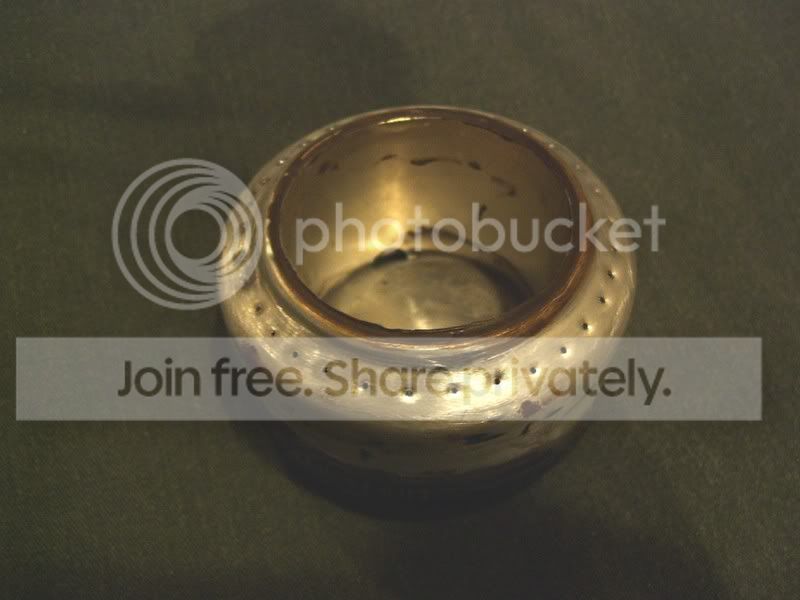

I found the plans for these Pepsi Can Alcohol Stoves, and figured it was a neat bit of kit, so, I made one! It works well, I'm still in the prototype phase though. I used the bottom of a Guiness can for the base, and the bottom of a Sprite can for the top. I am told a Murphy's Stout can and a Pepsi can work better, we'll see.
Here is a pic..
