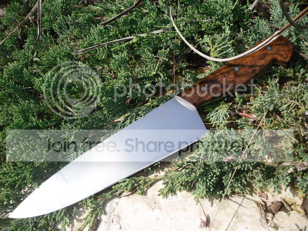

Above is a pic of the finished knife. Wow, almost two years ago. (note pin holes burned...should have used fresh belt on the 4x36!)
Tim, I've used that knife for almost 2 years, and it still hasn't been put to the stone. Just a couple light swipes on the ceramic rod....off to the races.
Scott, the balance point is right where you like it, at the pinch grip. Walnut Burl handle. You're exactly right....2x72 not needed to make great knives.
Harbeer, I couldn't source any Blue 2 in dimensions required for an 8" chef. Please keep in mind, while you do forging (great looking knives, BTW), I'm limited to stock removal. Dictum and Workshop heaven have laminated Hitachi steels, but they're only 1.3" tall. I need at least 2" tall steel for 8" chef. The bars of Blue2 Aldo had were .140" thick, and Ive never forged any, but thinking for a core steel .140" would require some forging down for a core layer. Thanks for the offer on the coupons, but I think I am all set. Try fore welding them in a jacket of low carbon, wrought iron, or 304!

thanks for the update stuart. im planning to cut into my blue #2 after i finish my current batch of w2 knives...and the kitchen kith knife of course :) Im going to send mine to peters for HT but i dont want to make any assumptions , so its nice to hear people are getting good results from that blue #2. BTW your finishing is just immaculate! How has it been for you in terms of stain resistance (or lack there of)? Ive used blue#2 but only in knives with cladding, never as a mono steel blade.

Tim, there is basically zero stain resistance. First thing I cut with that knife was some fajitas, and it took an immediate blue/purple patina. Beautiful, actually. No complaints at all with that steel....it is very very shallow hardening however. I might try a water quench next go around. P50 was plenty fast enough...but then again...the edge was danger thin going into the quench.
