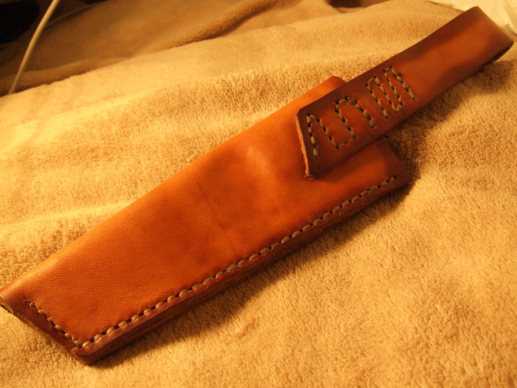

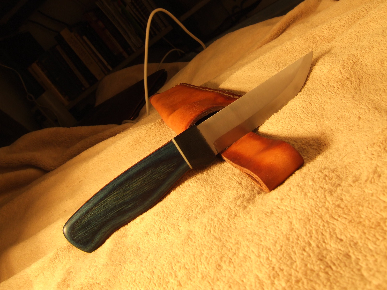

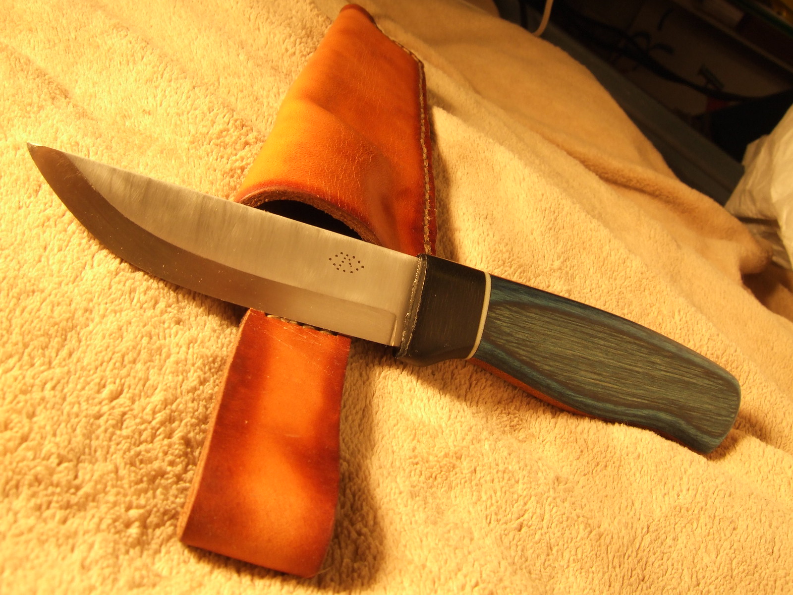

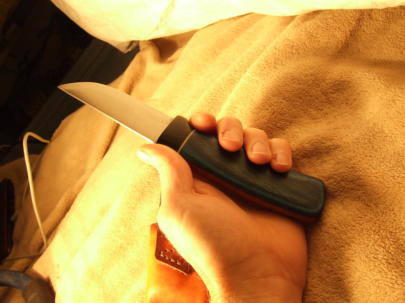

Blade Material CPM154, heat treated by Texas Knifemakers' Supply.
Blade Length, Tip to Guard: 4 1/8".
Blade width: Just under 1"
Blade thickness: .14", minus a little bit for sanding.
O.A.L.: 9"
The bevels are filed, by hand, at 11 degrees, as flat as I could get them, and there is a microbevel.
There are some minor scratches on the blade.

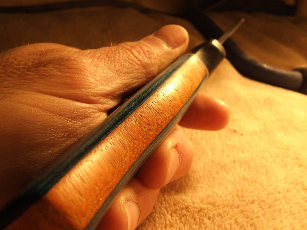

Handle materials: Guard of linen micarta, spacer of G10, the other materials are stabilized mesquite and dark blue dymondwood.
I glued everything up with West Systems G-Flex, carefully following the prep instructions.

I got an email regarding strength of epoxy and the question of pinning the tang. For answering technical questions, I highly recommend the following Google custom search, which limits your search to bladeforums : http://www.google.com/cse/home?cx=011197018607028182644:qfobr3dlcra
A personal experience of mine, regarding strength of epoxy: The first time I took one of my handmade knives apart, it was just a knife that was made using regular hardware store epoxy. I completely removed the pin. I then dropped the knife in boiling water and allowed it to boil for about 10 minutes. I took it out of the water, and grabbed the handle in on hand, and the blade, with vice grips in the other. I pulled and pulled to no avail. Back in the boiling water for another 10 minutes or so. Then more pulling with the vice grips, then banging the handle on a granite slab. Then more pulling. Still no luck. So I had to put the blade in a vise, and push and pull on the handle until it cracked, then came loose. Remember, there was no pin throughout this entire process.
Since then, I just think of pins as decoration: If a stick-tang knife is carefully, properly glued, it will not come apart, unless you bang it against rocks, or use it as a pry bar. Of course, you might have to boil it first.
On this knife, you can see I cut out indents in the tang. I also cut divots in all surfaces, roughed everything up with 80 grit sandpaper, and rubbed everything down using acetone, prior to joining.
Andy
Good job explaining the point about epoxy. Some people don't realize just how strong epoxy is. When properly used, you'll destroy knife before you get the handles off. I wouldn't worry one little bit about handle failure on that knife of yours! I wish I had the extra funds to grab this knife. I like everything about it. I'd be very happy owning it and have no qualms about using the snot out of it!
