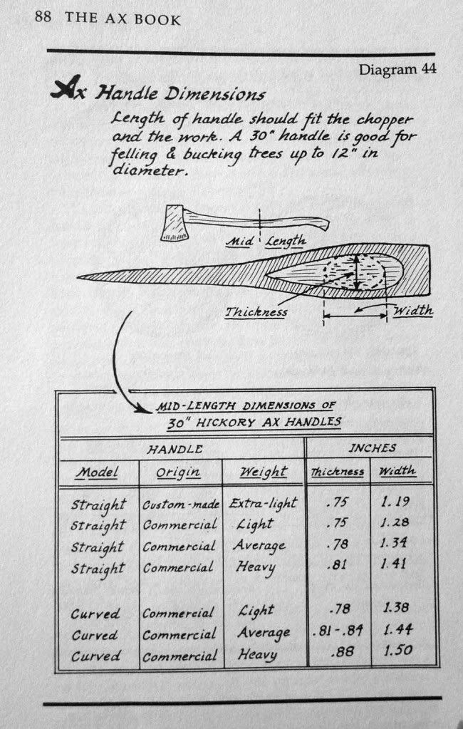

If you do decide to get a new handle you might consider shaving it down if it's too thick. heres a rough guide to a nice thinnish handle for comfortable chopping:

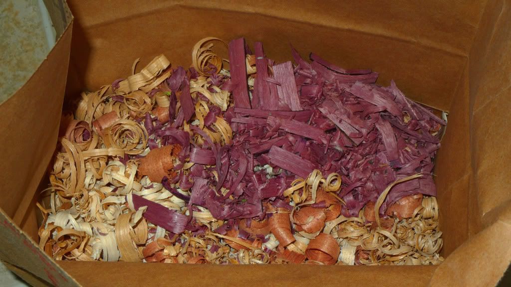

A side benefit of shaving down new handles, or completely making new ones is that you get a lot of nice fire starting shavings:
(purple heart, ash, hickory heart wood and sap wood)
