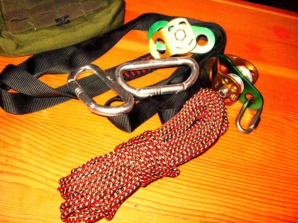

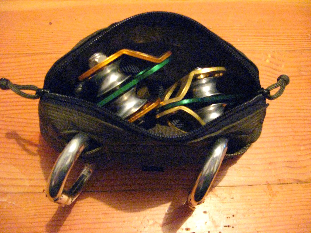

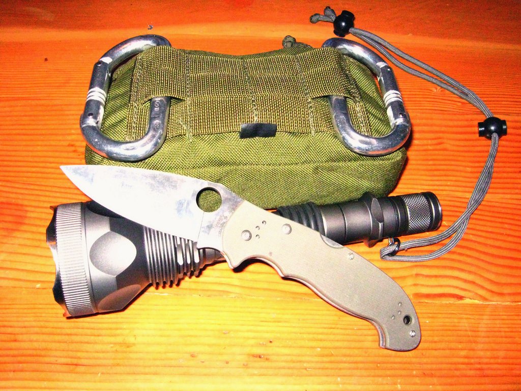

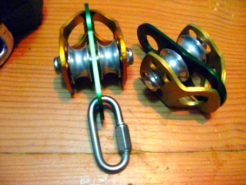

oh hey here are some pics!
everything (not the flashlight or knife though) tucks away in a 6" x 4" x 2" MOLLE pouch, slips into a cargo pocket or clips to pack
4mm Mammut static kernmantle line, 50 feet
