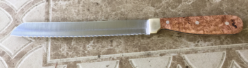

ok Stacy - here you go (sorry for the delay in continuing this - hard to get time in the shop these days. You did not even need to wait until shaping the bolsters: this happened just now while I was gluing on the second scale, and cinching the scale up to the bolster lengthwise using a clamp:
What you are looking at is light shining through a gap that opened up between the top bolster and the blade. I wanted to try this because Boye recommended soldering (without pins) as an option to brazing. Just wanted to see and experience. I have to admit, I am surprised that the solder joint is THAT weak. I think I will just go ahead and throw away my solder and flux, and stick with JBWeld and pins from now on.
Not quite sure how to salvage this. Perhaps let the epoxy cure, get a carbide bit, and try to shoot two holes for pins through both sides of the bolster and the blade, then peen the pins in place. I'd hate to totally dissassemble this at this point, as all the pieces fit up nicely, and I would destroy all those pieces if I tried to get them off at this point. not very hermetic between the bolster and blade .... but this blade sees very little water anyway.
I need to get this finished: I've been using a cheap 2.5" serrated blade to cut my bread - and I miss this blade!
Yeah ... after I unclamped this, the thing pretty much just fell off:
From the looks of this, it seems not so much that the solder joint is weak, but rather that the solder just did not effectively penetrate into the joint (you can see that on the left side of the bolster there is just no solder at all) . Im kind of surprised, as I definitely cleaned it, and used plenty or rosin, and the joint was up to temp (solder melting just on contact with the bolster, no flame present). Maybe too tightly clamped/ surfaces too flat??? Anyway .... after seeing the way this can fail, I do think I will just give up on soldering from now on.
Carbide drill is coming in on sunday. Can drill holes for pins from the blade side, glue this side of the bolster back on with JB Weld (and epoxy aganst the scale), then complete the through holes using the other side of the bolster as guide .... then pin and peen .... so I think I can salvage this.
Lesson learned on solder. Like I said - I am surprised though....

Decided to take time today to finish this up - I have missed my bread knife!
Drilling through the steel and through the remaining attached bolster half went just fine. MAN - those solid carbide bits are nice! (though I suspect this steel isnt extremely hard). the bolster that fell off got glued back on with JB weld (the edge of epoxy from the scale I glued on supplied a really nice registration point, so the bolster went back on pretty much exactly where it was in the first place). Another run with the drill bit, and I had two nice through-holes for 1/8" pins. I decided to not glue, but just insert and peen the pins (both for bolster and handle) - so that went fast. To my surprise, the pins in the bolster are basically not visible. I only took the handle up to 600 grit, then applied Mothers wax. (did I mention I have missed this knife? I need it back in my knife block!). Oh, also touched up the blade using a scotch bright belt. the addition of the bolster to the handle gives the blade a nice heft it did not have originally....
