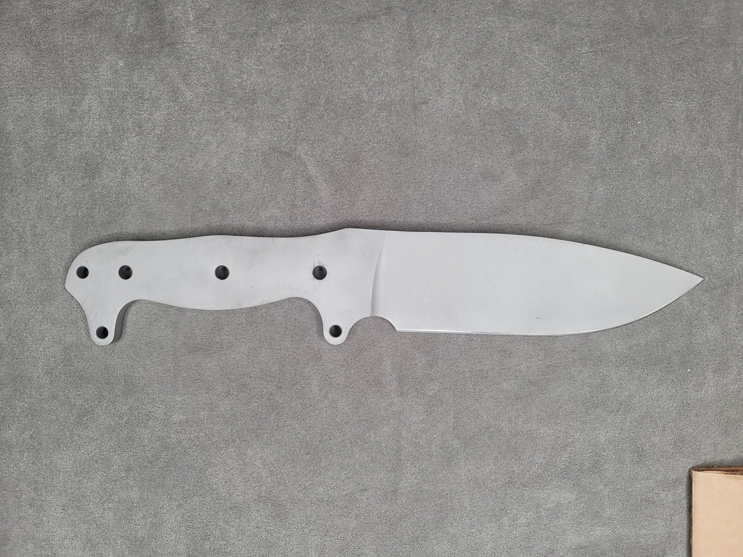

The most stressful part of this next process was removing the handle tubes. I secured the blade in a vise between wood planks to ensure the blade would not move. I drilled them out on one side with a smaller bit then used a medium sized stepped drill but to open the tube just far enough to get the flare to fall off. Then GENTLY tapping the tube rivet out with a punch, the smaller drill but leaves a stepped out cut inside the tube which give you a nice shoulder to tap on, I highly suggest using electrical tape or something to keep the scales held against the blade handle you DO NOT want the tube rivets to push the handle material away from the handle and then tweak them and break them off. Once the tube slides out about 1/8 of an inch I grabbed the tube fastener with pliers and rotated it forward and backwards while pulling, all while holding both sides of the handle scales still.

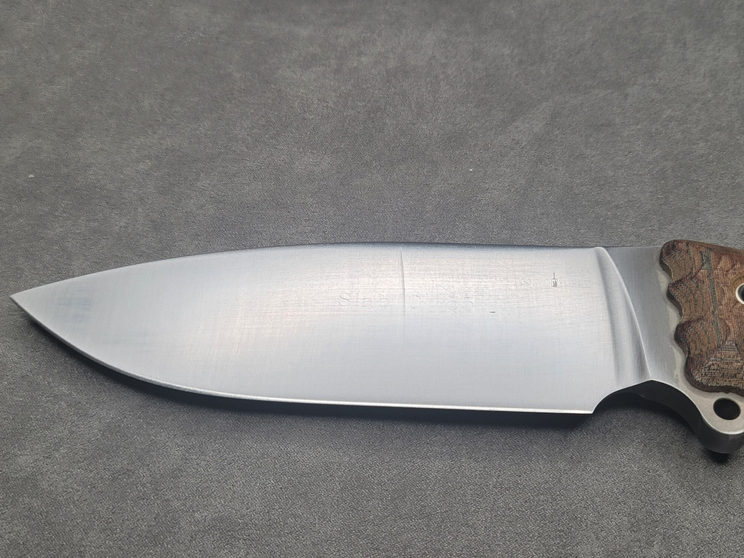

OK, here we go. Ask you can see here, there was a full coating of muddy brown still under the scales. I blasted it off to get a nice even finish. There was a blade and scale markings - M19 I masked those off on the blade to retain them and ensure the blaster didn't remove those original markings. the vertical line is still there but its flatter and more even. Which does not bother me, I did not care for the partial strip job. I really wanted it to be all or nothing.

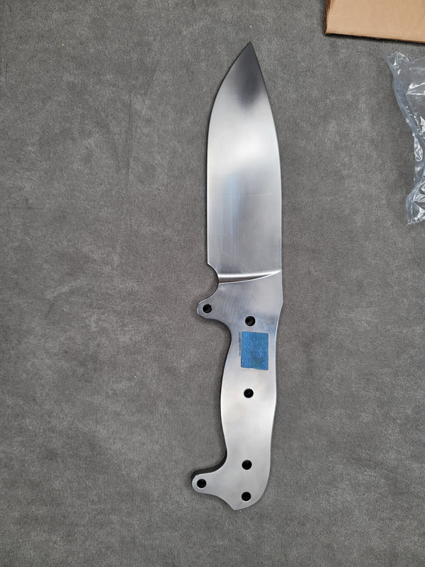

Getting closer, replacement handle hardware has been ordered. Spent a couple hours slowly buffing small sections at a time to make sure the blade stays cold. Not too hard when my shop is about 10 degrees F. Needs some more cleanup, but had to come inside to thaw myself out.
