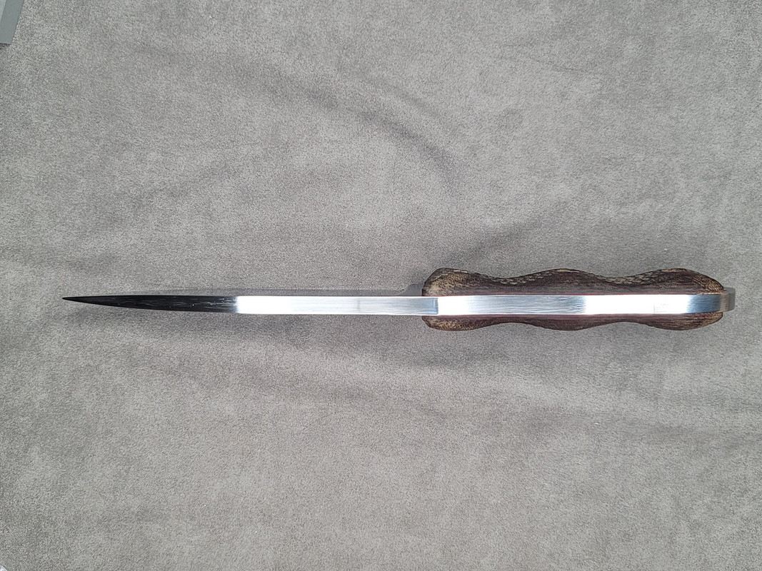

An old HOG....needs love?
Nice! I plan on adding some handle thickness with liners to a couple of mine, but was going to flare tubing again to secure scales. Can you share what kind of hardware you chose?
Thanks!
Just a heads up the screws and posts come in various lengths, you want to get a female post that goes all the way through the scales and blade AND seats just below the recessed 1/4 part of the hole in the handle scale. Make sure the threaded section length of the screws you buy are under 1/2 the length of the post. If they are over 1/2 you may have to grind them down or they will bottom out into each other and your scales wont be tight.
Also the screws are Torx Plus, it is a lil different than a standard torx bit and harder to find, definitely get 2 bits from the same site so you can hold one screw still and torque the other. A regular torx big works, but will leave a bite mark in the screw head, the proper bits will leave it unmarked for the cleanest install!

Just a status update - The handle hardware has arrived and is nearly spot on for what I needed. Ideally the hardware would have been 11/16ths in length, 3/4 is too long for this blade, but that wasn't an option so I rolled with 5/8 and that looks like it will work great. Busse makes these handles to such a tight tolerance that I had to apply a micro bevel the last Stainless Steel standoff so I could install it smoothly without undue force. Nothing a handheld cordless drill and a file couldn't take care of in about 10 seconds. I am still waiting for more buffing wheels to arrive. My other wheel was starting to fall apart so I ordered a handful of spares in several different types.
The polishing wheels arrived a couple days ago. It took me a while to put more polish on it. I only polished for a min or two at a time and then let the blade return to ambient temp in my garage, about 25 degrees F. I did not want to mess up the heat treat and I didn't want to end up with a mirror polish.
Here are the final results.
To the OP what size drill bit did you use to drill out the tubes? 3/16"?
I believe it was 11/64 or 3/16 but I am not sure. I cleaned up my shop last week and tossed the old rivets out so I cannot check to verify. The key is to enlarge the inside hole partially to create a shoulder of material inside the tube, you do not want to drill all the way though, then you carefully remove the top of the flare with a medium stepped drill bit. Once its removed, you secure the scales using e-tape and you can then place a punch on the new formed inside shoulder of the tube to lightly tap it out of the hole, without a shoulder to place a punch on it is very difficult to remove the tubes.
