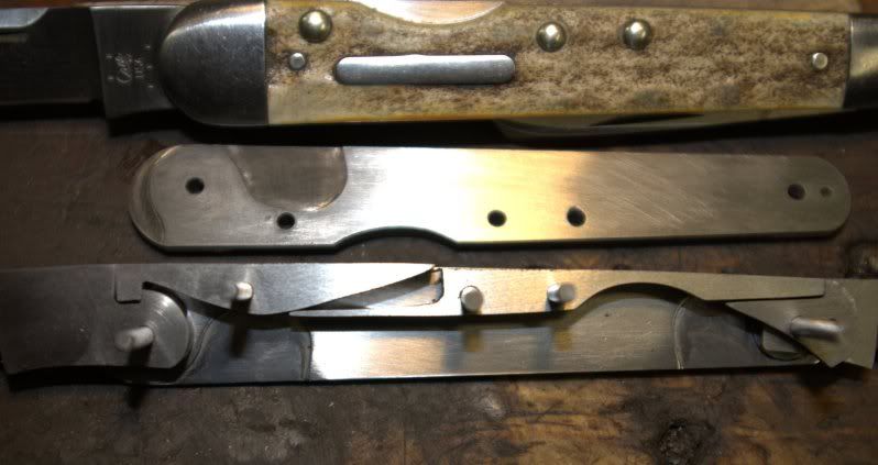

I was asked to make a scaled down version of the Tony Bose/Case collaboration lockback whittler and thought this might interest folks here in this forum. (mods, if inappropriate please move). If your like me, I had wondered what the extra pins serve. Tony was kind enough to send me the pattern for the 3 7/8 Bose/Case version. I scaled this down to 3 5/8 and instead of two secondary blades , only one and its a small clip blade. Anyways I wanted to show how these cool knives are set up inside. The backspring works the secondary blade in the conventional manner other than being anchored in two spots so it does not pivot. The front of the backspring works the locking bar/rocker pushing up , thus locking the master blade.

I went through 3 backsprings before getting it right on this!:eek: I was wondering why the last thing Tony said to me on the phone was "have fun with this one". Now I know.

The shot of the inner workings of the knife show how complex this knife has been to build.

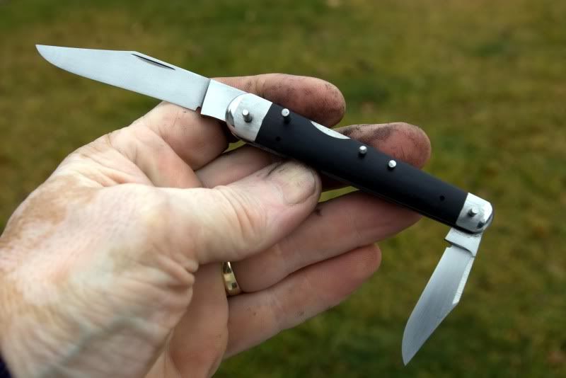

Ken, That is the coolest custom pattern. I thought it might be helpful, if not interesting to see an old New York Knife Co of the same pattern. Now that I can relate to how hard of a knife it is to manufacture, I now realize why I've never seen another. When I first got it many years ago I thought it might have been a special order knife, but did eventually find a photo of one in a HSB catalog. The master blade on this one is probably about 3/16" short. Check the photo of the catch bit & you can see that the blade probably went a little further. Whoever was the original owner of this knife sure knew how to sharpen, it is still razor sharp. Keep in mind this knife was made between 1880 and 1930.
