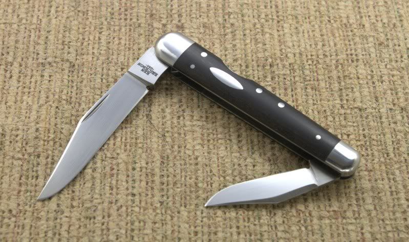

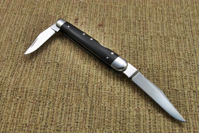

Here are a few pictures of the finished knife. Please feel free to give any criticisms or suggestions, this being the prototype.
Thanks for all the input on this thread!
Ken
Sorry for the poor pictures on this one, I was having a "bad picture day"
That's an impressive piece of hardware, Ken! Be worth at least a few $ gig-a-bucks imho! ;)
Looks great! I like the nice round, almost "barrel" cross section of the handle. My biggest gripe with modern customs is when they wind up square and blocky.
The two sizes of Clip blade are great also, although I would prefer one to be a Sheepfoot or Wharncliffe. Ebony is such beautiful stuff; nice choice.
Can you show us the blades closed, Ken? ;)
As much grief as I give you Charlie, I should have known better! LOL Added a picture looking down, with the blades closed. Even though the secondary blade thickness was kept at .093 there is plenty of clearance on all sides.(no blade rub) When working out the details on this knife I was asked to keep the small clip relatively robust.
By the way this knife is D2 and forgot to put it on my scale before sending it out:grumpy:;)
