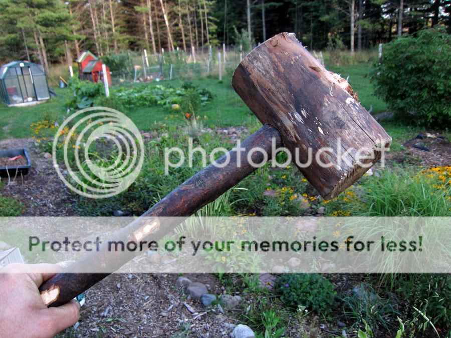

So here is the next piece.... a Germanic Warhammer as seen in Conan the Barbarian. After putting all the work into the hammer head, I was very disappointed in Serge's handle. Not even a copper pin.
