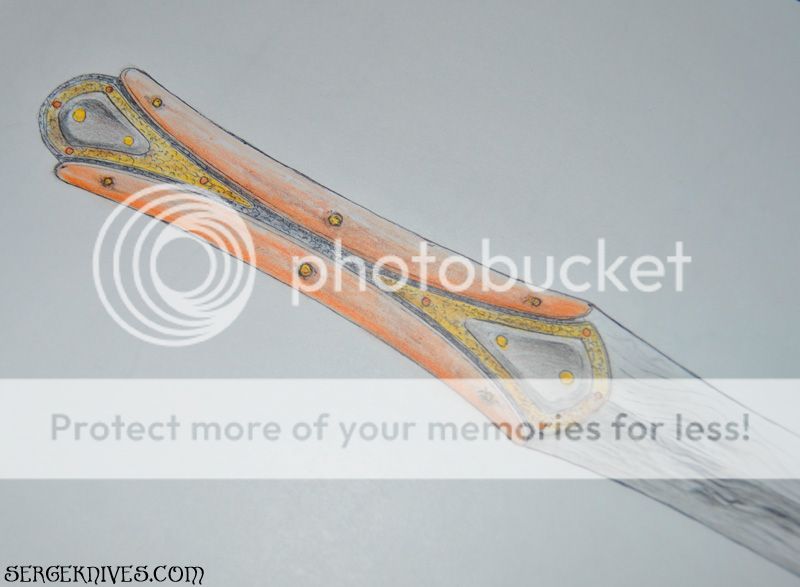

The handle is in the design stage, should look something like this:
The handle will probably consist of two folded over copper pieces, with brass plates and Ebony over that, but not 100% sure yet.
