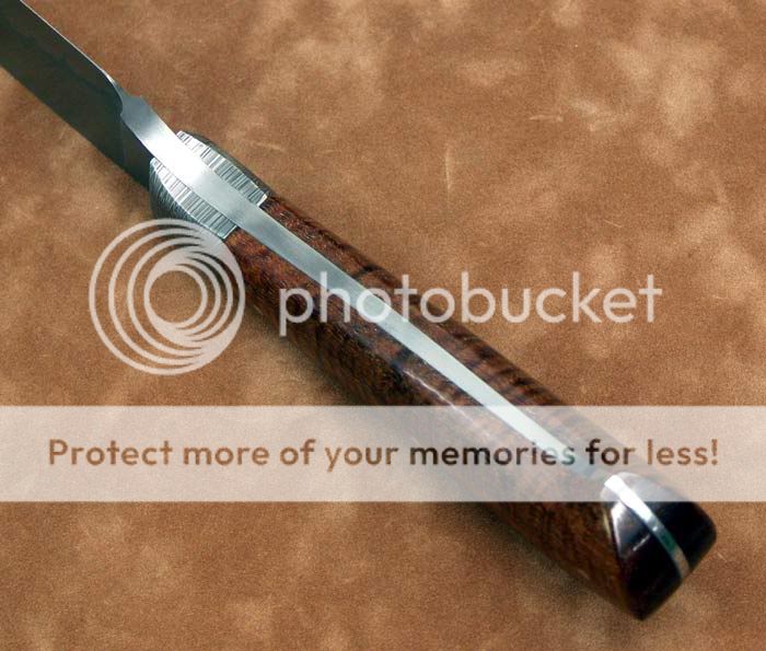

Let's see the finished handle in the following shot! I keep on wondering .. what's the brand of the camera used by The Smith to take all the shots?
It shows a tapered tang. Very nice choil. The plunge at the choil looks just perfect. I think the edge isn't sharpened yet. Is the edge sharpening will only be done as the last step just right before shipping? Is it a common practices among all the knifemakers to sharpened the knife edge last? Any answer, pretty please!

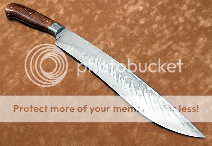

And below is the shot of the finished knife! What a gorgeous giant cutter! What say you? And again the shot was taken from the right hand side of the blade :D
BTW, the above shot is the last picture that hides the identity of The Smith! So, better to make the guess now! Join the fun! The next batch of pictures will show the left hand side of the blade with the maker's mark on it and of course it will expose the identity of The Smith :p
mohd.
that is so friggin nice I can't stand it.
Well, like a lot of other folks who have commented here I'm fully expecting to see something fishy when you show the other side of that blade. ;)
And I have to say, it's a pretty spectacular knife. Always cool to see such a wild hamon on a damascus blade like that
it's hard to imagine anyone else but Don making a knife that looks like that.
Gotta be Don.
As to the question about sharpening at the very end.. What I do, (and if it's not common please let me know) is start the hand sanding and once I get to about 220 with all the grinding marks out, I sharpen the knife fully. I then rub some 1000x along then edge just enough so I won't cut myself or shred the sandpaper and start with the 220x again and go through the hand sanding finish. This makes it so the final sharpening leaves only a wisp of an edge line and not interrupt all the hand sanding work.
That is a truly gorgeous knife - but then, we could tell that from a few photos back. The Koa turned out great and the damscus bolster was a nice touch.

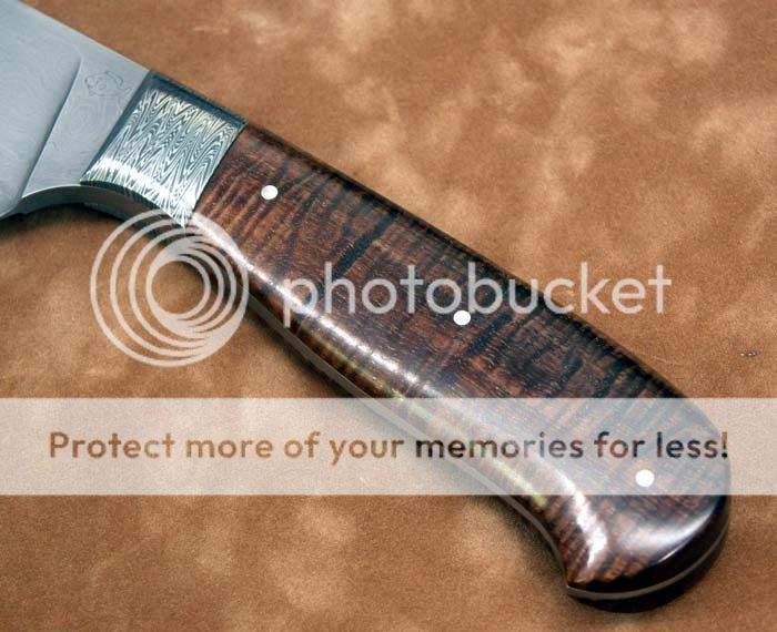

Below is the shot that shows the left hand side view of the cutter whereby we can see the maker's mark at the top of the ricasso near to the spine!

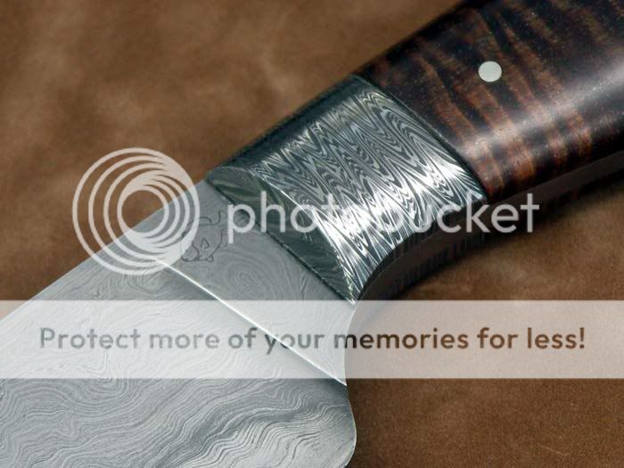

Maybe the maker's mark is not that clearly shown in the above picture! Below is the shot of the the cutter that shows the ricasso, the bolster and the handle. And the maker's mark is there at the top of the ricasso near to the spine!
Now .. confirmed .. it's a maker's mark .. a picture of a sunfish stamped to the ricasso!
A sunfish!
Don Hanson III in his website said:
In the beginning my tang stamp was my initials DH, but in 1996 I changed it to a sunfish stamp designed by my wife.
Yes! It's the maker's mark belong to Don Hanson III! The Smith is none other than Don Hanson III :D
Looks like it could be a rare, full-tang Don Hanson... No matter, I really like it. :)
Cogratulation to Nick who was the very first one to correctly sense the touch of work made by his knifemaking comrade :thumbup:
My congratulations also goes to Joe, Lorien, Roger, Stuart, Jim, John and Wulf for correctly guessed Don Hanson III is The Smith.

Thank you, Mohd. This has been a very good project. But let me tell you, a blade this
long(14") and this wide(2-3/8") is much work, from forging, to grinding, to heat treating,
to hand sanding. I do like how it turn out, I want you to cut down trees with it, and
report back :)
