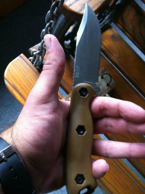

i have to say...i am super impressed. i like the blade shape. i normally prefer drop to clip point, but really like this one. i like the weight. and i like the contours. the handle is a bit too thin (for me), and i don't prefer the countersunk holes. the middle one is right where my middle finger grips the handle. but that's perfect! now, i have an "excuse" for swapping it out! :)
without further adieu....here she is

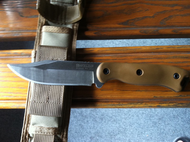

damn...i'm a wordy SOB...here...have another pic....

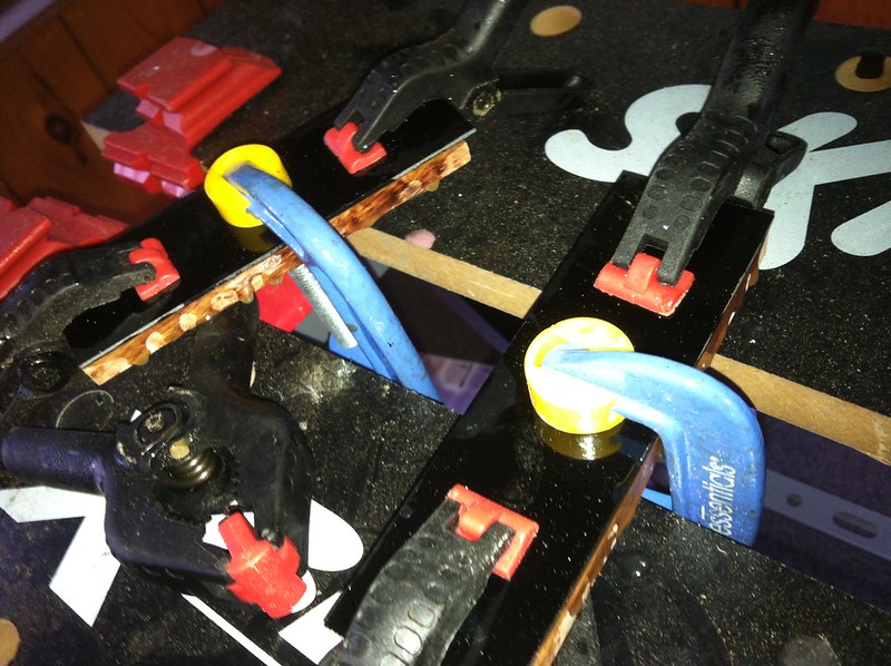

scales are already gluing up!

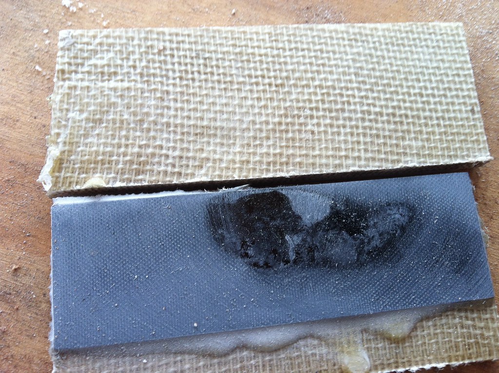

I had a change of plans. i have been experimenting with making "micarta". i will be using these natural burlap scales with thin, black G10 liners.

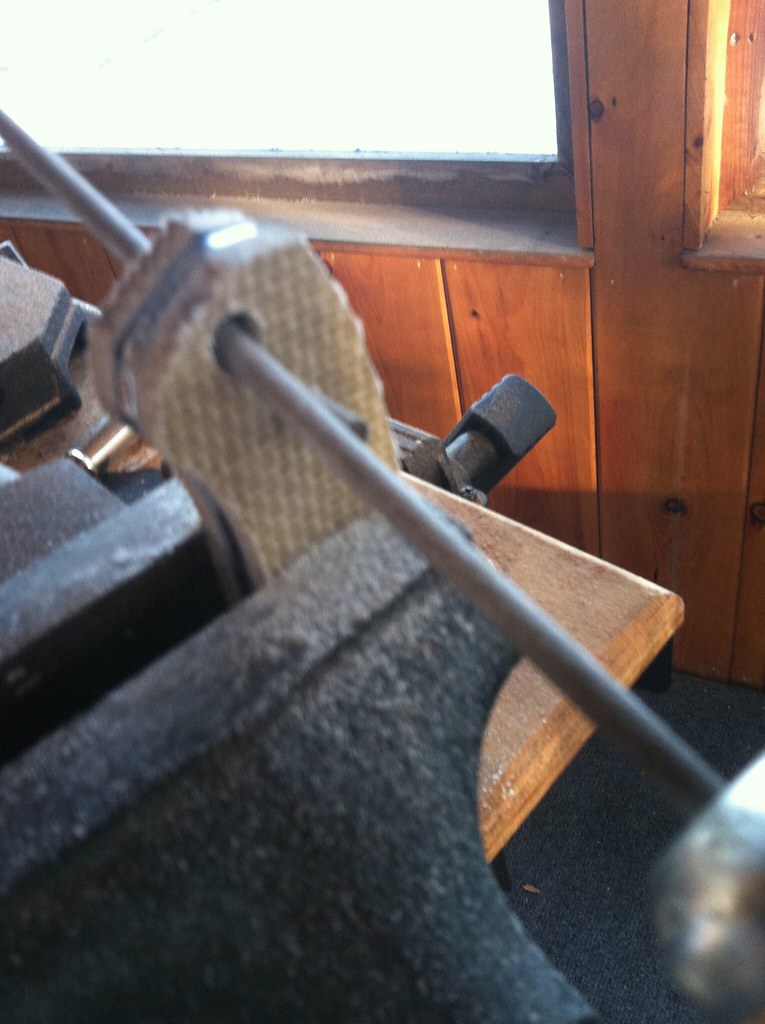

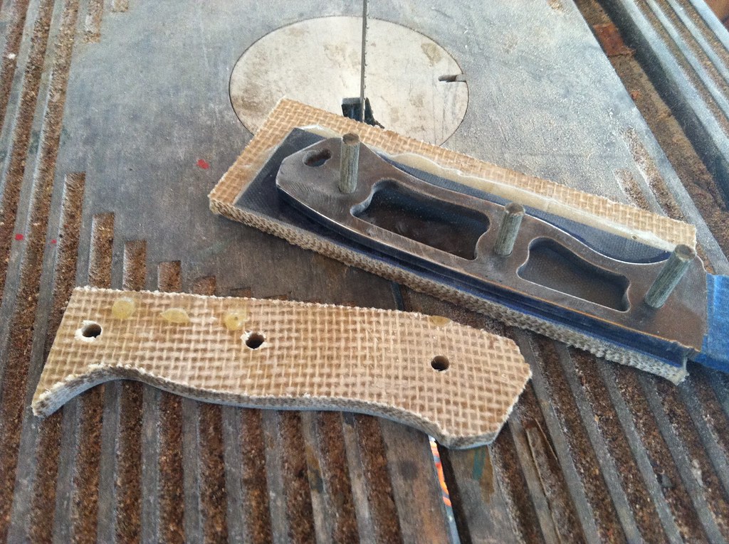

first, gotta drill the holes. you will notice the duct tape. i have made a few handles before and it is diffucult keeping the handle in the same "spot" while drilling. so today, i used the duct tape. and, i must say...it worked well.

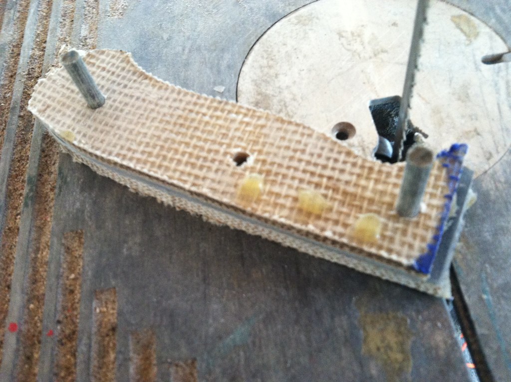

next, cut out the pattern. there are many different ways to do this. i know some trace the handle and then just cut it out. i like to pin the handle right to the scale and cut that way. that way, i can get real close to the tang without worrying about taking too much off.
make sure to shape the blade end of the handle prior to attaching the scales.
at first, i was going to skip doing the lanyard hole. it's easier. but, then i decided to go ahead and do it. i knew this was the part that was going to get me. the exterior diameter of the tube was about 9/32". the hardware store didn't have a 9/32" bit. i had to use a 1/4" bit to open up the lanyard hole on the steel and the micarta. then, i had to use a round file to open it up to fit the tube.
i told the guy at the store, as i was thinking (I asked him if they had any 9/32" bits): "Well...i guess i will have to use 1/4 and then use a round file....but, it isn't going to be straight." and, that is precisely what happened. the hole is not perfectly round. when i epoxied, i made sure to add a bunch around the hole to fill it. i hate to do it, but i don't want to waste the whole scale. this will be my knife, so i will not be too particular. you have no idea how hard it was for me to accept this. :D

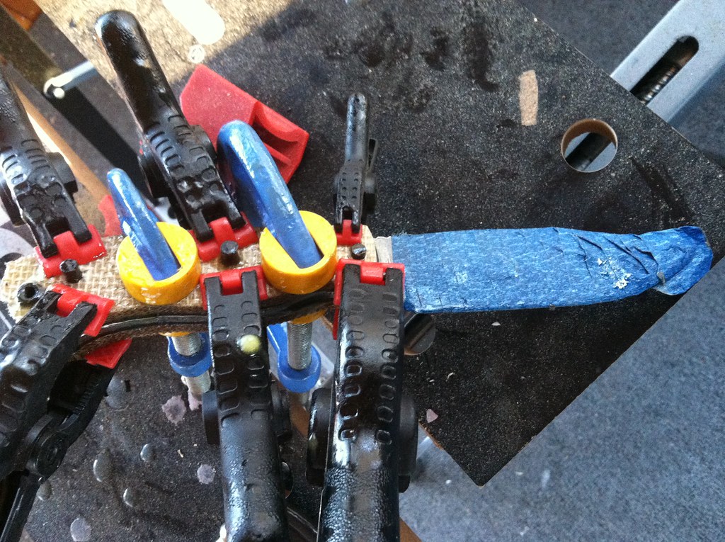

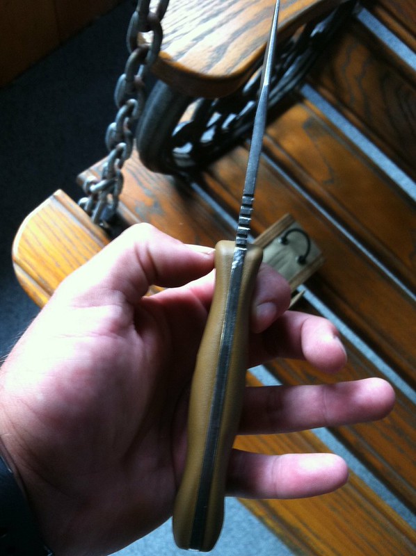

here is a rough, in-hand shot prior to gluing up.
and now...we wait.
