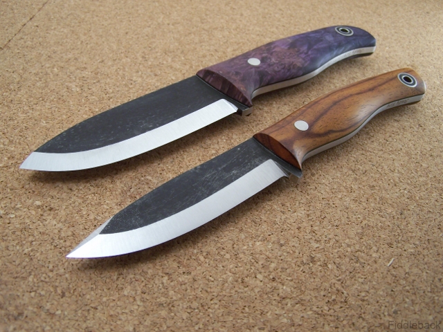

I want to blend these two knives:
I want the handle from the top one and the blade from scandi lady finger.
1) Blade thickness - around .150 (don't sweat that detail too much - your stock runs about that).
2) Blade height - around .900 (give or take - this will likely match your lady finger blade height) give or take - but not too wide - I want the spear point to be natural and good for drilling when needed - think spear point of the BRKT Aurora.
3) Blade length - around 3.900 - nothing over four inches for sure - I want it to be legal in most places.
4) Handle Length and OAL - Around the specs of your Bushcrafter - it measures at 8.400 in OAL - 4.600 in handle and 3.900 in blade (around there).
5) Thumb jimping - if it is not a PITA - or make it an option for others...
6) Mosaic front pin - one bulls eye lanyard tube - color to contrast handle material - this can be optional as well.
7) Dual wood material, but chosen for their durability over all. A stabilized wood or a hard wood like Ironwood.
8) Make sure the transition from the scales to the ricasso is non abtrusive. I think your Woodcraft knife may be fine - just take into consideration that most bushcrafters are choked up on to allow for fine work - and the thumb and fingers need to be able to grasp the flat of the blade without being uncomfortable.
9) Also I want you to flare the butt end of it slightly to prevent from slipping off the handle (if you can make that look right) like the BRKT Aurora handle has. You current bushcrafter has a .735 handle width at the ass end - I am thinking around .800.
10) Scandi Grind where the bottom of the blade is straight and long, not curved. Look at Kosters Bushcraft edge:
See how from the Ricossa to the point where it sweeps up in to the spear point it is flat. Rounded stock make for a transition doing fine work that is not as comfortable as with a flatter grind. Your blade on top in the picture at the top of this post is a perfect flat ground blade into the sweep. Make the blade not so tall and a spear point - and you have what I have in mind.

JESUS! I'm frustrated with this design after drawing and re-drawing for hours last night.
The Ladyfinger blade is a drop point and its 1" wide edge to spine. You want a blade that is 0.9" wide and spear point. So there isn't really much similarity there at all. The Bushcrafter has a handle that is 1 3/8" wide at the guard. When you put a 0.9" wide blade on a 1 3/8" wide handle it looks horrible. Even when I change the handle shape to blend the two, it looks like a hot chick with cankles. No drawing had sex appeal.
I think what we need to do is design a spear point bushcrafting knife with its own handle. But then I run into the damn thing looking just like an Aurora, with the flare at the butt end and everything.
So, tonight I'm back at it. I'll grind a model from a paint stirrer today so you can see what I'm talking about when I try to put that skinney blade on a wide handle.
Andy - here is what I have noticed - if you make the handle taller it fills your hand better - however - with this design - I wondered if you would run into this problem.
I have your bushcrafter in my hand to suggest these changes - i think it would work.
Make the slightly taller (to make it blend right) and then make the scales wider to fill out the hand. I have loved your designs, but in terms of the handle - they were not hand filling enough until I handled your current bushcrafter.
So - draw this up to make some changes:
1) Make the blade a little taller too - make it .950 or even .975 at the ricossa.
2) This should allow you to then make the handle something like 1.250 or a little less (1.150) to make this work. Slight tweaks - but I think with the wider scales it would work.
3) To get away from the Aurora look (I mean we could just buy one of those if we wanted one - but we want Fiddleback goodness) - drop the butt flares and drop the hook (at the end of the palm - pinky side) just a little more. This would provide a hook for the hand that would do the same as the flare I think. You would need to make sure the handle was over 4.500 inches long from handle scales at the ricasso to the butt. I am thinking you would add some - 4.600 handle length to make for this change.
