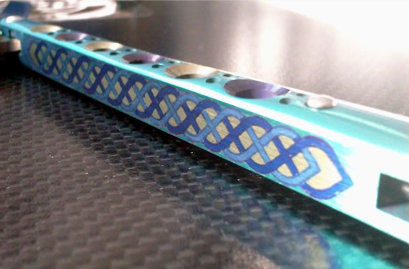

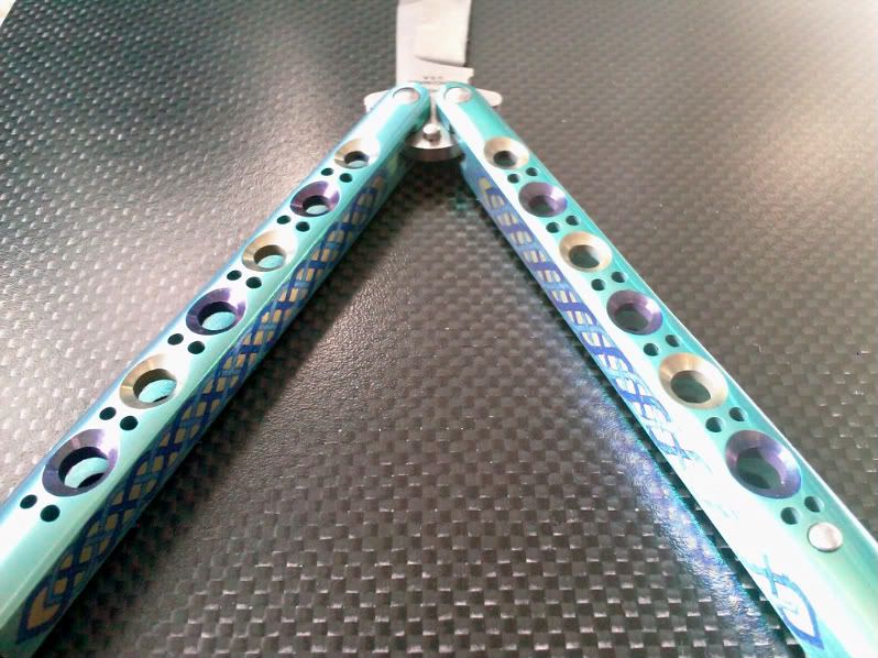

Care to tell how you do the stripe's? Is it just pen striping, then anodize?

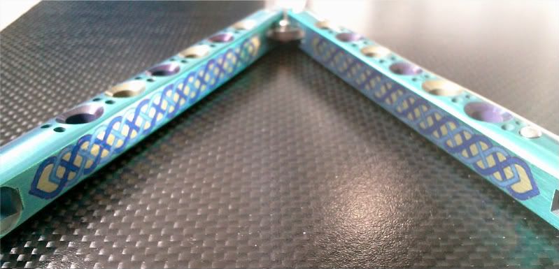

That one was one of the trickiest pieces I've done, the outline was masked with PCB transfer and the rest was masked after each dip with enamel. The puzzle pieces in the linked thread were all hand masked with enamel.
