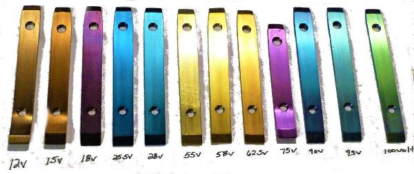

Is it possible to get a deep brown burnt bronze color? If so, what voltage?
I actually hit something close in yet another experiment the other day. It was only a small part of the peice, but I think it would look great as the primary color. The Bronze/Gold colors happen right at the beginning of the scale, between 5-15 volts. But is always dependent on multiple variables.... Electrolyte, electrical current, makeup and finish of Ti peice, etc. This peice was trying out another random electrolyte, and a dip style to create a grained look.
The knife in the picture below had the end brown section done at a very low voltage, if I remember correctly, somewhere around 7-10 volts. The clip was also done at that voltage, but was highly polished first. Bringing a bright brass or gold tone. The knife scales were fairly heavily etched in the Whink and left with a matte texture. The clip and back spacer were both mirror polished.
This picture is one of the best I've found for ano color scale approximation. It uses actual Titanium, and specs the details.

Very nice results! This is how I have been doing it, using 9volt batteries.
Here is a chart for various voltages.
Because of the nature of how the oxide layer plays with light it is hard to capture exactly how it looks in real life. Here are some clips I did. Purpleish bronze on left and dark blue on right.

On my 0808, and my son's 0801Ti, I hit the entire peice at a higher voltage to get the green color. Somewhere in the high 90's. Or if you want more of a wasabi green, I use 51 volts. Then sand/polish the flats and aim for colors at progressively lower voltages.
Depending on the original texture, I may start around 240 grit, or jump to 600-800 if already flat and smooth. By the time you are rubbing around on the 3000-5000 grit, it's usually pretty polished at that point. Be sure to do this on a very flat surface. I use some leftover marble tiles from a basement remodel.
The bronze to purple to blue are hit in the 5-23 volt range. You could go either direction as long as you have a plan and be systematic. I think I reversed and went lower to high in order to better blend the colors. So I dipped the entire part at around 8 to cover the polished area with Bronze. Then increase to 17, and dip the side I want darker, in to about 2/3rds of the way. Keep the motion very fast, because 1/2 second can make a difference. If you have control over the amperage, lower it if possible so it may take a fraction of a second longer to hit the voltage color. If darker is needed, dip again, QUICKLY, and maybe not as far in. Then increase to around 21-22, and dip the last 1/3rd. These lower voltages will not affect the perimeter green from 90 volts.
Clear as mud? If so, better spend some time surfing YouTube. Maybe "how to anodize with gradient".
