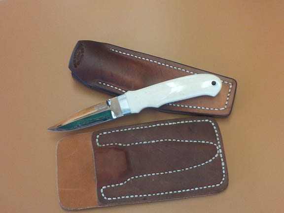

Bob Loveless also made some smaller knives that I personaly like a lot.
The first pic might fit in to your dagger-desire.
The second one should also look good in damascus. How about with white ivory or bone scales with domed brass(gold?) pins.........
