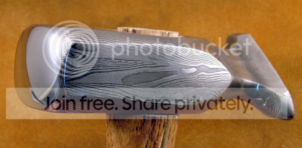

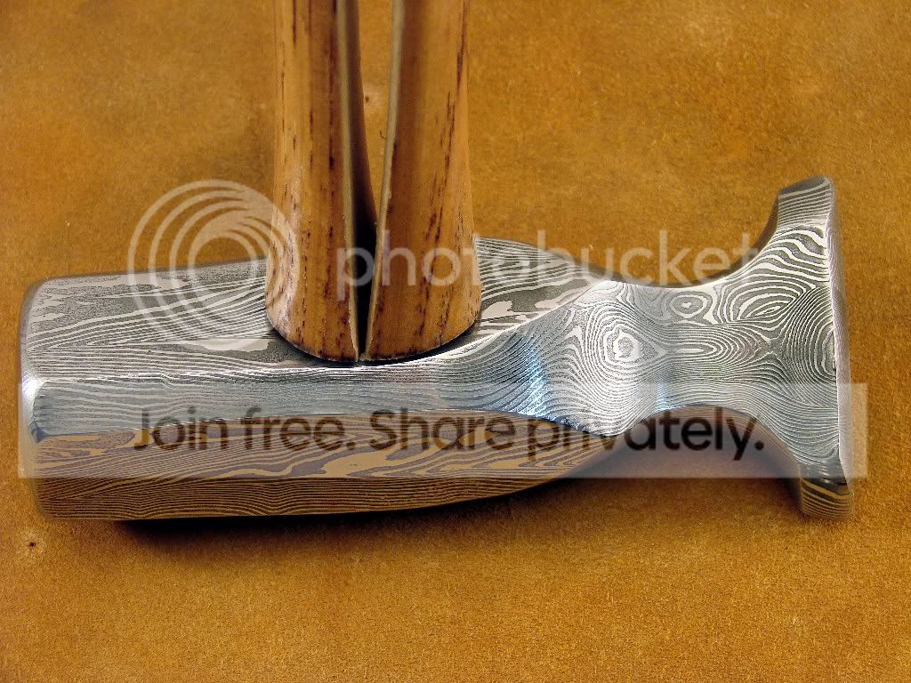

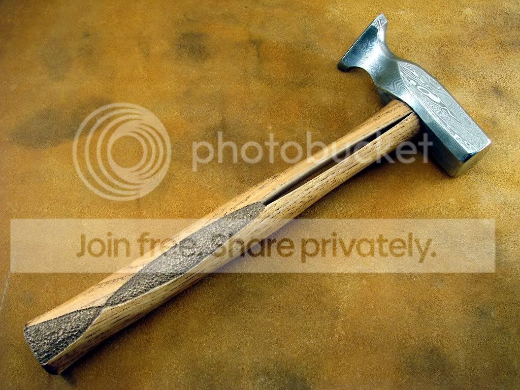

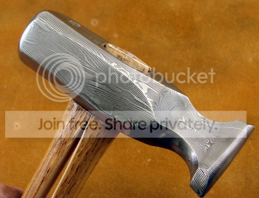

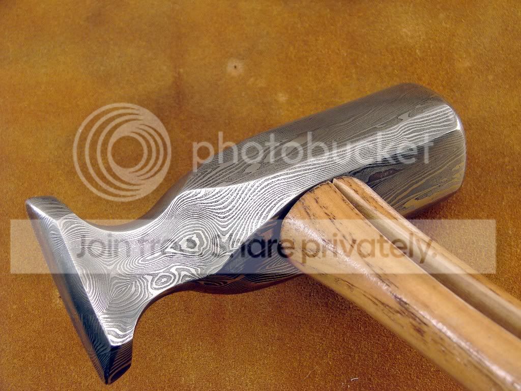

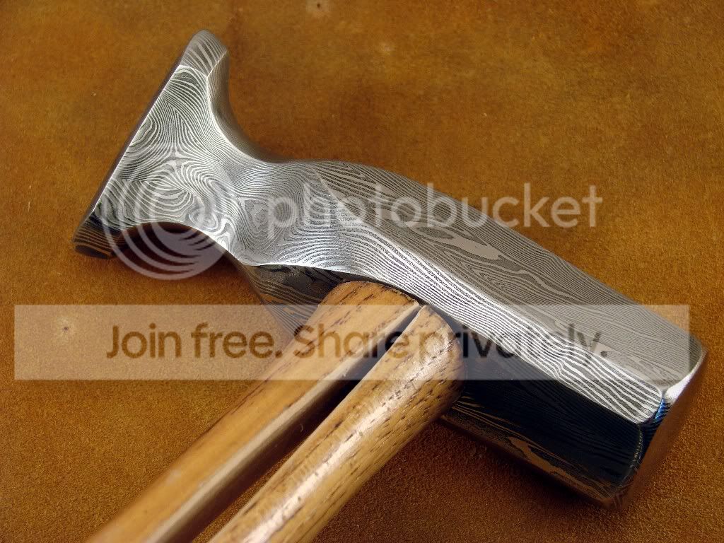

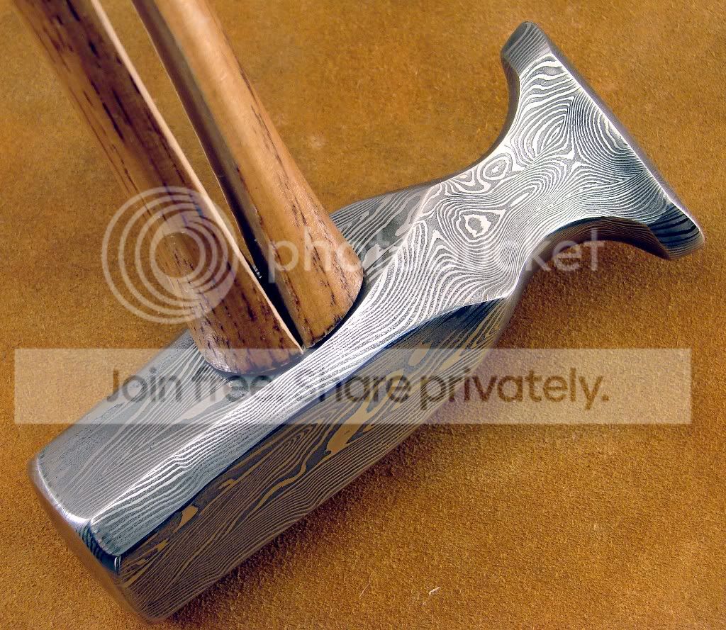

I've been toying around with an idea for a while now, and a couple of weeks ago I had a Damascus billet that wasn't going the way I wanted....so true to what I tell folks....I didn't make a mistake...but an opportunity to excel. I had a BIG twist billet that wasn't coming out like I wanted, so I decided that it was time to make some Damascus Angle Peen Hammers!
Here's the first of 3 that I got out of the resulting billet....

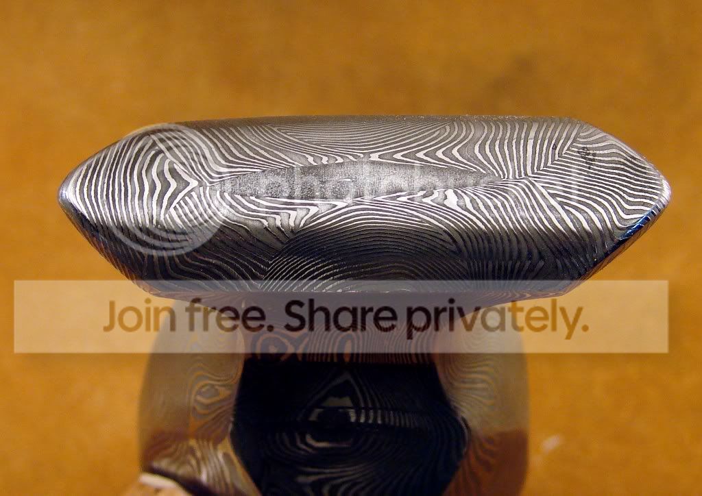

As it turned out, I made 8 big bars of twist, low layer count, and twisted 4 clockwise, and 4 counter-clockwise. I made the overall billet by 9-waying, and since I only had 8 bars of twist, I used a piece of 1080 and placed it at the center/core to complete the billet. (thats the plain steel you see in the peen end photo) Before welding it up, it weighed in at 22lbs, and was 4"x4"X8". I welding it up, drew it out to 1 1/2" square, annealed it, and then built hammers out of it.
Now I personally think that this is something that every respectable Bladesmith NEEDS! :lol
I already have a hammer of my own, made from "Fossil Damascus", but I couldn't help but make myself another small "Double Jack" out of part of this billet. I'm gona put this one, as well as the next one up for sale, and if they don't sell, will likely take them to the Blade Show and see what happens. By the way, it's a 2.5lb right handed angle peen, with my standard split hickory handle....and a touch of carving/texturing. It's been fully heat treated, and is a completely usable forging hammer.

Ed... I've never seen a hammer handle "relieved" like that before. What is the purpose? extra rebound/spring? what?

If you don't mind me asking? How do you do the texturing on the handle?
Many years ago, Wayne Goddard showed me, and suggested that I try "splitting" my hammer handles like that. What I have found is that it absorbs much of the shock, that would otherwise go up my arm, it also adds a bit of "snap" to each blow, making the hammer hit as if where heavier than it is. One final benefit that I have noticed over the years is that I almost never break a hammer handle if it's split like that.
The texturing on the handle was accomplished with a GRS rotary tool...it's a 400,000 rpm air grinder, that uses 1/16" shank burrs. Where a dremel will grab and sometimes skip because of the torque, you can literally write your name with this tool, in just about any material (depending on the burr you use) without any grabbing or skipping. I use a colored pencil to draw what I want to carve/texture, then outline it with a round burr, then do the texturing as individual "touches" with a small round burr.
