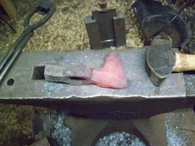

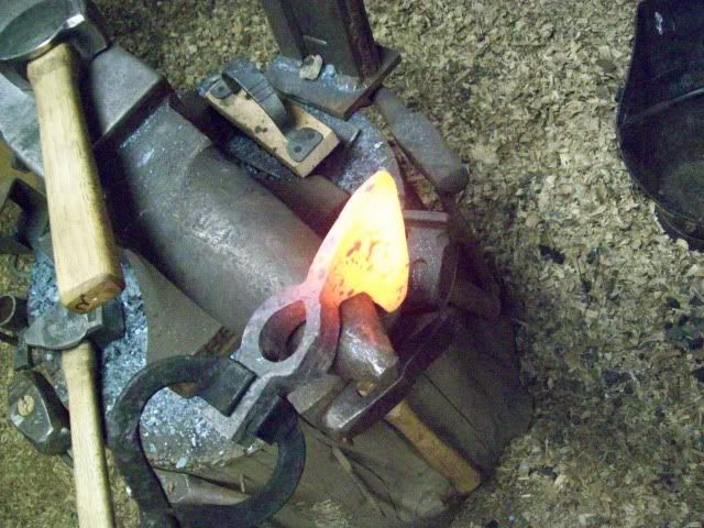

We took pics for the customer of the process. Just thought we would post them..This is going to be a bearded, polled bag axe..Used mostly for hunt'n chore's..The body is 1045 and the cutting bit will be 1095fg..You'll notice in the pics everything is done by hand..I always liked doing it that way but to be honest we dont have a mill or a lathe or a power hammer so we dont have a choice anyway :p We'd use them if we did but we dont :grumpy:

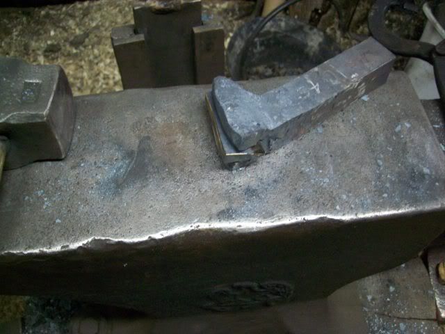

Here is the first welding pass..We do two-three passes..
Here we use a spring fuller to fuller the blade between where the eye will be and the rest of the blade..Just makes it easier to control the blade forging.

Here we have a flat drift thru the eye to forge the ears on. Again here we use a spring fuller..Later when we drift it to shape we will fuller some more on the eye drfit.

Here its starting to be forged out..
Over the horn to set the blade profile..
The blade pretty muchs set and ready to clean up..We will forge the edge bevels in after the cutout is done so we can leave a forge finish..The blade has to be clean and level to do the cutout right..

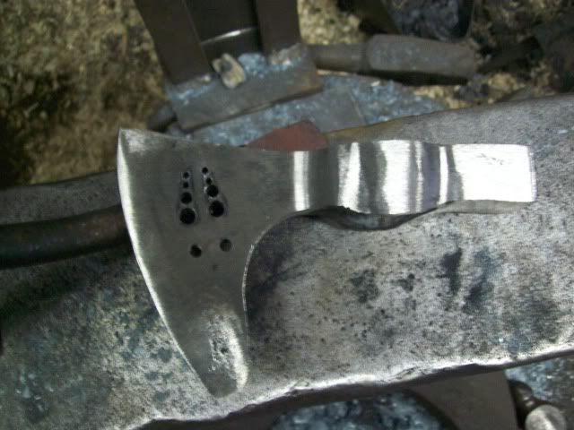

The head is cleaned up somewhat and the holes set for the cut out..In this case a deer track (buck of course) after this its all elbow grease and files..

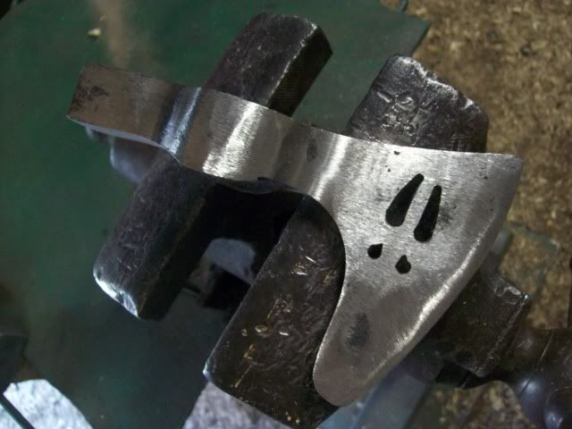

After a long time and sore elbow heres the deer track..

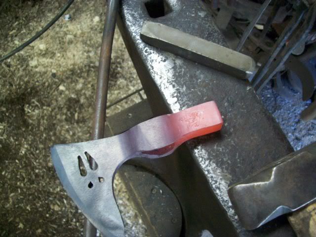

Stamping the poll...

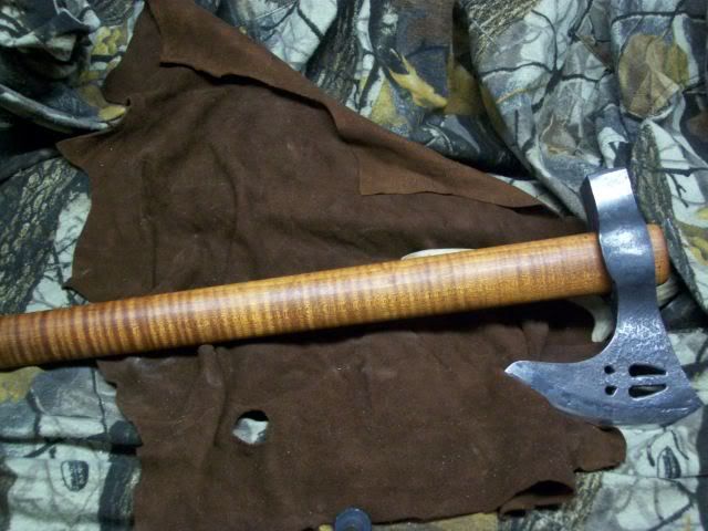

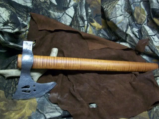

Well this is it..During heat treat we did forge the bevel and left a forge finish per request..It was edge hardened and tempered and the hammer poll was also heat treated like a regular hammer..
4 5/8" wide bearded cutting edge. Hair poppin sharp..
beautiful work, thats exactly the type of hawk i want. nice beard, cut out and hammer poll. how did you go about making the cut outs? suppose a guy can do it with out special gear?
sure man, all you need is a drill and files ;)
