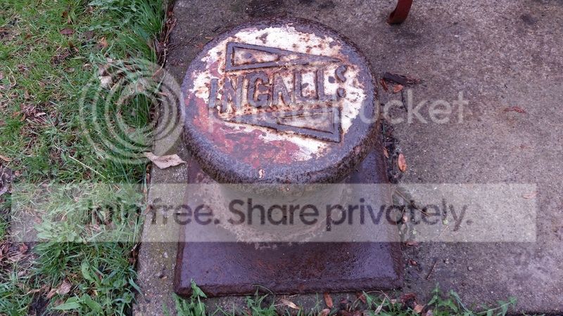

I came a across a posting for a DIY anvil made from a large ship dock cleat. The posting says ~100lbs. I'm assuming this is cast steel? I've asked for pictures, just wondering if anyone has come across this before? thanks,
Here is a picture I received, supposedly it came from a blacksmith who used it as an anvil? I can't tell how deep the lettering is, perhaps it can be milled flat.
The ones I have seen were solid.
Make a 24" high base from a oak log to mount it on. Grind the top flat and use it as a post anvil.
Am I the only one who thinks it looks cool and would keep it as is, just to look at?
It would make a cool drinks table out on the deck.

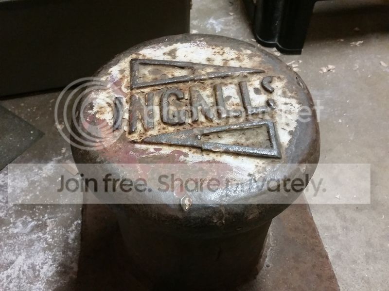

I can't imagine it got used much with those letters on the top. But it looks like there is a weld bead at the bottom, perhaps there's a flat plate there and it was used upside down?
So for a guy without any anvil to speak of, do you think it's worth 75 bucks?

Not a terrible price. You won't ever find an actual anvil for that price, or even a piece of 4140 or similar that would be suitable for a post anvil at that price.

I ended up buying it, I don't think it weighs anywhere near 100 lbs as it isn't solid. The bottom has a plate welded on so I can't see inside of it. I'd say it's more like 50 to 60 lbs, and a spark test did show that it is steel. The lettering is raised, before I thought it was inset, this will be easier to grind flat.
Do you think it's worth grinding the plate off the bottom and filling in the core with something?
Sent from my SM-G900V using Tapatalk
forgot to mention the size, it is larger than it looks. across the top it is about 10", the column is about 8" wide and the whole thing is about 10" tall.
if it were solid it would be close to 150 lbs.

If you are set on making an ASO out of it, just drill a 2" hole in the base with a hole saw and fill it with concrete.
