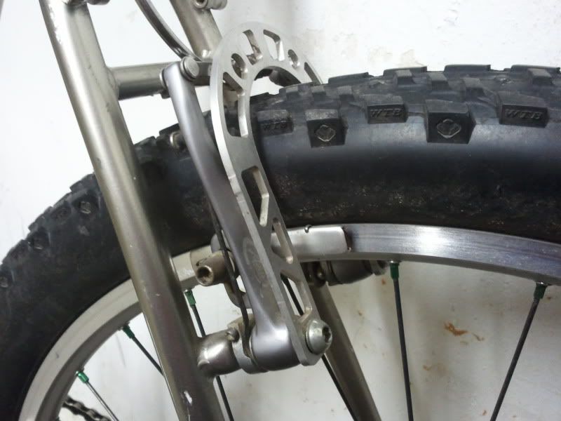

Fast my friend have another small issue brakes. These rims are completely new to me I've gone thru one set of pads already they were cheap one's replaced them with some good one's. Don't think that they will last another week obviously they are mounted wrong should they be on the flat side nearest to the tire or lower. Took a few close-up pics post them tomorrow. Really appreciate you help. Rich
I'll wait for pics to see exactly what the issue is.
-X
Heres some pics of the brakes in question first is the stock brakes the rest the replacements .
Pads need to be up on the flat, next to the tire. Also, the paint should come off the breaking surface, it needs to be bare aluminum. I'm rather surprised they build the bike with a fully painted rim and a brake. You cn ride it with painted rims, but braking may be reduced.
Here is an example on my single speed MTB. The brake pads are up as far as they can go.
-X
That's what I thought actually even close to the tires the rim isn't really flat mess with it when I get home tonight . Rode the Wheeler today thats how I have always mounted my brake pads these deep v Rims are throwing me off.
Yeah, that little groove is a wear indicator on the rim. The pad should be on that part of the rim.
Here is a pic of my geard road bike with semi deep-V rims (Mavic Ksyrium SL) and where the pad should be.
-Xander
Thank you sir I will fix them Thanks for quick reply and all the help they were mounted wrong to begin with.
