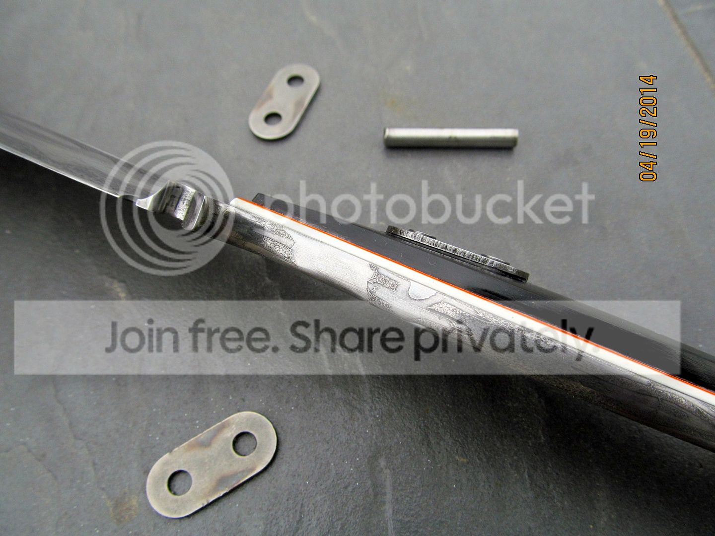

OK, its done. Thanks everybody for their input. This was a fun one.
Remember its a boot knife so to avoid a big thick heavy knife in the boot I opted to hollow grind one complete side on a 10" wheel and put only one scale on. The double edge is also hollow ground but on a 24" wheel. It looks nearly flat but its not. The liner material is white and orange plastic sign material and black G-10 scale. The chain is forged from a Duckworth primary chain so I thinned down and polished a plate from the chain and riveted it on as a shield.
Boot sheath to follow,
